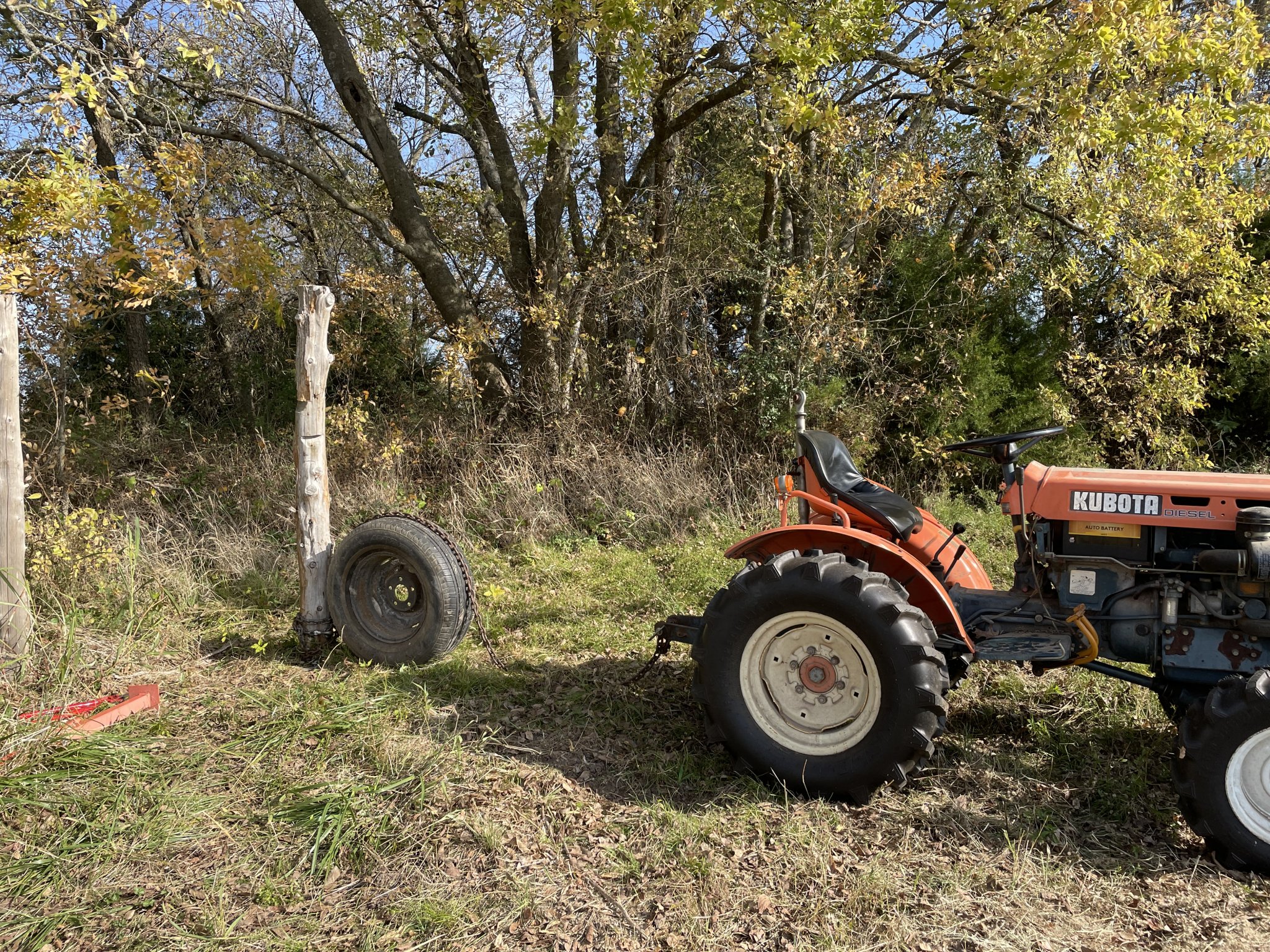

In my area I've never had a problem pulling t-posts. I have a manual post puller that works fine. Never felt the need to automate that. But these wooden posts are more of a challenge. Got several of the smaller ones done today but got stuck on the larger corner post. Made progress with the tire/rim method but will get back to it tomorrow. I was getting tired after going at it from different directions, different gears and was starting to make mistakes in tractor operation so best to quit and start fresh tomorrow. Thanks to everyone for their suggestions. IMG_1678.JPG
