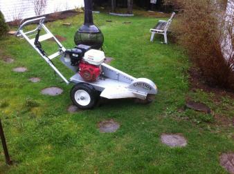

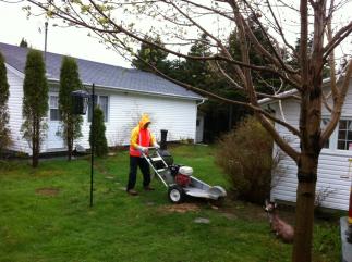

Last year I had to cut down 12 trees. They all were about as big as a two gallon bucket on the round. Then I had the stumps to deal with. I couldn't get a backhoe to them but I tried to dig them out by hand. Gave up on that pretty quick. Then I tried to burn them out. Gave up on the even quicker then I rented a stump grinder and that is the best inverting since the wheel. I one hour I had 12 stumps grinded down 12" below grade. What a great machine.

I rented a stump grinder :eek:
You rented something, and didnt build it:confused:
WOW,,;),, Seems this year I have a ton of little trees popping up every place in places I dont mow like on the hill next to the road and the knees wont let me in to fool around cuting them down,, and they have gotten a little big,, And forget about getting one of the kids to help they all have so many things to do,,lol,, and the stump grinder is really the catsazz I had 2 very large white pines (1 one was about 22 inches across the other about 24 and maybe 50 feet high) in front of the house knockem down and like you said an hour later nottin der but a hole and wood chunks..
Wildfire
WOW,,;)
Na. It was something I only needed once plus a buddy needed one as well so we split the cost. I think it cost us each $30. The best $30. I ever spent. By the time I had the 12 stumps grinded I was happy I was done :)
