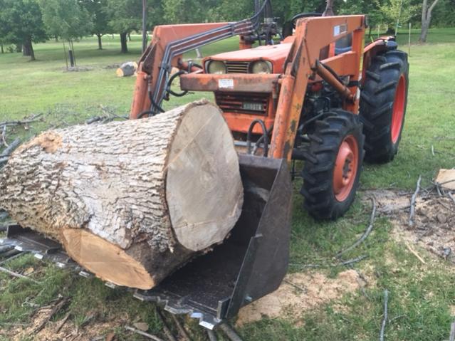

What kind of ballpark am I looking at for amount of straight pulling force in low gear on my 245dt. I was trying to help guide some trees with snatch blocks and had a synthetic winch line continuously break on me at one end. 3/16 Line is supposed to be rated for 3500lbs. Maybe it was just that joint but I wondered what the tractor could handle.

Dragging a stump like that is asking a lot.
Winch synthetic rope is great in the fact it wont kill you if it breaks. Thats it.
3400 rating is for a rolling load. Add an incline or a snagged stump and power requirements increase exponentially.

what? I wasn't dragging it. I had the pulley up on the tree to help guide/ convince it. Picture was just showing I got it down no problem.
