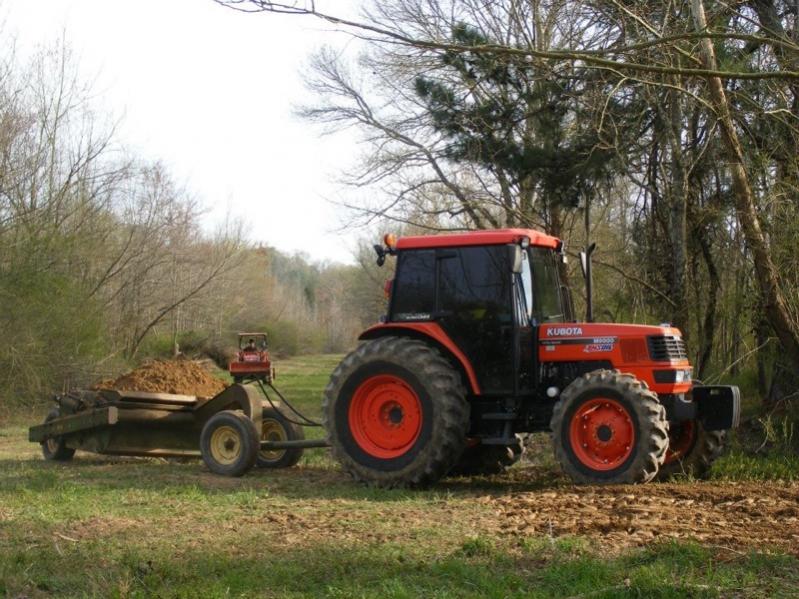

I used this one with our old IH 484 which was about 50 hp. Did okay in soft dirt, not so much in hard ground but no scraper is going to be very good in hard pack unless it's being pushed and/or the ground ripped.
