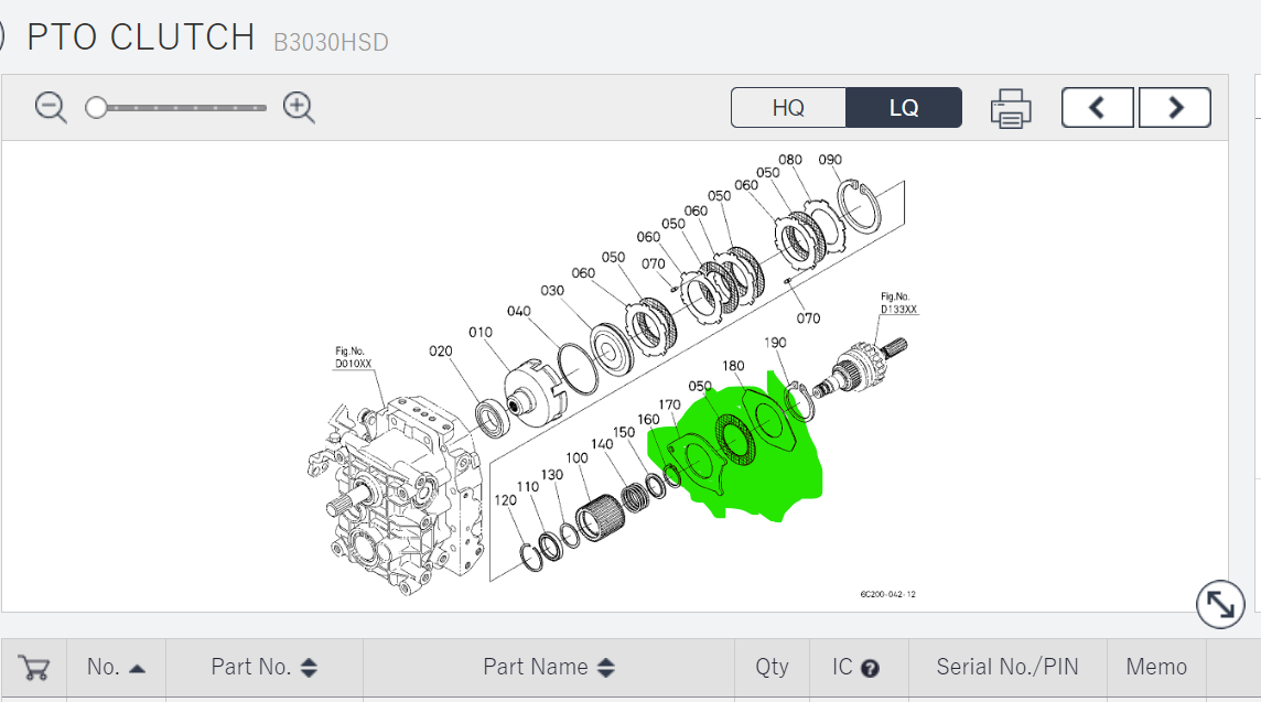

Thanks for the reply! I have another question. The lever that has the spin / not spin for the pto. Does it move anything internally or just operates the locks to keep pto in one position?Sound like you have an internal issue.
There is a brake disk in the clutch pack that stop the PTO from spining when disengaged.
Sounds like you have an issue with that.
If you can move the lever to change from Mid PTO to Rear PTO and the rear is not working then that too is an internal issue.
