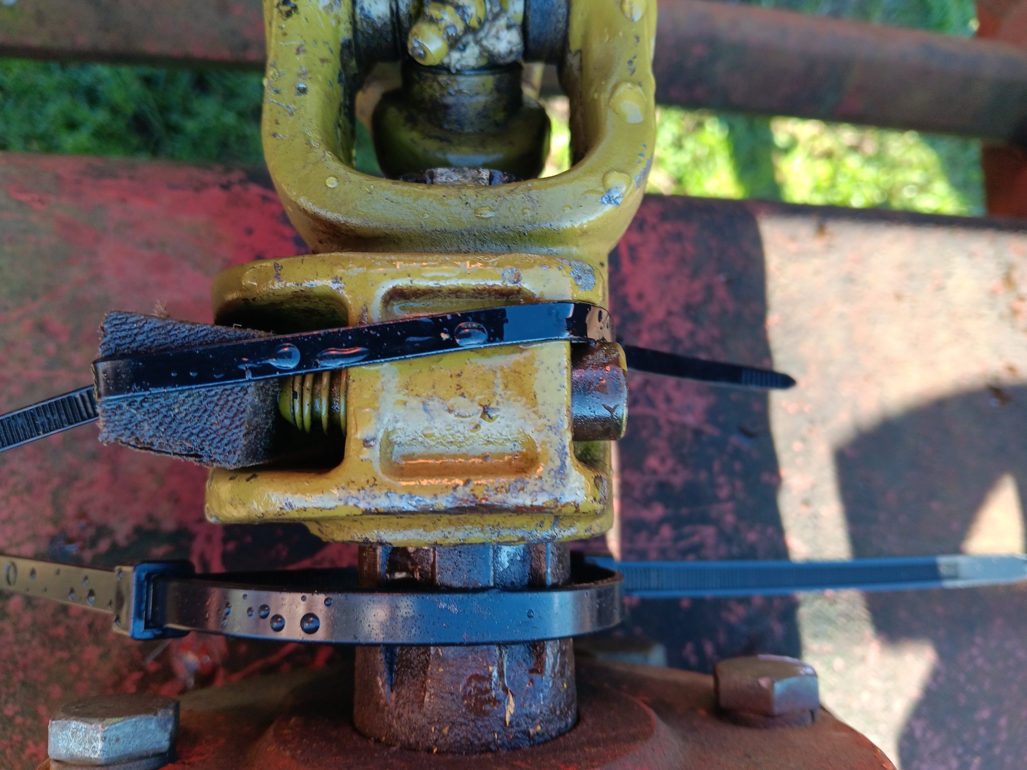

with a small block of wood and zip ties, i've lashed the keeper bolt to the open position so that I can use both hands to deal with the rest. no set screws.
My concern with using any sort of pulley system is that i've already put close to a 1000 pounds of pressure on the yoke with no results. So at some point if I keep pulling harder and harder - say with a pulley system, i could damage the gearbox
thats a great pic and I too would be worried about damage.... slow and steady this may take some time...... can you get the lock pin pushed in further to the point where it bottoms out?
lots of rust buster.... some counter clockwise twisting (can you block the tiller tines) and give the yolk a twist in opposite direction it normally runs.... a tap inwards versus pull to see if it break rust hold....twist the lock pin 180 degrees couldn't hurt either.

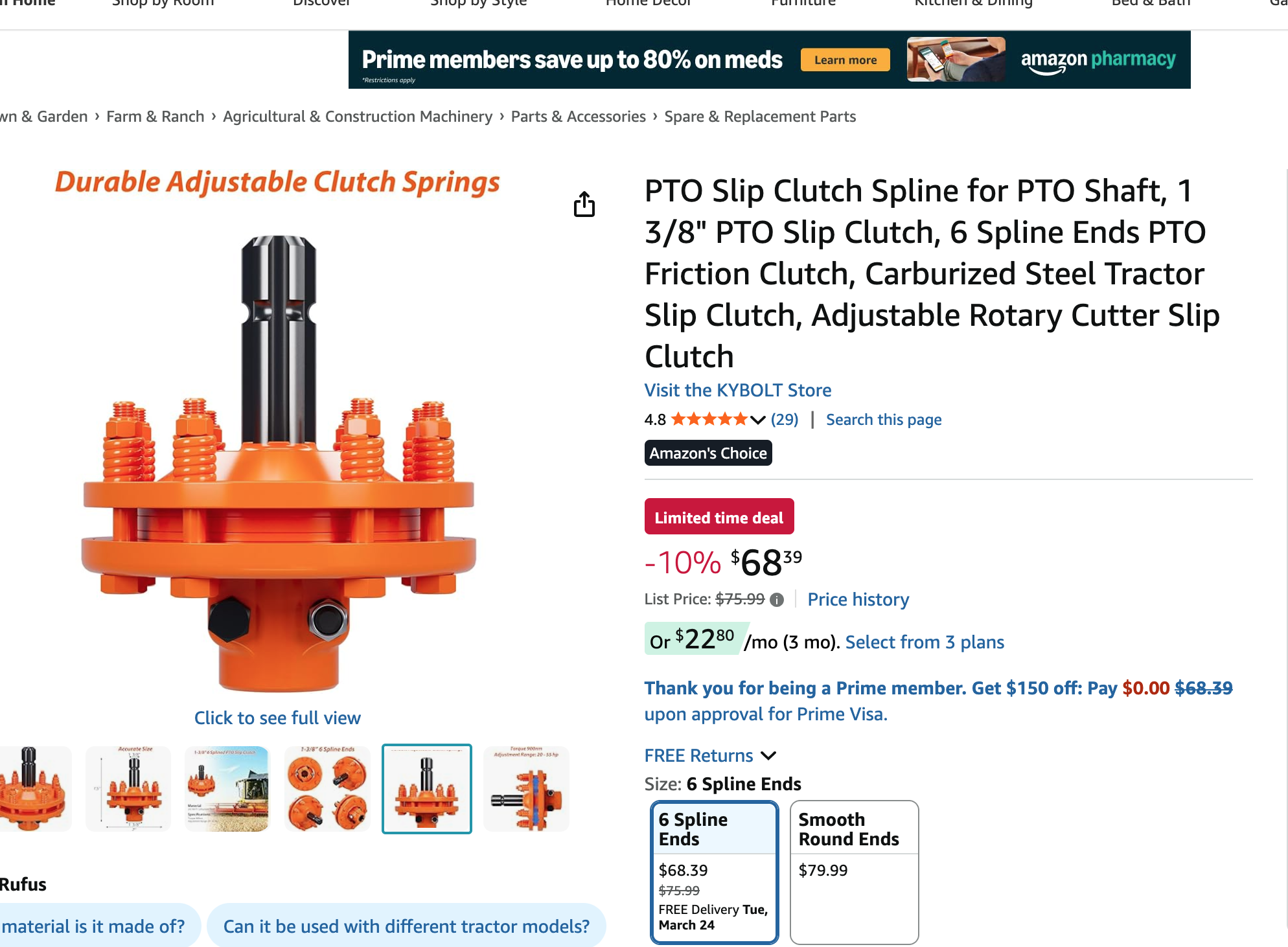

Here's a different approach. Below is a picture of a standalone PTO slip clutch. A couple of questions:
1 - could that go on the tractor end?
2 - this one is too wide, are there smaller ones, or something like this but with a shear bolt?
The advantage of this is that I could also use it with my ancient tedder.

yes, i think i could compress the lock pin a bit more..
sure as long as you have the clearance with the pto cover etc... from a safety perspective though if you need to make more clearance by removing the pto stub it be exposed.
for extra length you could use a stub extender and they run about $30 and add 6"
they also make sheer bolt clutches that are more compact than the friction plated ones. This pic has a yolk end attached but you can get them with splined stubs as well.
or an overrun clutch

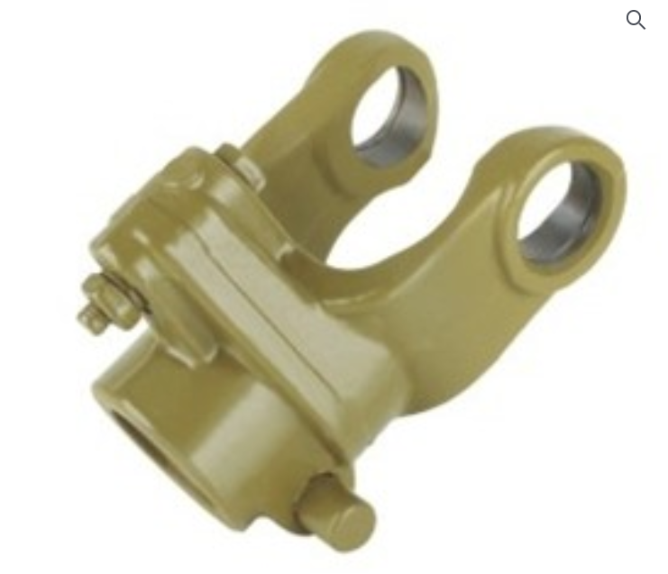

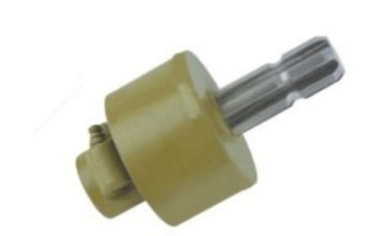

So i've found examples of your top picture for sale. and that would work for my current situation.
And I like the dimensions of the overrun clutch. That said, I don't completely understand the difference tween an overrun clutch and a slip clutch but i'm told they are not interchangeable?
My ideal solution would be:
- a standalone shear bolt clutch with a 6" diameter or smaller
- a slip clutch adapter like I showed above, but with a 6" diameter or smaller. All the ones i've found are 7" diameter.
Or I could make a bigger safety shield for the tractor.
My gut says that stacking a slip clutch adapter onto a shaft extended is just not strong / too many points of failure.
If I get a new PTO shaft with a shear pin, or just a yoke with a shear pin, it would work for the tiller but it would not work for my tedder. i've wanted to add pto protection to the tedder. it's pto shaft is much. much longer than all of my other shafts. even longer than my brush hog shaft.
