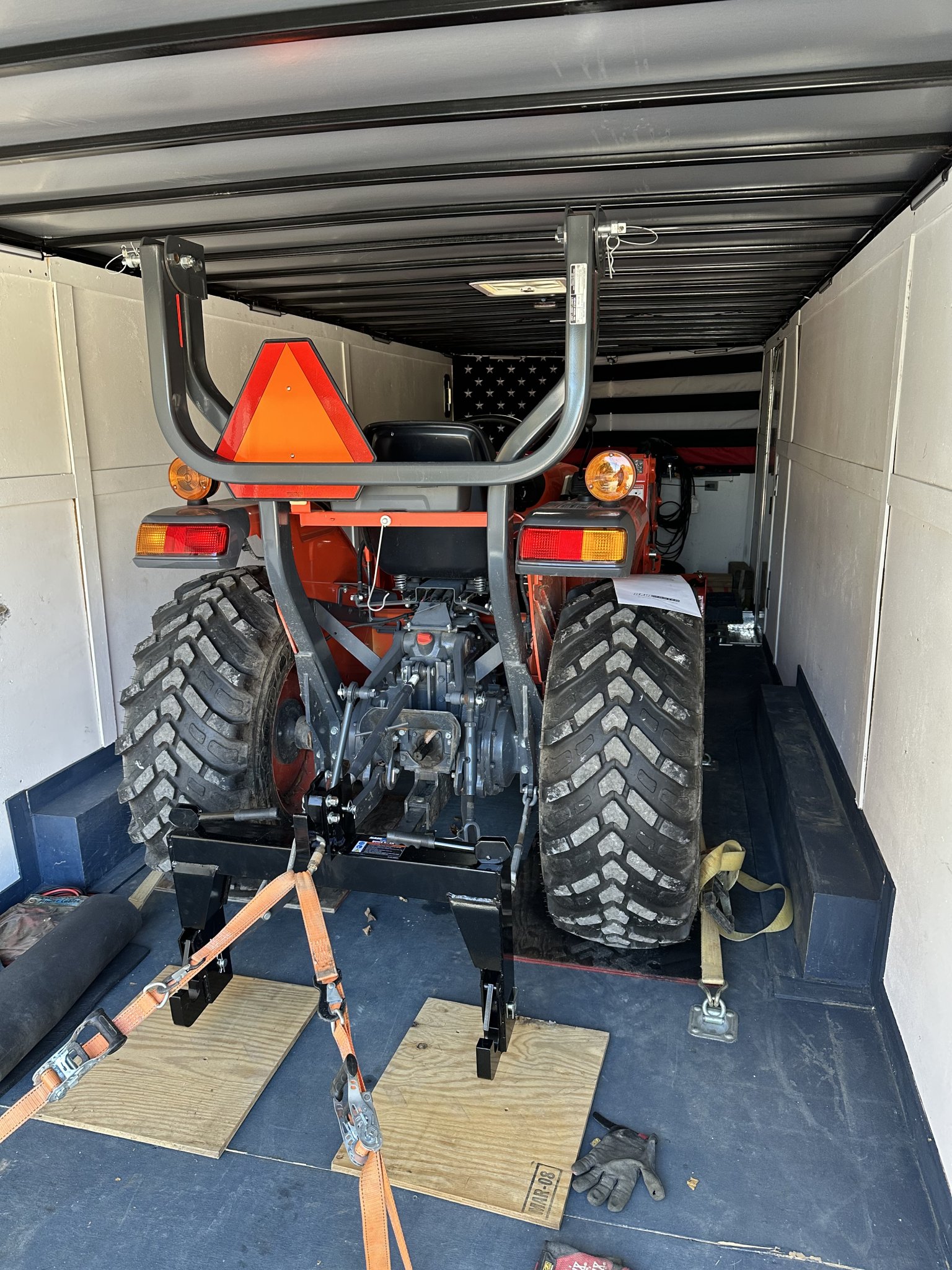

Hey there, New (to me) L2501 first tractor owner. I’m new to this forum and tried searching for the answer with out success. Any search hints would greatly help.
I have a 60 in landpride brushhog cutter in the photo and I just purchased a harbor freight quick release for the 3 point. I understand how the landpride shaft extends into the PTO, my question is about after I add the quick release to the 3 point.
Do I need to add an extension to the PTO shaft on the tractor side to cover the 3-4 inch width of the quick release ?
Thanks in advance.

No, IF the PTO shaft was/is the proper length...or was 'cut' to fit properly...there should be plenty of overlap in the PTO shaft to increase (or decrease) in length enough to accommodate the difference.
If in doubt, remove the PTO shaft and separate the two halves. You will quickly see the amount the one side fits into the other (likely 12"-18").

The PTO shaft length must be properly adjusted for the tractor and implement it is attached to and you are asking a good question.
If the PTO shaft length is too long it can damage the tractor or the implement.
If too short then the PTO shaft can twist itself off and damage a lot of things including you.
So the answer is that it depends on if the shaft has been adjusted correctly without the ”quick release” installed and doesn’t have enough overlap then you need to add the extension or replace or repair the shaft length.
Search the internet for something like “adjusting PTO shaft length for new implement“
or look at the manual for the brush hog

Thanks, Im pretty sure it wasn’t cut but I was wondering if the extra 3-4 inches would create a possible problem with not having enough bite. Appreciate your input. Thanks

The answer is . . . it depends. If you have 6-8" of shaft engagement with the cutter in the longest position (probably fully raised), you should be okay. More is better, to a point.

Mine was fine with the extra length, just make sure to check it!!! Pull the PTO apart, attach the tractor half and line the two shafts up side by side to measure over lap. Do NOT have the tractor on!
