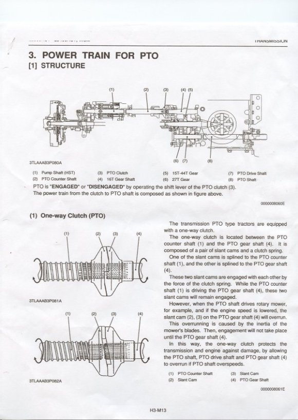

I could show you what the CAMS ratcheting and locking look like... see attached.

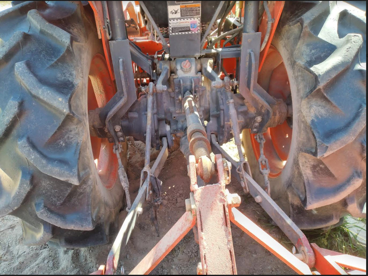

For location in my tractor; 2nd attachment.

So I don't know if this helps, but here is a photo of the PTO end of the tractor. As you can see, I have no external PTO clutch but I'll be looking for one soon.

So the overriding clutch protects the transmission in the event the implement RPM caused by inertia over runs the RPM of the transmission upon slowdown...so the new style (non-overrunning) clutch cam does not do the same...i.e. no transmission protection? As such, if I had these new cams installed, I would need an external clutch similar to the one in an earlier thread?
Also, I can understand how they work to protect overrun, but under a workload the cams do lock together. The cause of the clacking while under a workload would be caused by what? Worn cams, worn or broken springs, or ??

...The cause of the clacking while under a workload would be caused by what? Worn cams, worn or broken springs, or ??
Skipping, NOT locking together. So much force and it pushes past... So yea, possibly worn or not strong enough springs.
NOW, I don't know (exactly) is what type of CAMS you actually have... I've never seen (or heard) of your model tractor and you said that it's 2009/2010 - those same cams in my tractor (in USA) were around 2004-6 (early). They were phased out in early 2006 since they were failing. I'm surprised they were still running those in '09/'10.
