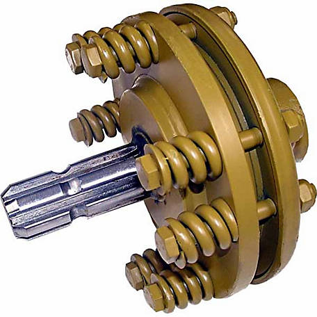

What kind of clutch(protection) do you have on the drive line?

Are you sure you’re not hearing the “clacking” from a combination of a slip-clutch activating and re-engaging?

I'm not sure what that means really. If by 'clutch' you mean the one in the main drivetrain..I can only say the movement of the tractor remains constant and steady but I do feel a sudden hit to the PTO engagement lever ...a jerking movement...ever time I hear the clacking sound while the PTO is engaged and the tiller is doing work. In other words, the tractor itself exhibits no pause or jerk that I can notice. When I raise the tiller up out of the soil so the tines are free-spinning, also there is no noise and no sudden jerking of the PTO engagement lever.

I'm not sure what that means really....
He's asking do you have this type of slip clutch, it's between the pto shaft and the gear box of the tiller (normally). All external to the tractor... it's on the implement side of life... :p

Maxx,
I was asking because of the different driveline protections available. The ratchet type, will make sound you describe. The one with the external springs tend to be quieter since they have a brake lining. Either way something is probably not right. If you post a picture of your setup (whole three point-pto driveline) someone might be able to better answer, since we will understand what driveline your using.
