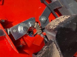

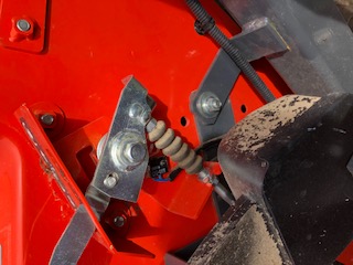

I have a Kubota LA525 with only about 54 hours on it. When I disengage the PTO lever, the cable is "bunching up" at the lever end, and so not disengaging. I'll attach some photos to show 1) at rest and disengaged, normal; 2) PTO engaged 3) what happens at the cable when I pull up the lever to disengage (and it's not).

My question is, what do I need to do to fix this? If the answer is lubrication, danged if I see how to get it to the cable, since it's enclosed in a rubber boot at both ends. If it's adjustment, could someone walk me through just how to do that, and how to know when I'm at the optimum adjustment?

Follow the cable to the other end and see if the lever it activates is bent or something causing it to be too stiff to move, or possibly there should be a spring on it to assist it to disengage. It might be that the cable is dry and needs lube, but I doubt it. Does there seem to be much resistance when you engage it?

No, I can move the lever at either end easily when it's "bunched up" like that, and disengage it. Thanks for the tip about the tractor model - I just went by the biggest number I could see from 100 ft away, LOL! It's an L2501

Spray the shaft that goes into the case with PB Blaster or other penetrating oil. WD-40 is not a good oil for this. Also you should be able to slide the boot out of the way enough to spray oil into the cable itself. Also oil the cable from the top side. You may need to remove the cable and use a pair of pliers to "work" the cable loose.

No, I can move the lever at the other end easily. Thanks for the tip about the tractor model - I just went by the biggest number I could see from 100 ft away, LOL!
No kinks or sharp bends in the cable? Is it possibly routed wrong? If the answer to both is no, then yeah you probably have some kind of friction problem inside the cable, either dry, or possibly frayed inside.
The rubber ends can be slid off the end of the cable jacket to allow you to add some lubricant. Try that, and if no improvement, it's time for a new cable. With only 54 hrs on it, depending on how long you have had it, it should still be under warranty.

One other thing to check is the spring on the lever arm at the transmission. Make sure it looks like the picture in post number 11 of this previous thread and bottom arm of spring is on bolt head BY CLICKING HERE

I'll do that, 69SS, and thanks. Well, it kinda worked - as long as I reached down and manually pushed the cable down into the sleeve. But damned if i want to do that everytime. It's especially tiresome when I'm using a tiller in an odd-shaped field, where I have to stop and go back to straighten up constantly. BTW, 69SS, I caught my first swarm a few days ago, and it was easy as pie. The were in a Crapemyrtle in a flat yard, about two 3 feet up the small bush. I stuck my Layens hive on the tailgate and backed up right to it. The top of the Layens box was even with the bottom of the swarm - one quick shake and they were right in there. I doubt I'll ever have it that easy again!

Had the exact same problem with my L3800. Clean out the debris between the lever and casing. Then hose down the lever and shaft with lubricant. Haven***8217;t had an issue since.

Motion Pro makes a dandy cable luber. I think they are on Amazon. You peel back the bellows, attach the luber, stick a spray can of PB in the end (with the straw) and it will lube the entire cable in a couple seconds.
I use it all the time.
