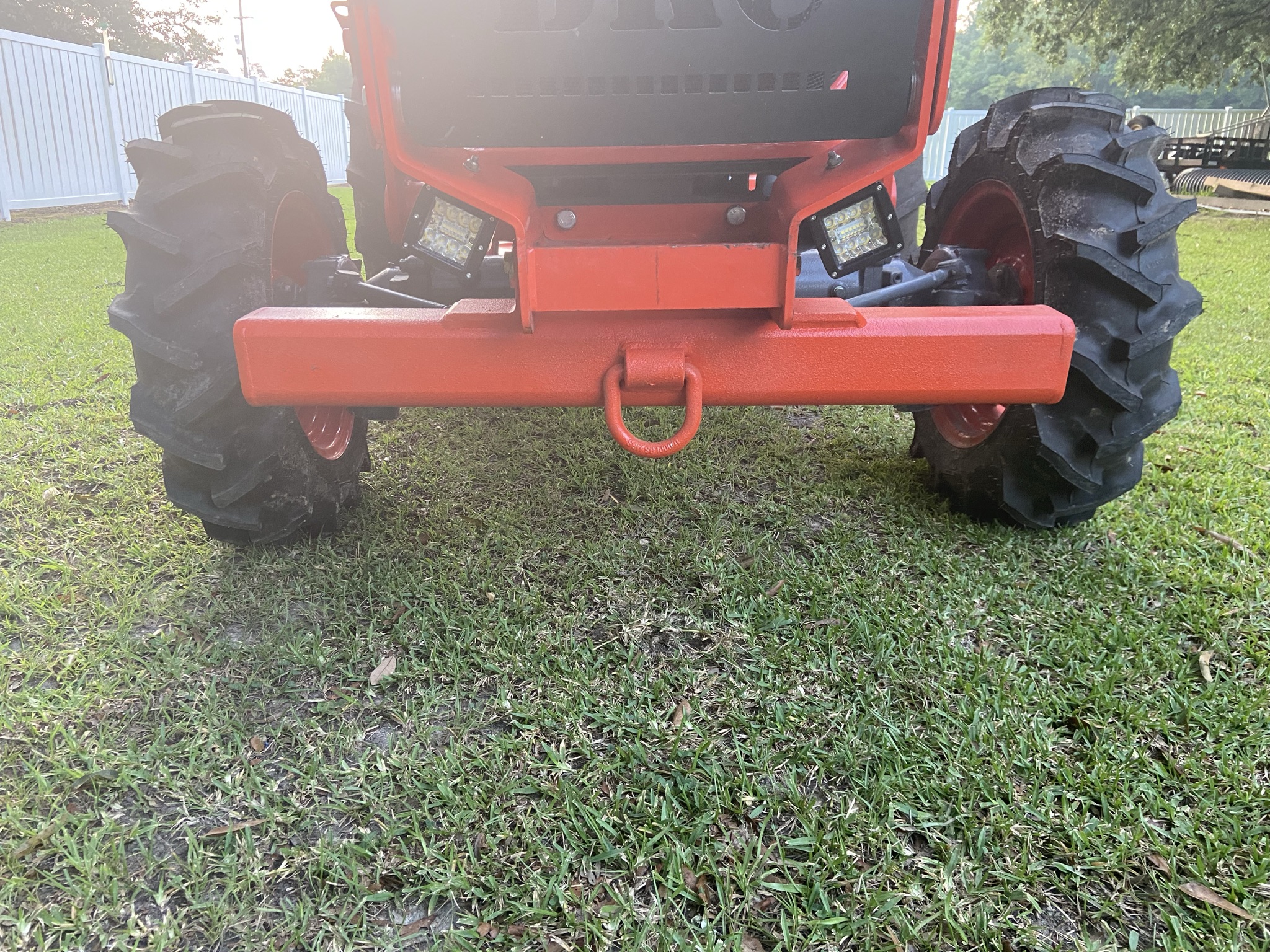

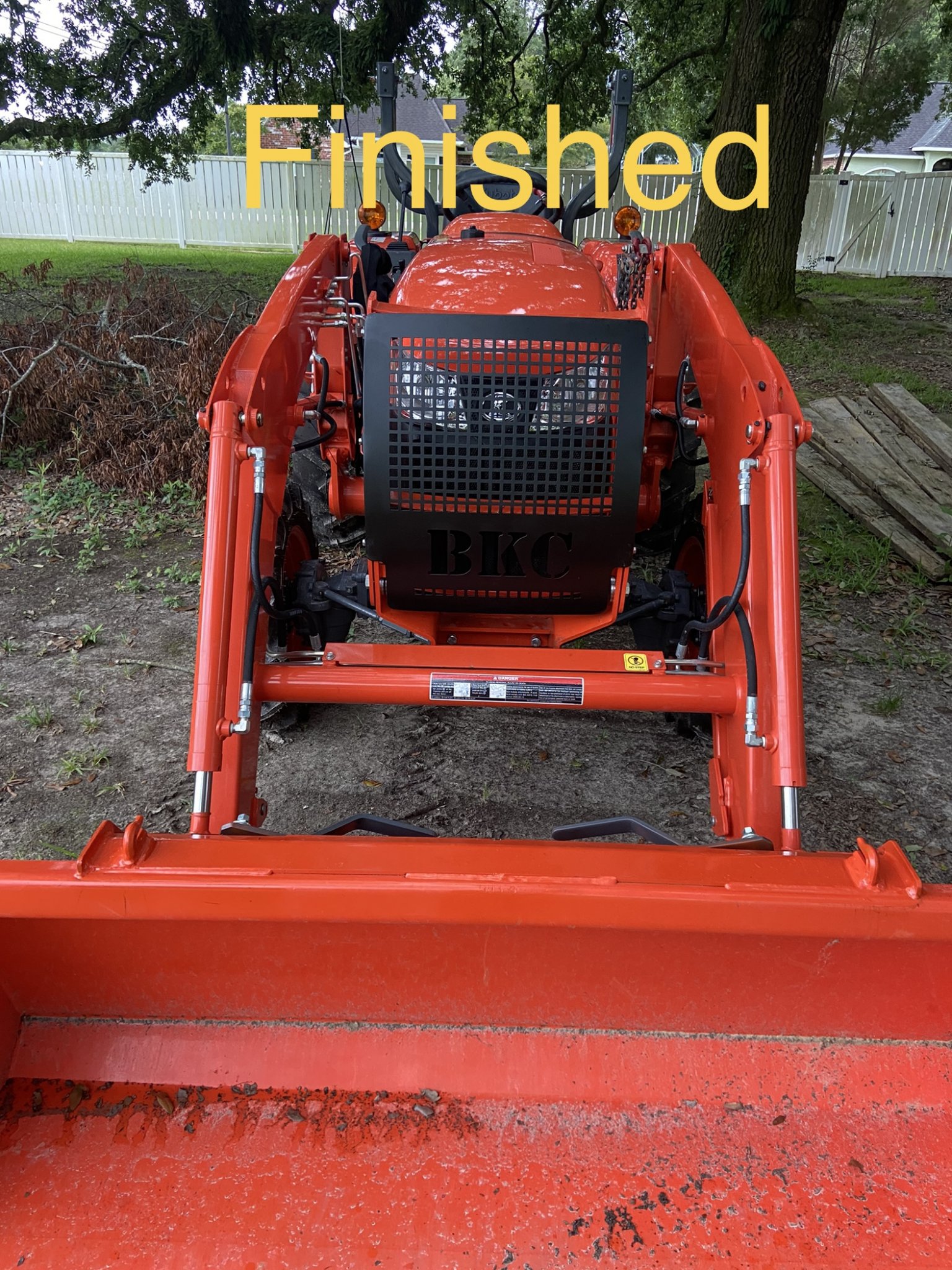

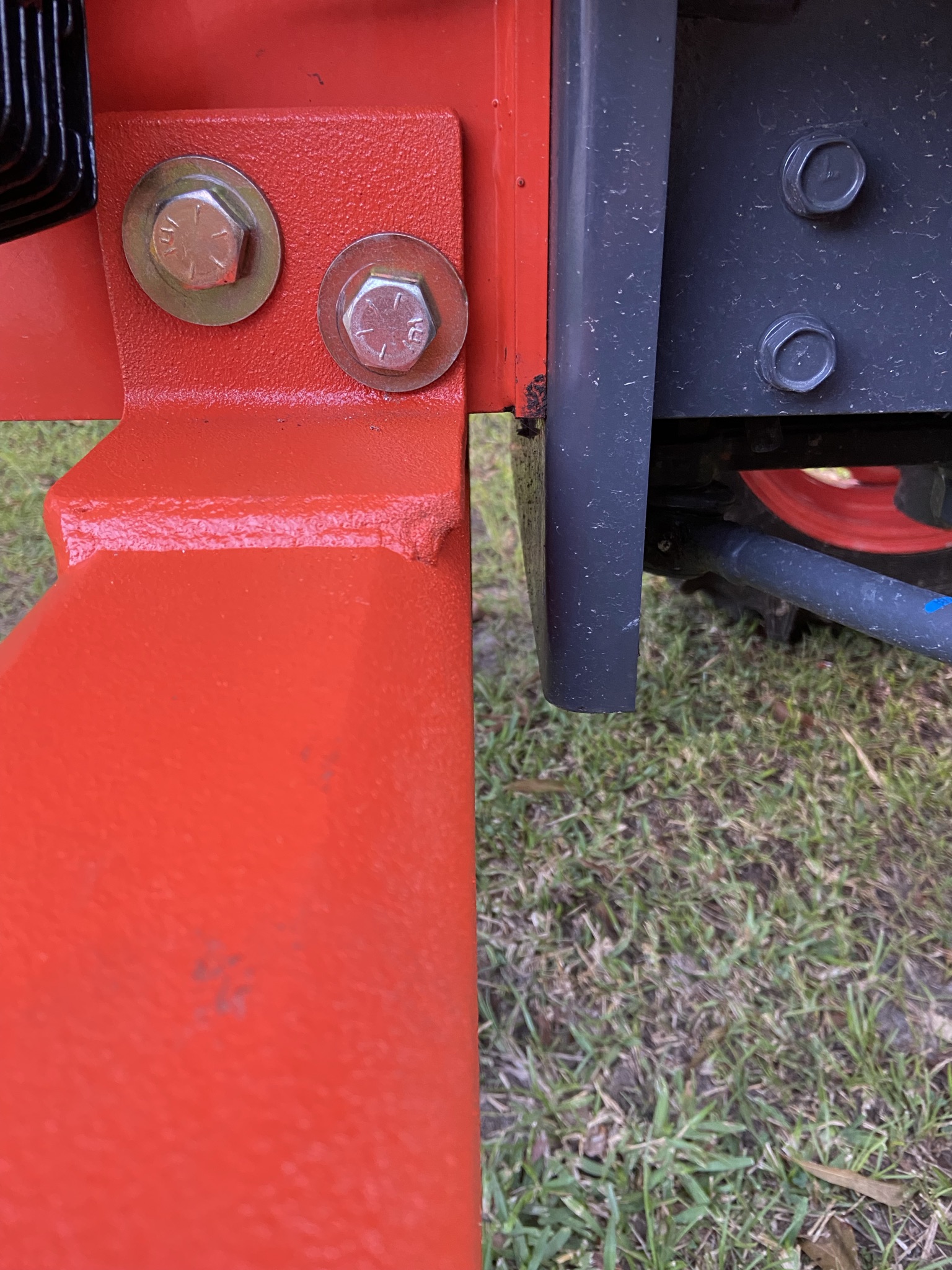

After working with my tractor a few times, I realized that I needed to add some protection for the tie rods and weight to the front end. Grill guard is 1/8 thick SS and powder coated. Bumper is 4x4 x 3/4 inch for a little extra weight. Added a D-ring for a tie down point.
