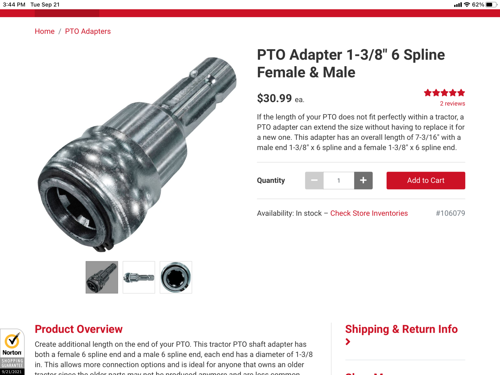

This is the extender I was looking at to move the PTO shaft back so attachment is more accessible.
