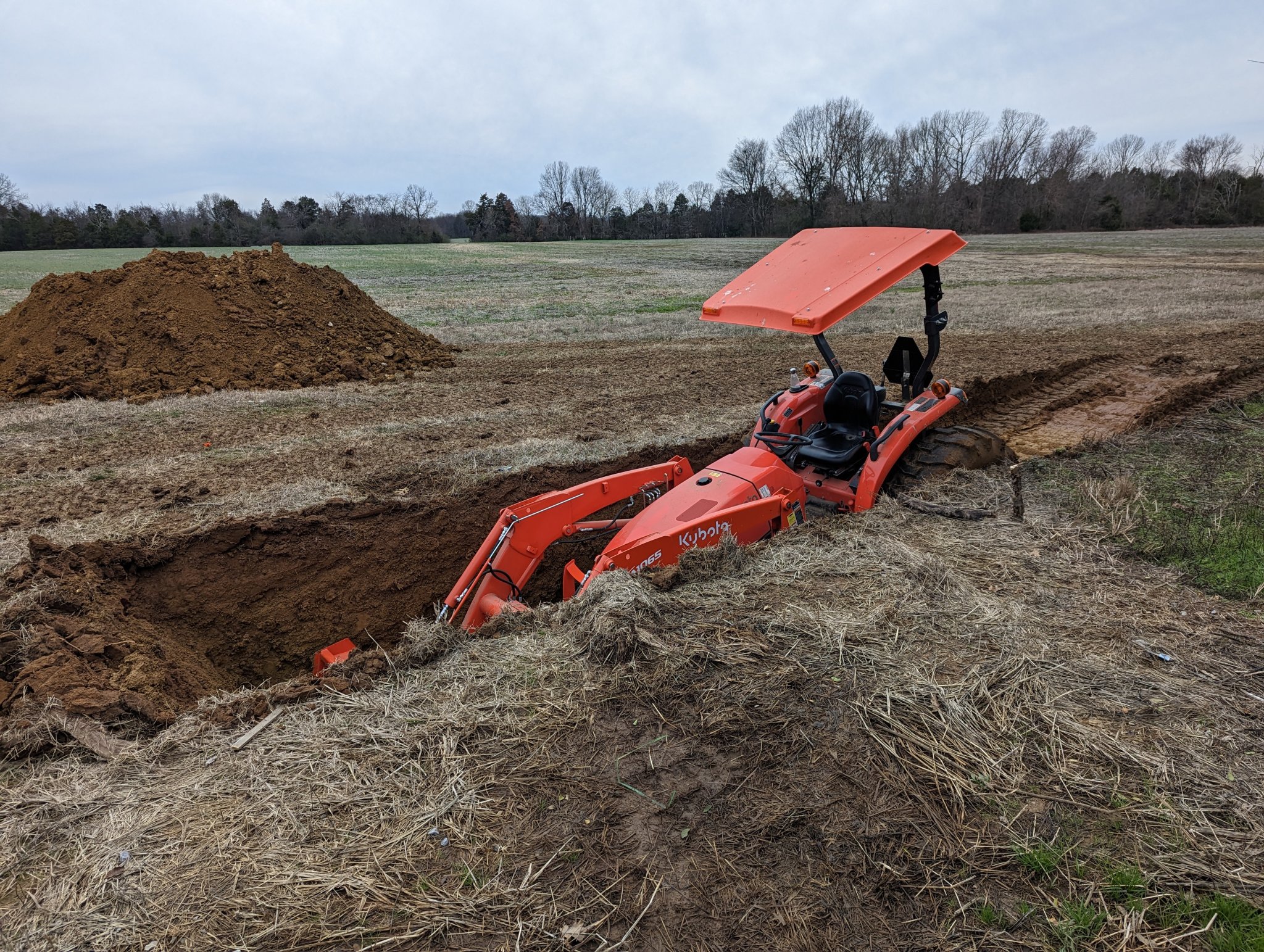

Hole complete. Hit solid rock at 4' 10". Needed to be 5' total but the installer said get a load of sand and we should be good.
Where the tractor go?

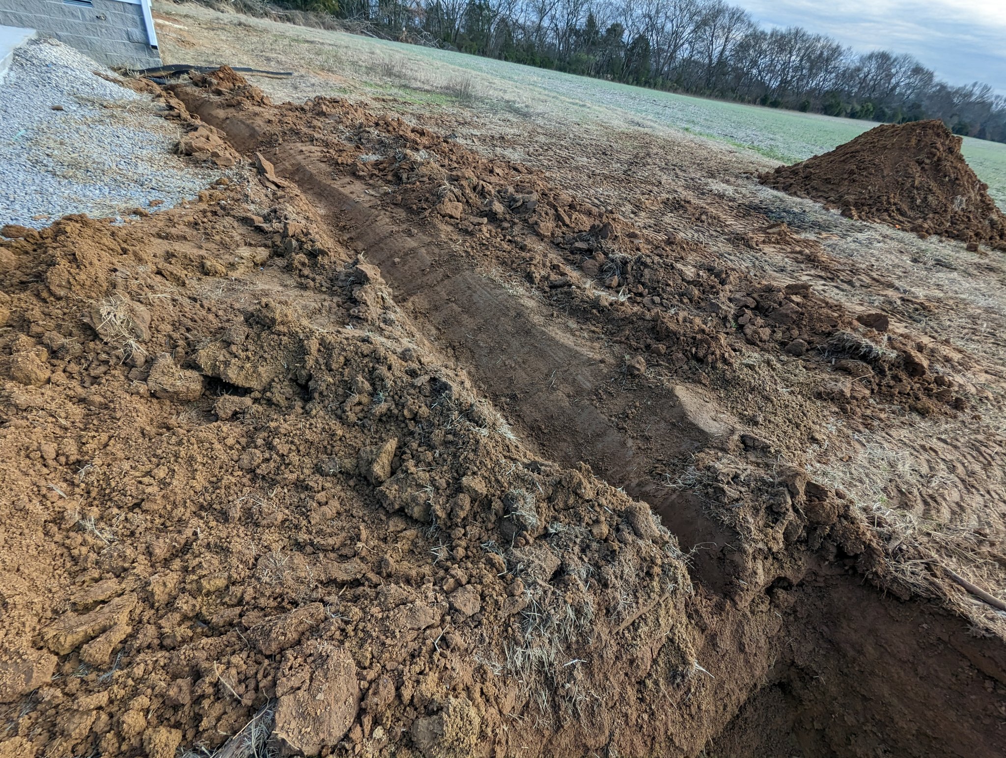

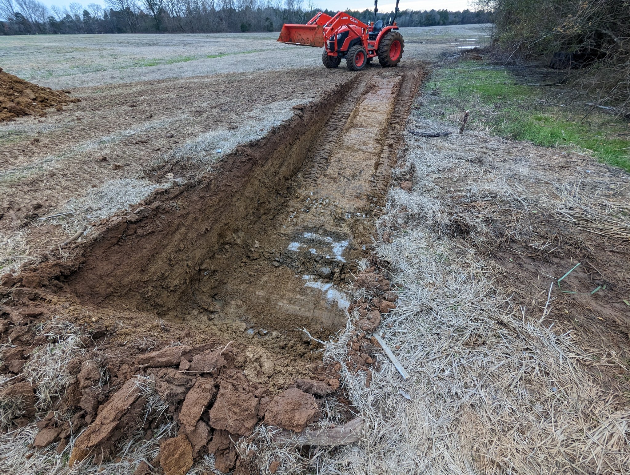

Trench

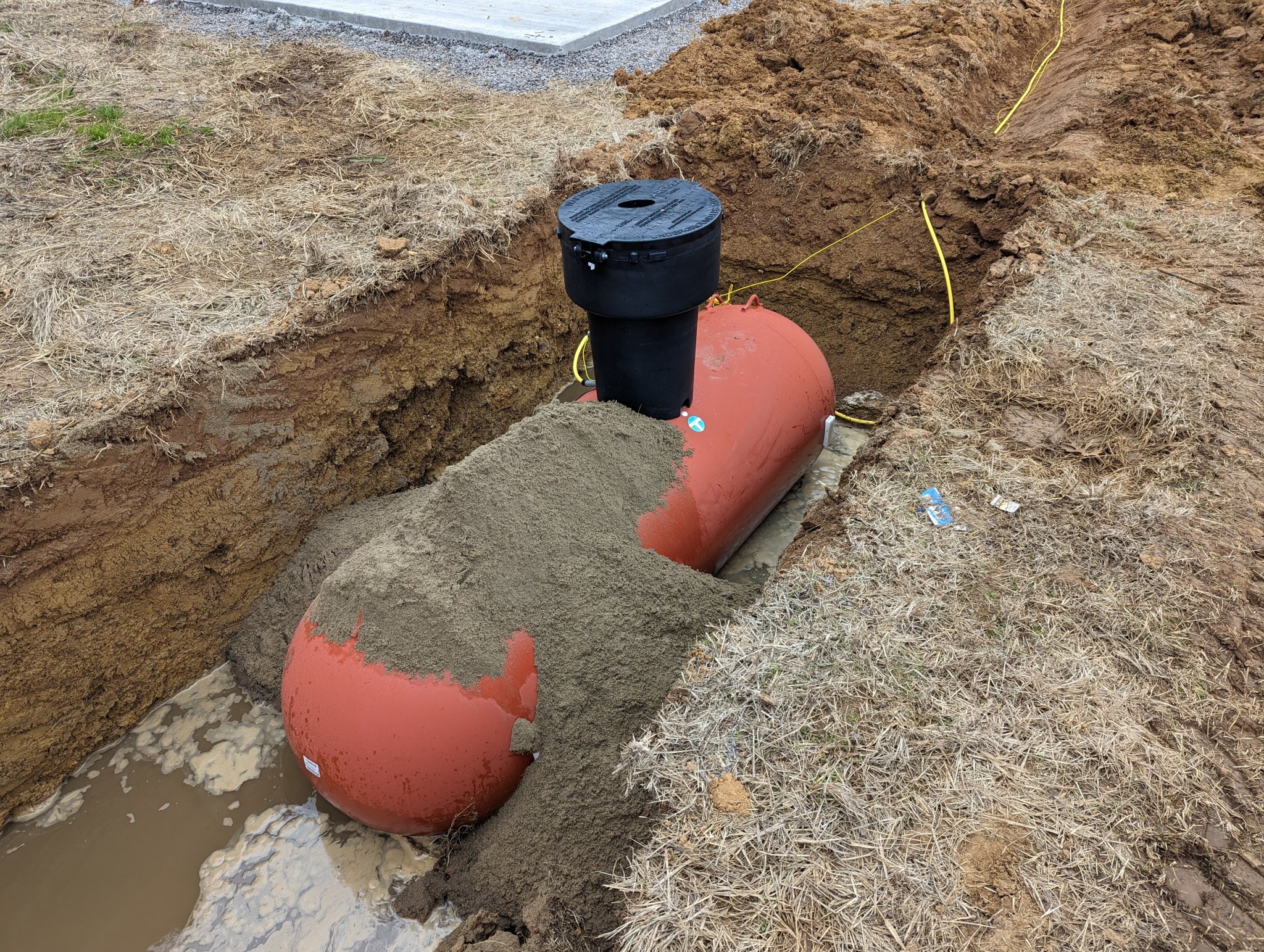

Tank in with some sand
All sand in

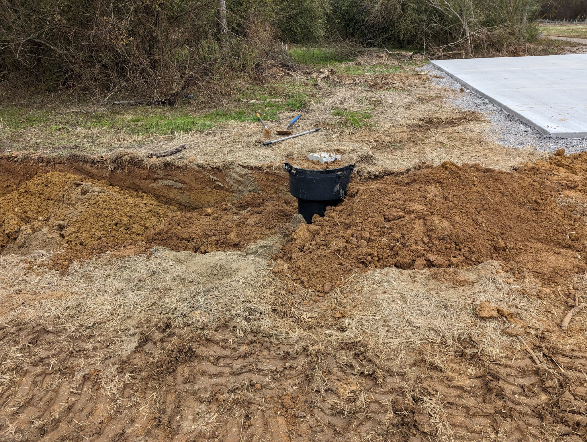

Mostly covered

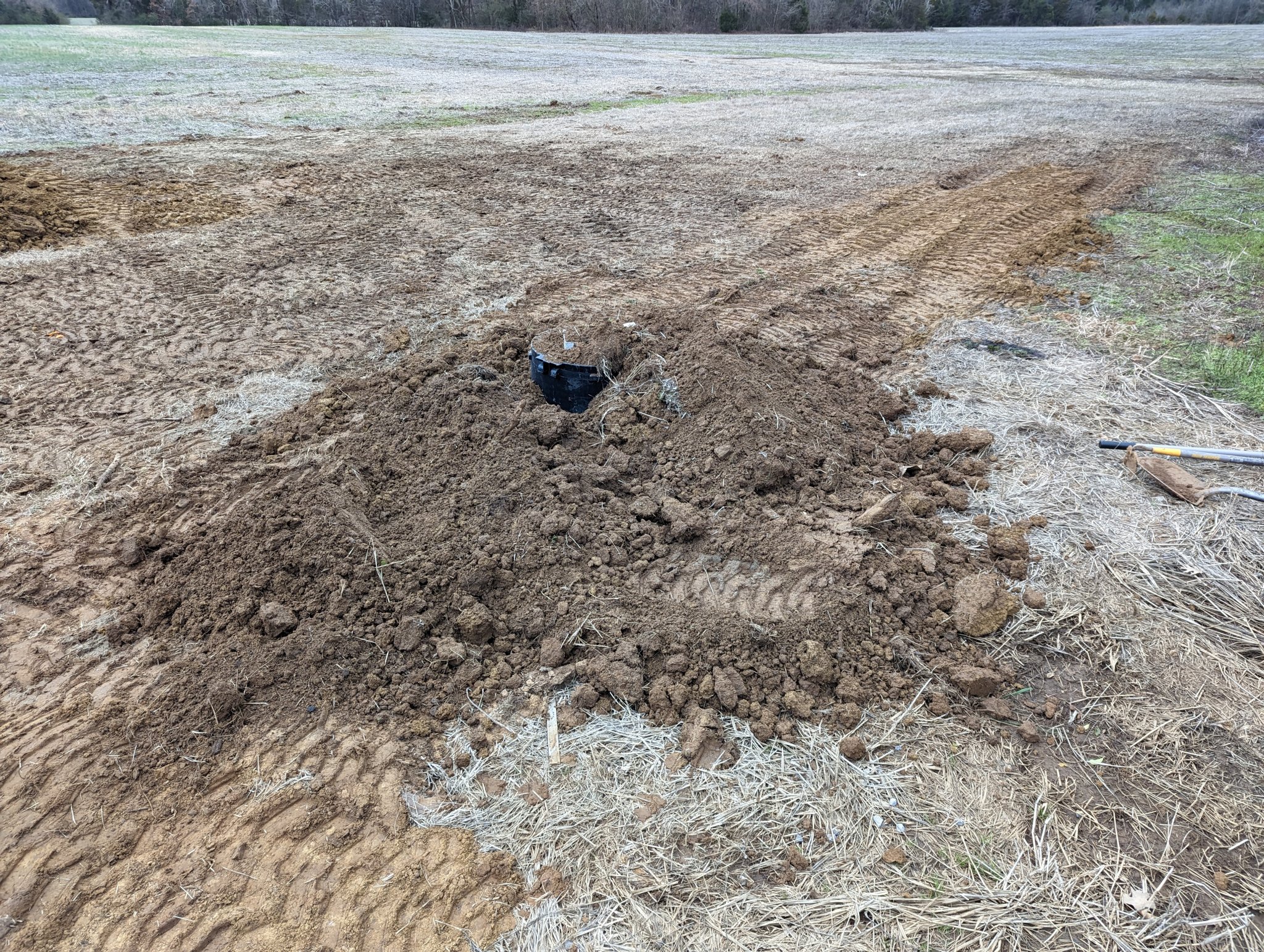

totally covered
