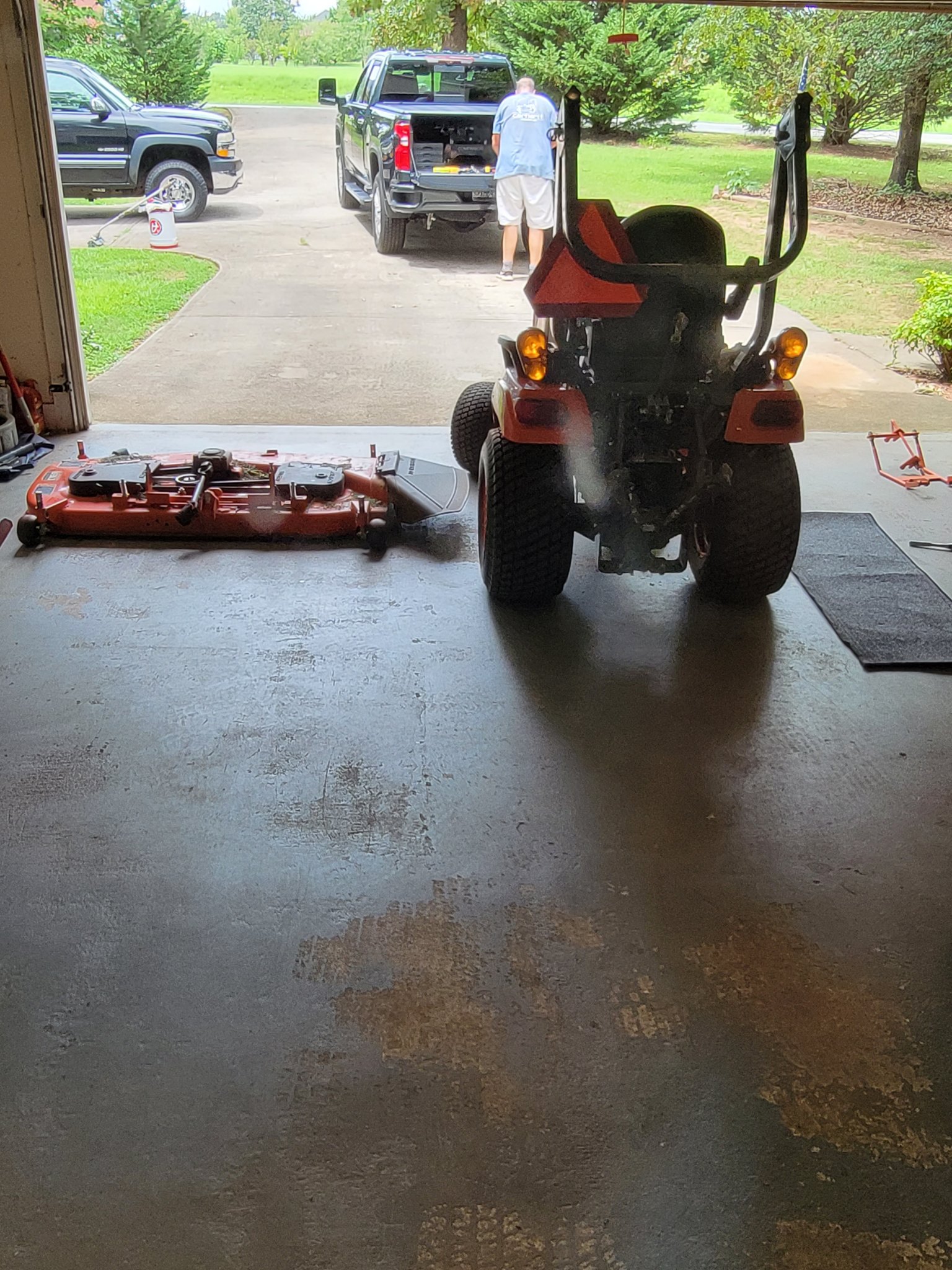

Okay, as my handle suggests, I am a clueless wife. I am also a wife ready to put her husband in an indefinite time out if he doesn't figure out this problem he is having with his BX2380 Kubota. It is 2 years old and has less than 50 hours on it. It is used strictly for cutting 2 acres of grass and used it to till the garden 3 times.
Last week, we got back from a 17 day vacation and the grass was unusually high. I think we had quite a bit of rain here in Georgia while we were gone. We hadn't even unloaded the truck and he was out there cutting it. He mowed down some dead green bean plants from our garden and the tractor bogged down. This should not have bogged down the tractor (in my opinion). It wouldn't stay running. Oil and filter had been changed right before we left on vacation. He checked the lines then changed the air filter and fuel filters and it still didn't work. I read a lot of posts here and suggested he buy some of that bioclean stuff for the gas tank. But yanno, I am a clueless wife so I knew nothing. After a few more hours of aggravation, he decided to buy it. Brought it home, dumped it in the tank and it worked!
Fast forward to this week. He went out to cut again and at some point one of the T̶P̶O̶(̶?̶)̶ PTO fell. Apparently something vibrated the nut loose and it fell to the ground. He doesn't know how long he was dragging it around. Well, not knowing it was dragging behind him, he put it in reverse which caused the arm to dig into the ground. It stalled out the tractor. Now, he can't keep it running. It just keeps shutting off.
While he was outside trying to figure it out, I called the place we bought it from. They wouldn't help me troubleshoot, just wanted me to make an appointment to get it in there...in a week and a half. She mentioned the TPO switch but what about it?
Ideas? Suggestions? Help? Please?

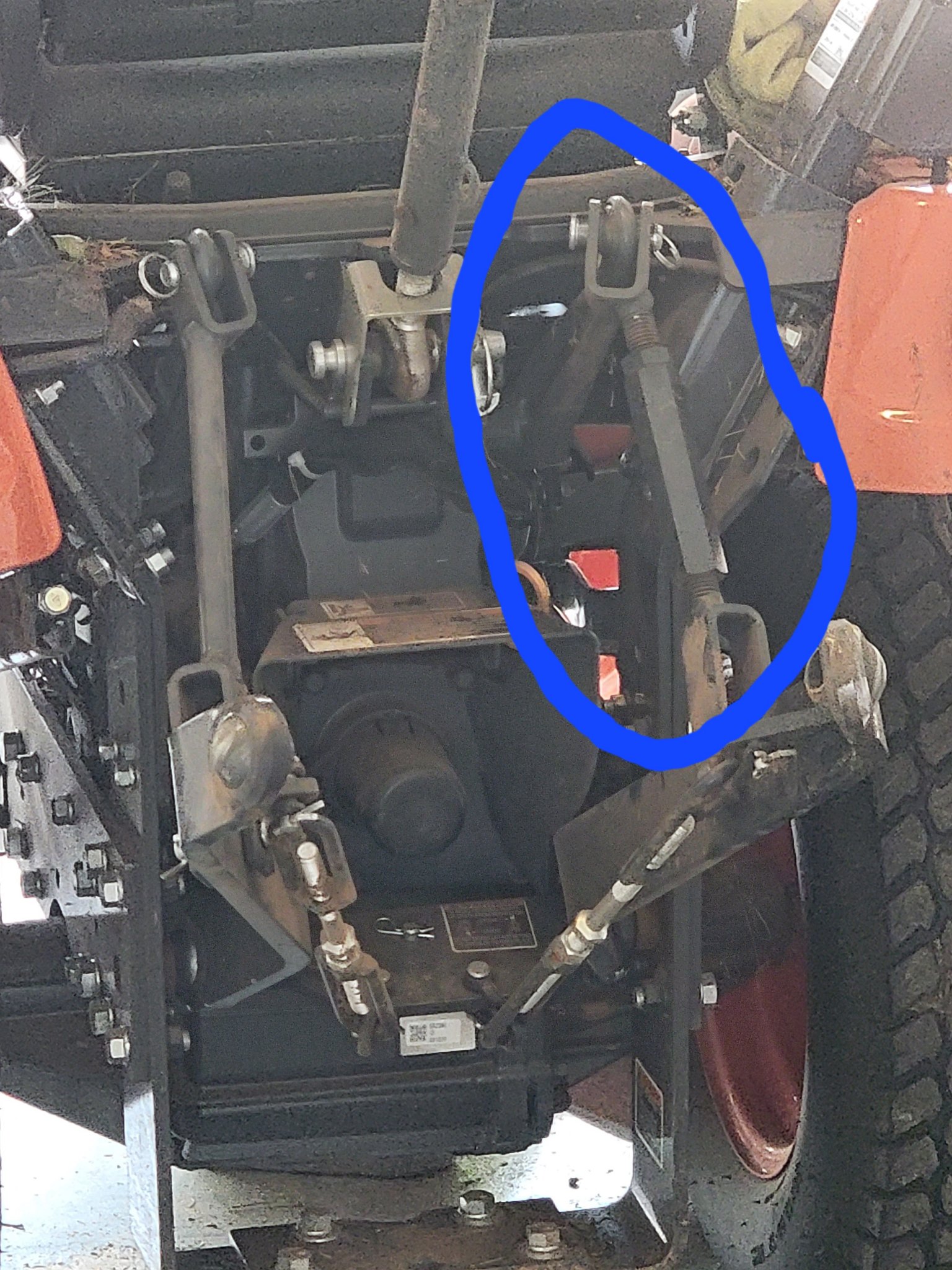

I reread your initial post. I think I see now..... I think it's a 3 point hitch arm that he backed up on, as something came off and let it go down. You can say "3 point hitch" or "3PH" but TPO is so close to PTO it had me confused.
I am willing to bet the non-running and bending/jamming the arm may not at all be related.

Oh boy....I think we have a failure to communicate.
This is the PTO (power take off). It's inside the red circle.(under the plastic cap)
It's used to power things via a short 2'-ish driveshaft like rear mowers, tillers, and the like.
You say he backed up on the 3 point arm (because it dropped) but you insist it's the PTO.
WHICH is it (please)

To answer your questions, it is the PTO and yes he has tried driving it with nothing engaged. Same issue.
What do you mean "it is the PTO" ? Because the thing you circled in blue in the picture you posted is part of the three point hitch, not the power take-off. I suggest you try writing without using the word "it"...seriously...it will make it a lot easier for us to help you.
Also, it's time to start learning what things do. PTO = power take-off, and is called that because it "takes power off the engine" and is used to power attachments (such as mowers). 3PH = three point hitch and is used to attach implements to the rear of the tractor. It's called a three point hitch because the implement is attached to the tractor in three locations. Rigidity of the connection is created because the linkages are fixed length and thus there is only one triangle that can be formed. This is the same principal that is used in trusses.
It isn't the red circle...I changed it because someone above said PTO. What came off causing the arm to fall is what I circled in blue.
The thing circled in blue.
