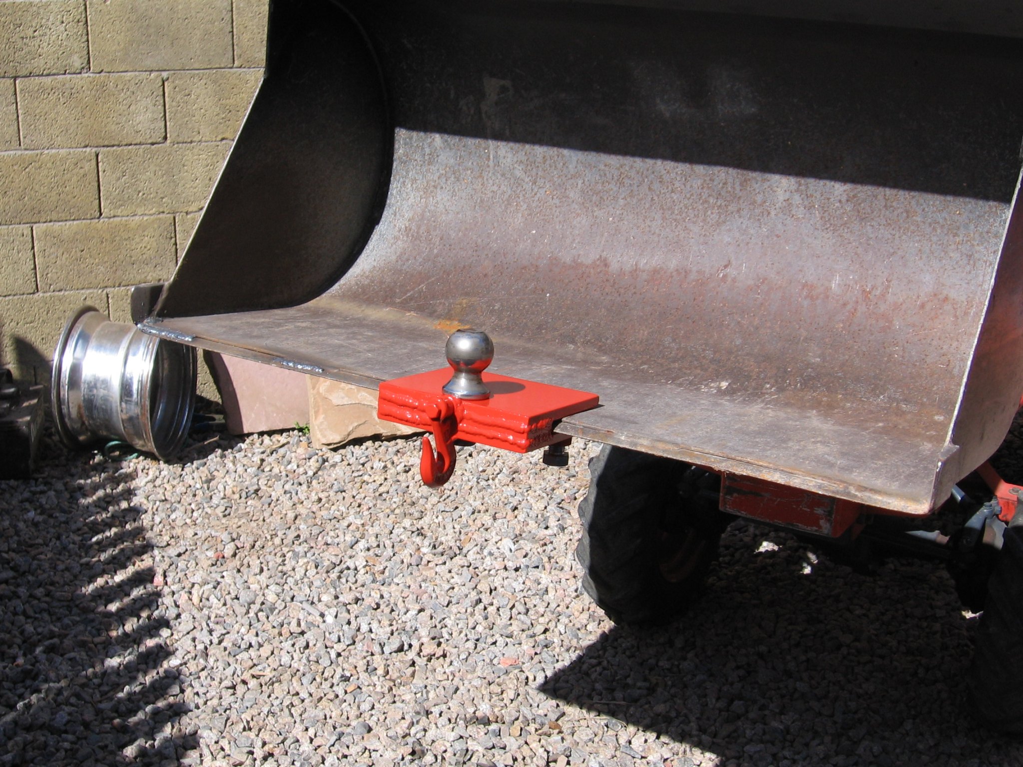

I regularly park my dump trailer in the garage (within plus or minus an inch) using my FEL hitch on the tractor, low range, 1st gear.
I can do it with the F350, but it is way easier with the tractor. Much better control & visibility.

Did you build or buy the clamp-on ball mount? Looks homemade but I figured I would ask.
I would like to have one, though I'd probably mount 2 different balls, a 2" and a 2-5/16" side-by-side for diversity.

Homemade, from stuff laying around the shop.
I thought about the option for quick change different size balls, but everything I own is 2".

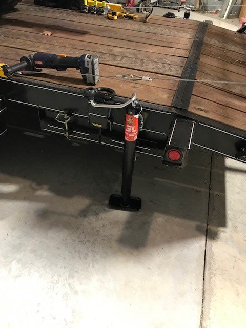

If I were doing this, I would probably have some weld on jacks with wheels at the back of the trailer and one on the tongue, if not one on each front corner. Back the trailer as close to linear position as possible, raise the trailer with the jacks, turn the wheels the direction the trailer needs to go and push into position.
This is what I do with my home made scissor lift.
The jacks on the back are extremely handy, if you don't have them. Just pull a pin and the jack comes off or can rotate 90. I haven't looked for this type of weld on with wheels, but I'm sure they are out there or could be fabbed pretty easily. Though, in this case, I would probably have two sets of jacks for the back. Don't know that I would want to load/unload with wheeled jacks. I love being able to load/unload without a tow vehicle attached.
I don't know that this is the best solution, but it would require less manual effort, and that is what I try to avoid!
