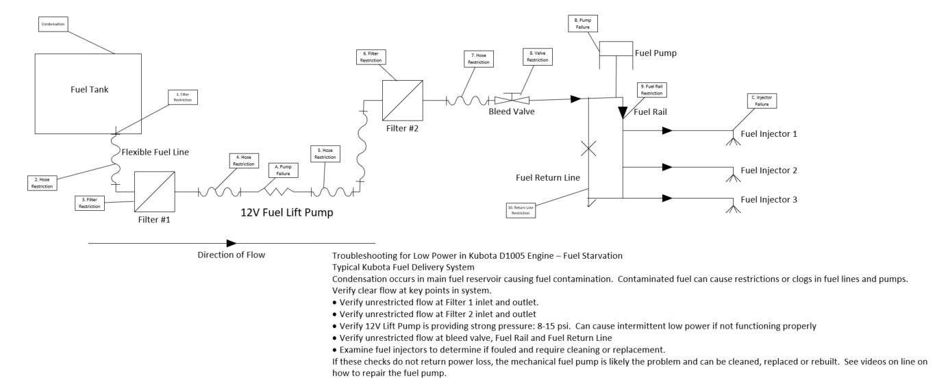

Simple diagram of possible causes. Does not include fuel tank vent clog or other fuel system leaks image001.png
Compressed air into fuel tank from hose leading to Filter #1 can also help remove any restrictions in the fuel tank screen. Make sure the fuel tank cap is removed before blowing compressed air into tank.
Also, if adding the water separator upgrade (Kubota OEM Part, 15521-43015 Filter, Fuel Assy ), recommend placing WS between 12V lift pump and Filter#2.
