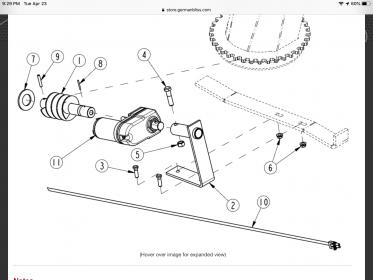

The only reason I’m considering the electric is due to cost. It’s a few hundred less. With the electric kit it’s just a control box on the tractor and a electric motor on the blower. Very simple install.

Yes exactly, and compared to electric, Night and day, Hydraulics is the only way to go when it comes to cold weather operations.
Also the investment in the hydraulics will carry over to any other need down the line where the electric is blower only.
The hydraulics will also raise the desirability of the tractor for resale of trade in down the line.
