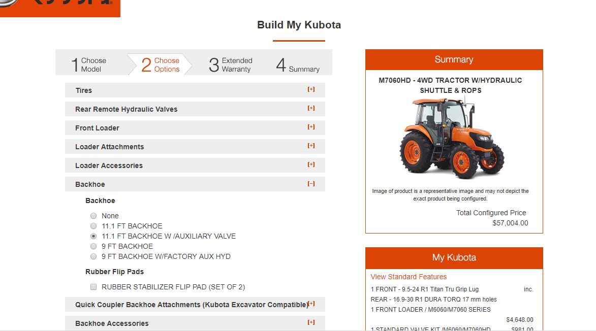

I could be wrong, but I didn't think they offered the backhoe loop in the larger M series, I thought they only came with a set of remotes and optional additional remotes, so I can see the dealer only offering that combination, and not straying from the standard OEM offerings.
Happy to be corrected though!
33,231
8,599
Is this proof enough? ;)
33,231
8,599
BH's like this do not run off of remotes, they run off of a Power beyond loop. ;)
I know what a power beyond lop is and how they work, I've even got one on my B21. What I'm interested in is the valve configuration differences between the 9 with factory auxiliary hydraulics, and the 11 ft with auxiliary valve? Do you have the schematics for the options on offer by any chance?
I think the writing on the factor build option is confusing you.
The Auxiliary Hydraulics and Auxiliary valve options are both essentially the same and has nothing to do with the tractor side of things it has to do with the BH controls and BH boom having the Auxiliary controls and piping for a hydraulic thumb or other hydraulically powered option on the bucket side of the BH. ;)
