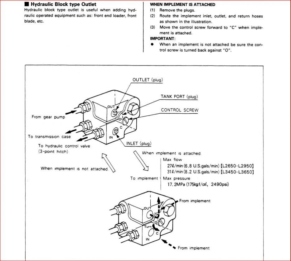

Matt,
On your tractor there is a hydraulic block on the side of the frame, Out is high pressure, In Is PB or high pressure carry over and the plug or hose that faces the front is tank or return.

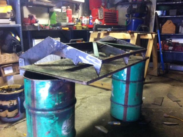

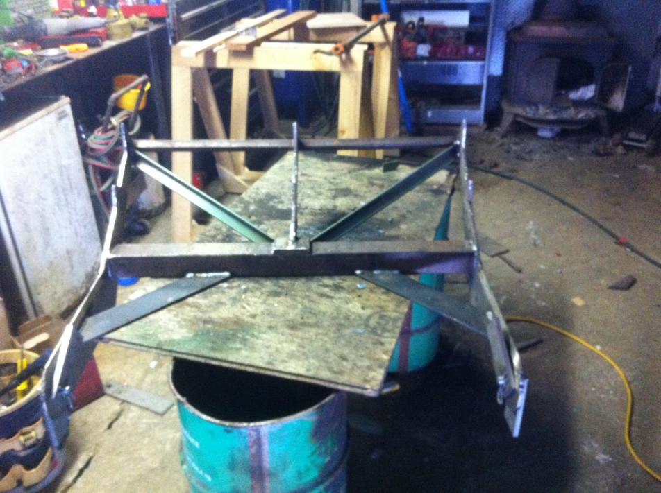

Ok I am back on this project. I have the grapple built and ready to install. I have plumbing questions, if I want to use a manual valve to actuate a cylinder where do I tap into the hydraulic system? The loader valve I have has 7 lines going to it. The pump feeds the block as shown in the last post. 2 steel lines go to the back of the tractor one to the case and the other to the valve under the seat. I think one line feeds lift cylinder for 3pt and the other is return?

When you say manual valve, do you mean a spool valve?
If so remove the line that goes to the in on the block from the loader valve and hook that to the in on your new spool valve then hook a hose from the out of that spool valve to the in on the block.
And you not utilizing the pressure relief of the loader valve, it's using the tractors pressure relief valve.

The out port on the block is pressure to the loader valve. The tank port is fluid return from the loader valve. The in port is power beyond.
Does the power beyond port feed the 2 steel lines to the rear of the tractor with pressure? Is the fluid return on the steel lines right into the tractor case?
Why shouldn't I get in series with line from the out port to the loader?
Where is the pressure relief on the tractor?
Does the control screw open and close a passage between pump in and the steel lines going to the back 3pt area?
Thanks again you have been very helpful!
Matt alberghini
l2850
Dec 2, 2014
middlesex vt
Hi again maybe I asked too many questions sorry.
I assume that when I buy a new spool valve it will new to have power beyond capability?
Would it need to be open centered as well?
32,935
8,386
YES
PB feeds one line tank return is the other
You can, it doesn't mater in line on in or inline on out
In the rear on the side of the differential, don't worry about that you don't need or want to change anything there.
Yes, it will bypass the loader.
