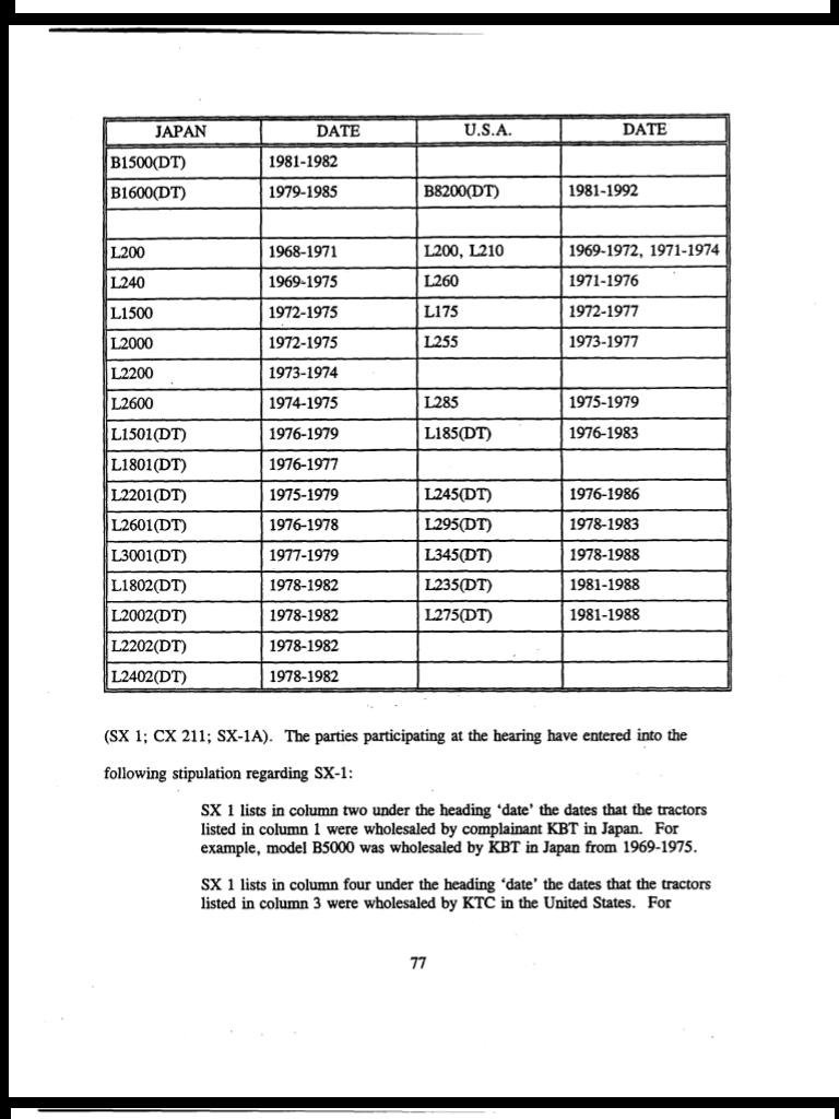

Anybody know of a Kubota that has the same engine and other parts as the l2002?
Edit: Well I found out the L275 has the same engine, so thats good.

I am running a ZL2202DT-M,I found a parts place in Saskatchewan that has hoses to clutches so far oh and manuals,I'm certain mine is also a L275 equivalent also,Yellow Rose Enterprise,call Sue up and ask about your model,306 232 5570
