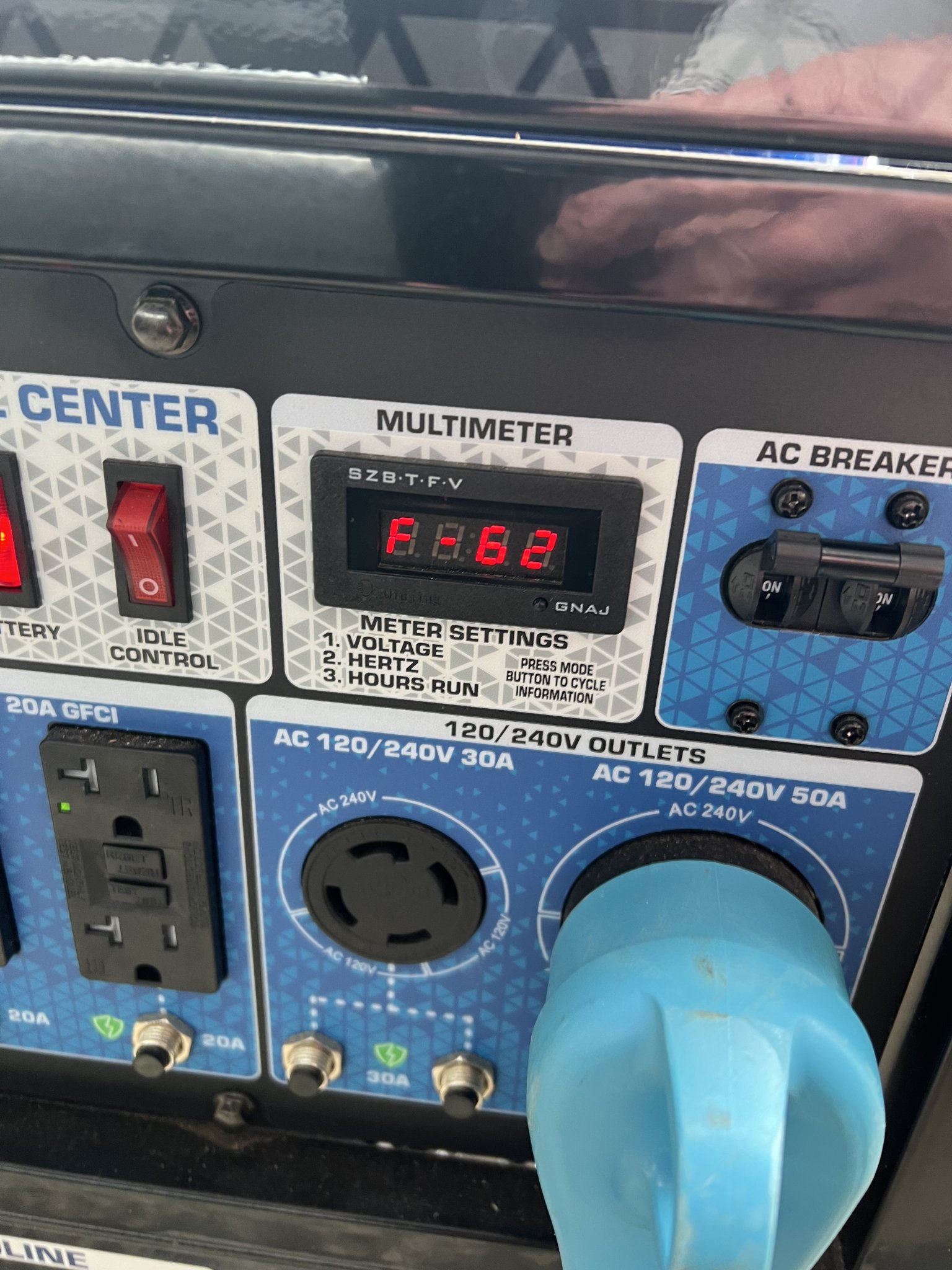

My thoughts/questions:
  1. I'm not savvy with the tolerances of frequency. Just don't know enough about it. Frequency typically reads 60-61 Hz, but noticed can vary 59-63Hz with/without instantaneous load demand of the water heater today.
  2. I'm not concerned, but should I be?
  3. IF I were to adjust Hz - - I believe it's throttle adjustment on engine?
  4. If I were to adjust throttle linkage for Hz, would it also affect voltage output?
  5. Pretty sure the following is a non-issue. Alternator reads 239-242 volts consistently. I'm happy with that. My older genny was doing 110 or so volts. Our Electrical Utility couldn't deliver maybe 60V early this morning..............
Don't be concerned. Only the most sensitive equipment might be affected in the real world.
Theoretically, the things that would be bothered are computers and things with computers (digital controls).
Resistance loads (electric dryer, water heater, space heater, hair dryer) and motors don't care.
  1. IF I were to adjust Hz - - I believe it's throttle adjustment on engine?
  2. If I were to adjust throttle linkage for Hz, would it also affect voltage output?
There is no way to compensate for frequency fluctuations by messing with the throttle on a consumer grade backup generator. Fuggedaboudit. The fluctuations happen FAR too quickly. You need millisecond response time, and you CANNOT get that out of a carburetor even with a fancy digital control. The engine just cannot respond that quickly.
Instead, concentrate on making your loads resistant to such fluctuations.
A laptop is already fairly immune, due to the fact the actual circuitry is powered by the battery, which is being charged by the AC. The charging circuit can tolerate sloppy power. Same for your phone
A desktop computer with true UPS (Uninterruptible Power Supply) is in great shape if it is a zero-switching time UPS.
A UPS is not going to work with something like a modern electric dryer, because it will draw more power than a UPS can handle, and you don't have the opportunity to run the controls from a separate power supply. If you are concerned, you can just flip the breaker and not use those appliances.
But really, you are probably just fine. I run my desktop, cable modem and router on a zero-switching UPS so I don't drop my Internet at all, and I just don't worry about the rest.
Correct. It's a non-issue. My grid power fluctuates more than that on a regular basis!
