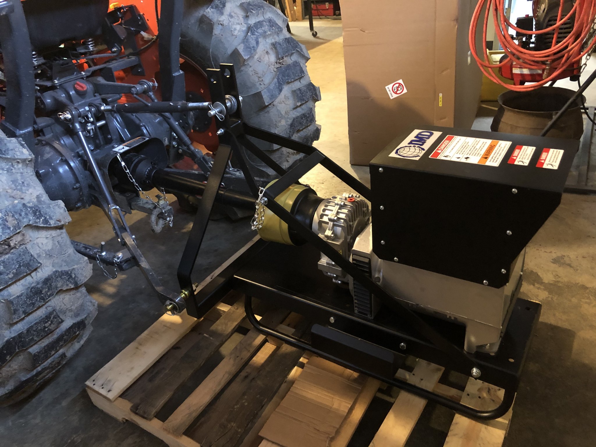

I got my 16kW from these folks:
They’re in South Carolina and were great to deal with. The AVR option was desirable for use as an occasional residential backup. I had some questions and called them. They were knowledgeable and glad to discuss to make sure I got a good fit for the various jobs I have for it. I saw their units on some other sites but they had no compunction selling direct.

I have a PTO unit (obviously) in addition to an older Briggs Stratton powered 7500W construction unit and if I were to do it over, I’d go with IMD direct again. However I do agree there are a lot of factors that go into the PTO / portable stand alone / permanent mount stand alone decision. I spent many hours researching before pulling the trigger on the IMD. PTO with AVR is a good fit for my use, but I definitely would not recommend it for everyone.
