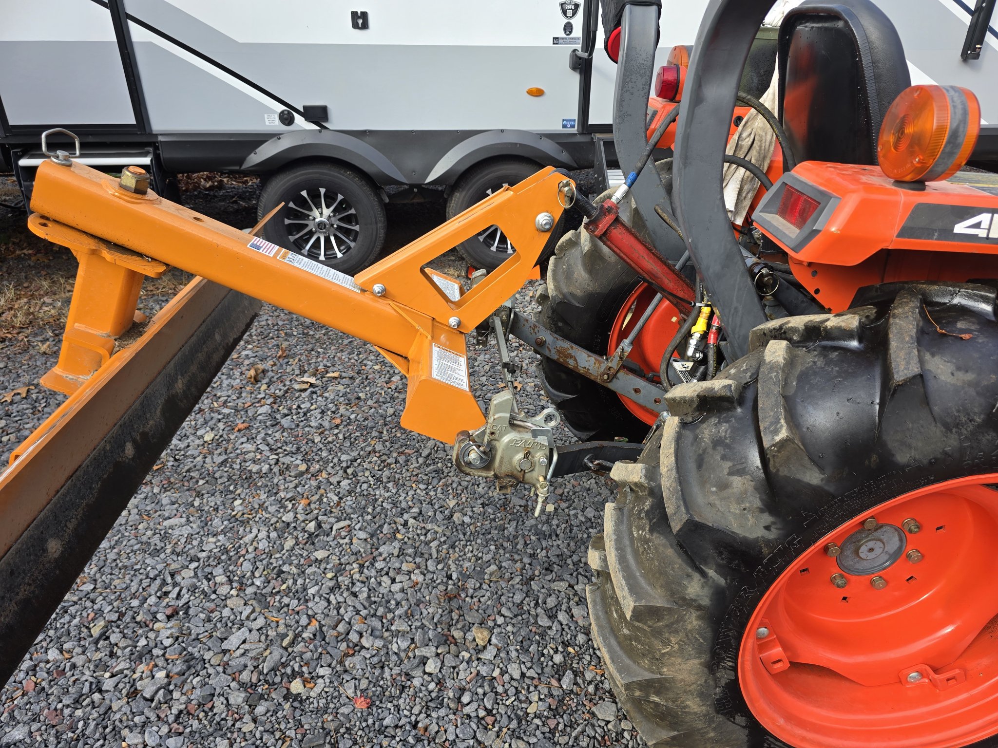

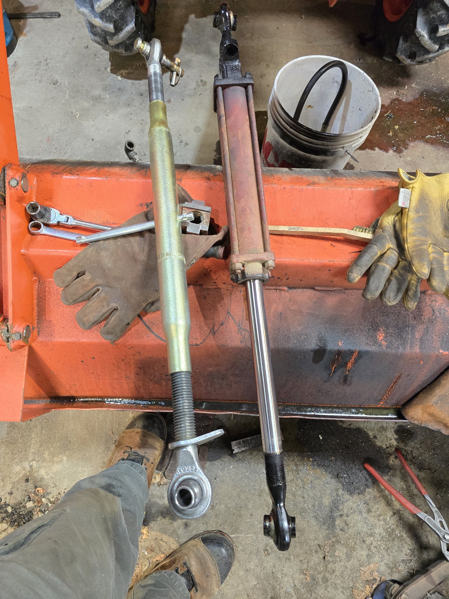

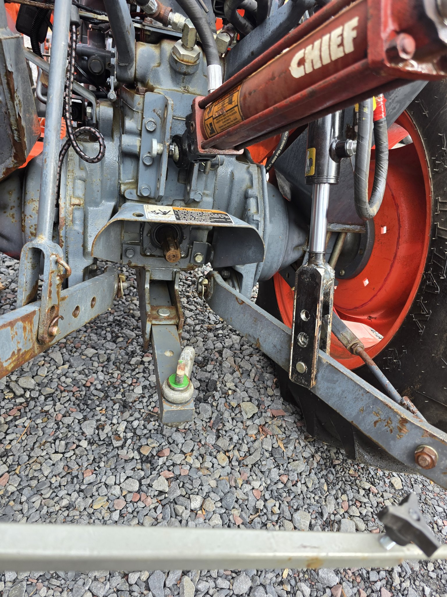

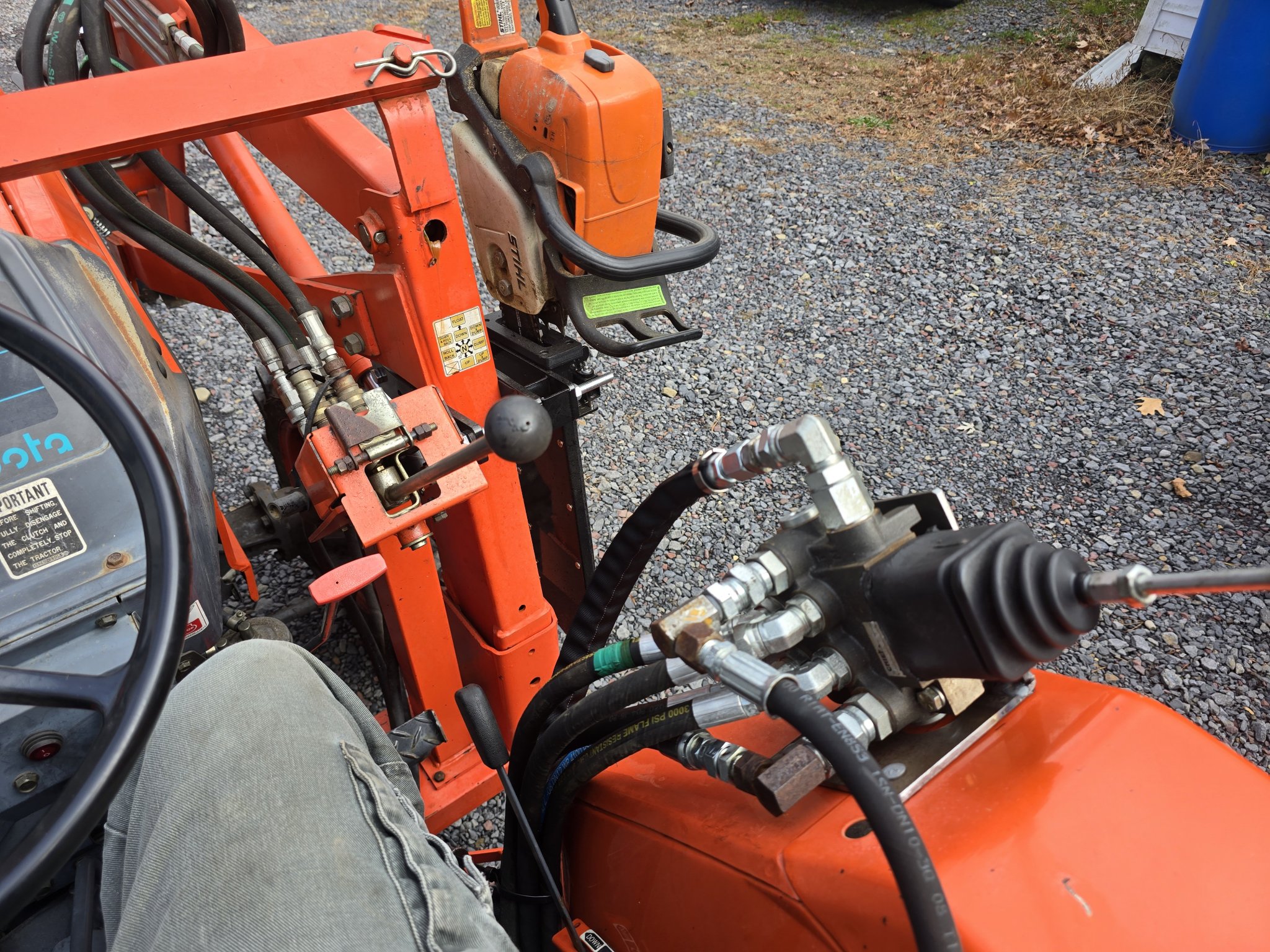

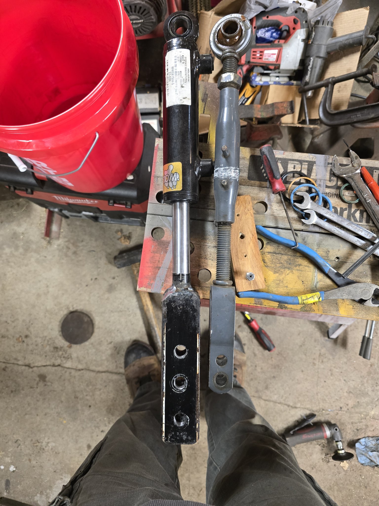

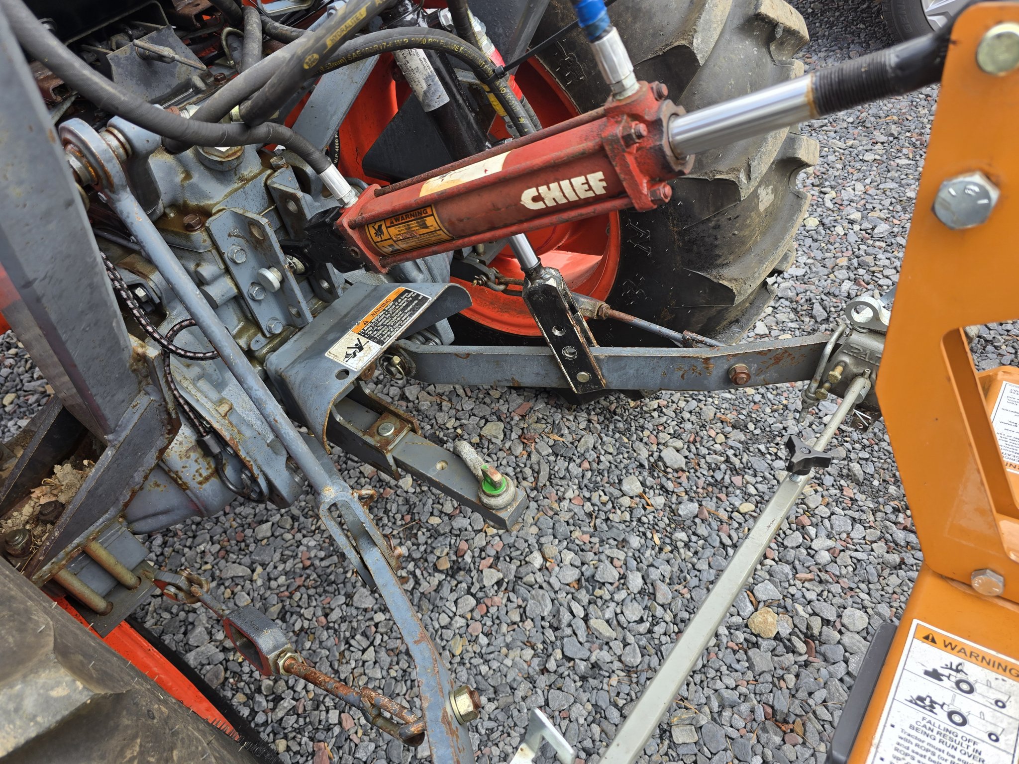

So, I had some hydraulic stuff reclaimed from other projects, and decided to do something with it. I do expect to rebuild the chief tie rod cylinder sooner than later, as it has been in the weather for some years. The top link got some weld on rod ends, and the side link got one rod end cut off, and some left over steel scraps welded on.

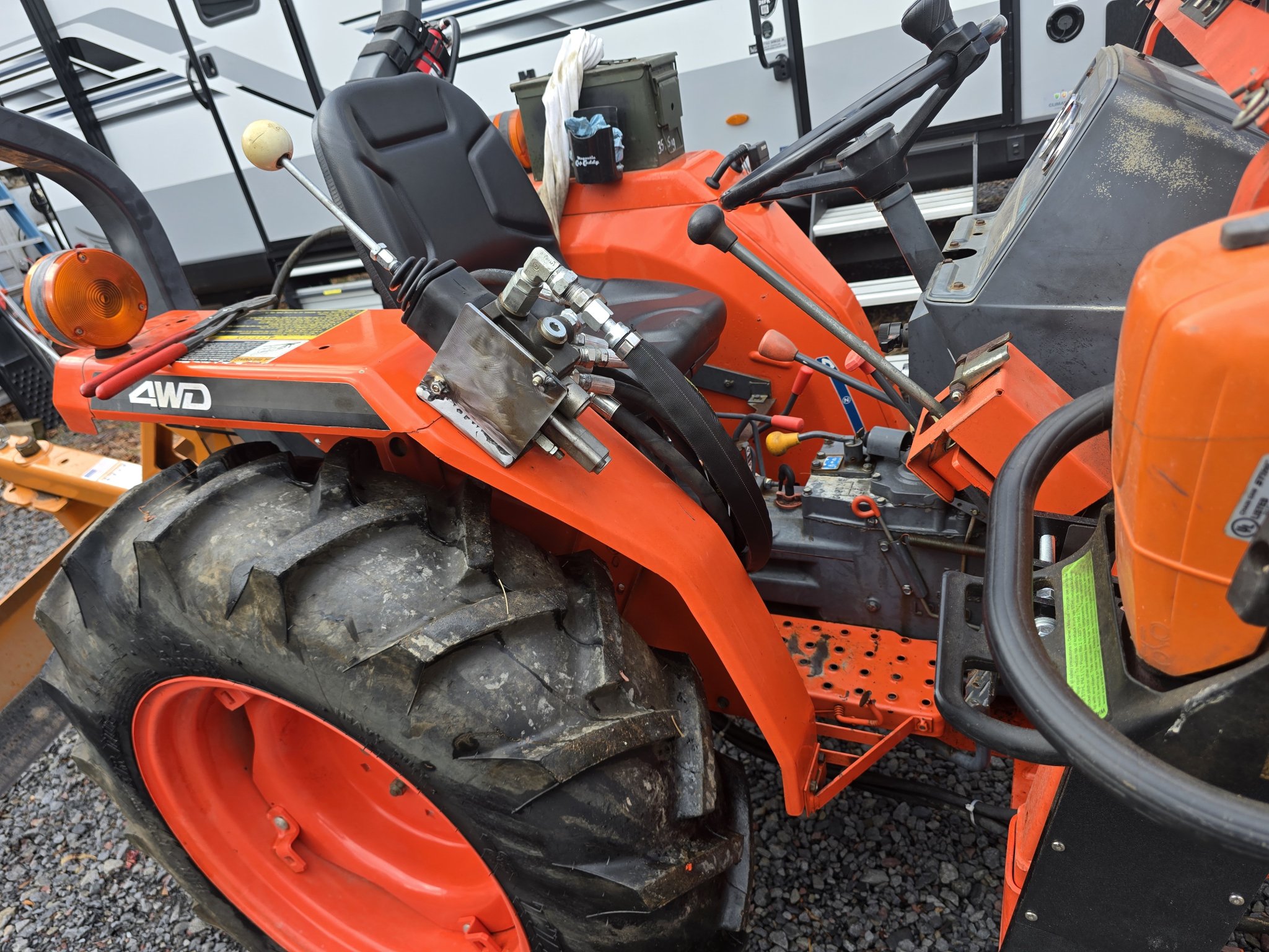

These old l series have very tight operating stations, so I mounted the valve on the fender, and it actually doesn't hamper the loader valve or the 3-point valve lever. I will end up adding 90 degree fittings on the top link, and tidying up the hoses a little more. The hoses are about 5 years old, and will be replaced as necessary with a more appropriate length. The valve has float, and it's function is on the side link.

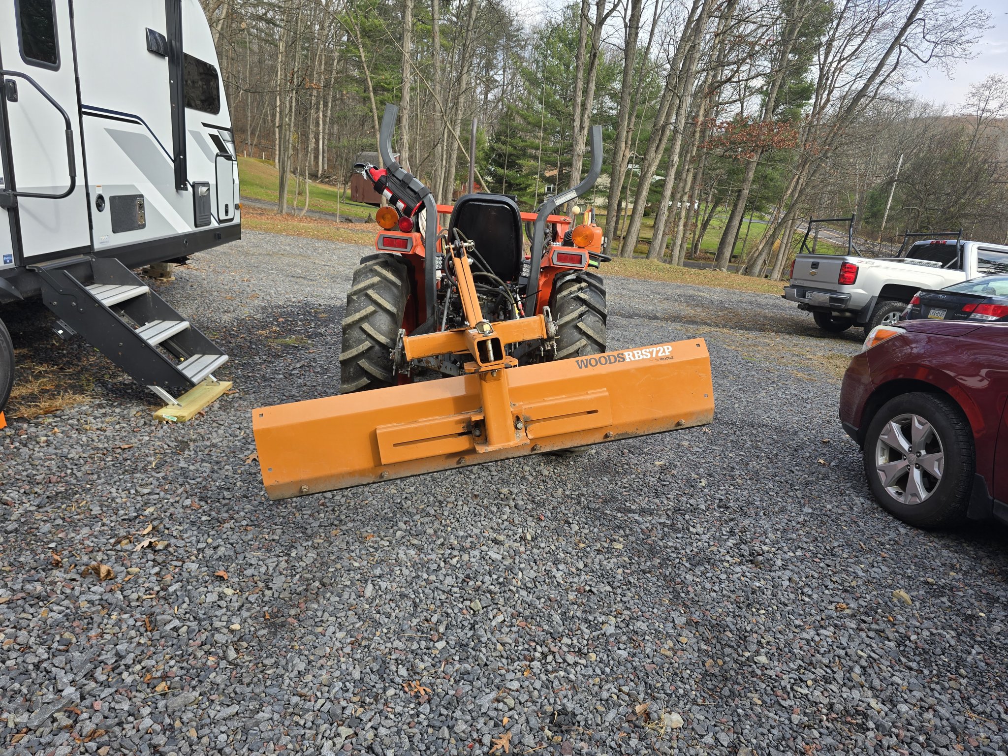

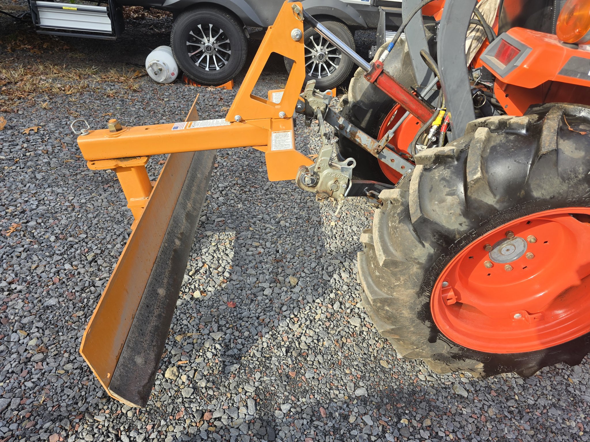

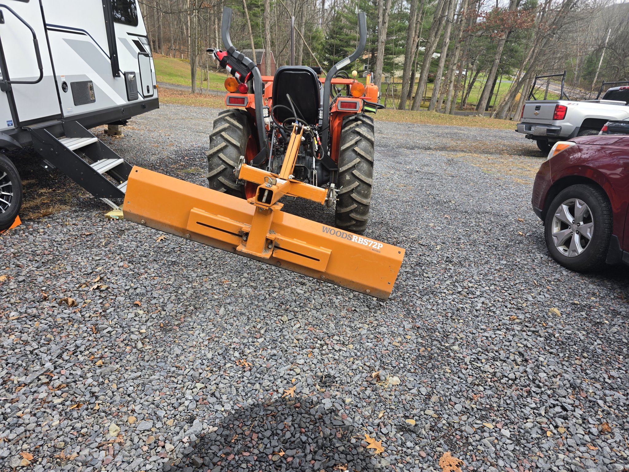

Here are some photos with a back blade, although this will be more effective with the box blade. I did use it for about an hour, and it worked as expected.
