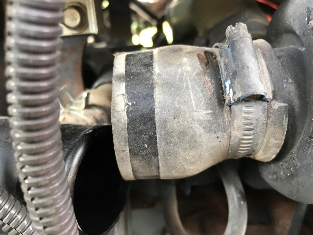

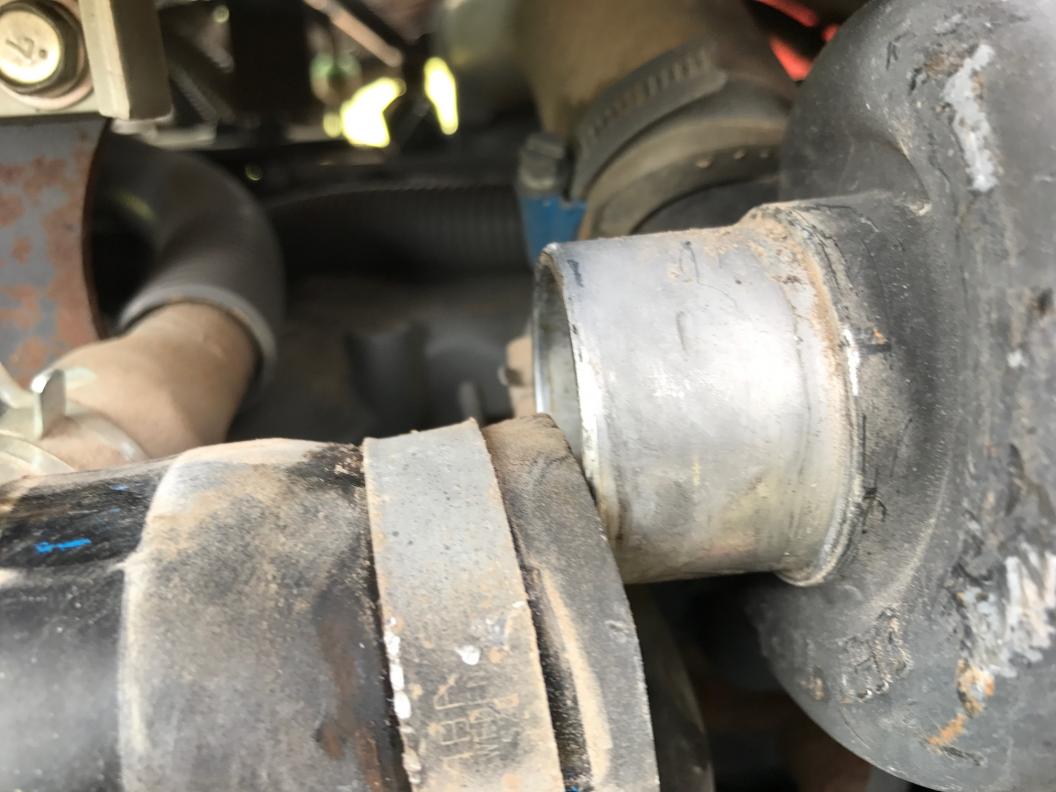

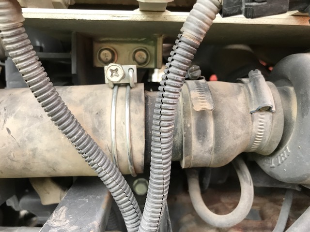

I uploaded pictures of where I believe you are referring to. They all appear to be properly connected. I put the old filters back in and let it run for about 10 minutes. Someone stated it needed to run for a while before it reset??? I removed the primary filter and same thing. Still blinking.

The hose isn't far enough onto the turbo inlet and the clamp is too far from the end of the hose. That clamp doesn't look to be tightening onto the turbo inlet at all! The turbo inlet isn't very long.. loosen off both clamps and slide that hose right onto the turbo, then put the clamp as close to the turbo as you can get it and tighten securely.

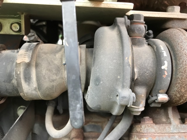

1-are the clamps in the 1st picture the wrong clamps, I was under the impression these were water hose clamps. Shouldn't they be the same type clamps as the second picture.
2- is the turbo inlet the 1st or the 3rd picture???
3-what is the hose that comes off the back of the T, I believe it goes to a canister upper right of the engine, sitting in the driver's seat.
Hose clamps are ok
Turbo inlet is first picture and I think you are refering to the smaller hose from the tee that goes to the ccvc (Closed Crankcase ventilation Canister)

I spent the better part of the day taking everything apart and then reseating it forcing the hose on as far as it will go and tightening them really tight. You can see from the enclosed picture that the hose inlet the turbo was firmly in place by looking at all the shinny metal . I found the clamp in picture 3 (see above) loose and thought I have it now but after driving it around for 20 minutes, I still get the flashing PO 101.
