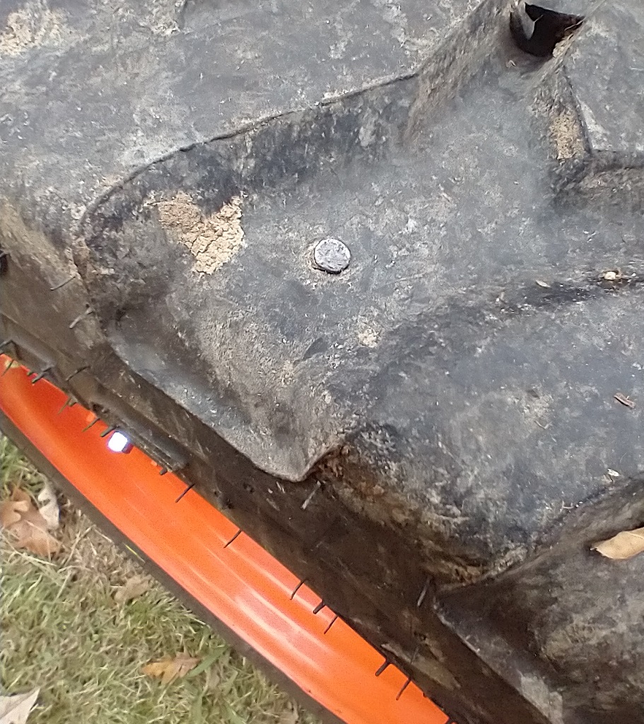

I imagine so, but front tires are small and getting them foam filled prevents future flats completely, and does not cost all that much.
Did that on both my BX and B2910 tractor soon after purchasing. Flats on the front of both was the reason. No regrets at all, after 19 years on the B, and 18 on the BX...
3,632
6,757
Nothing against foam fill but if you’re not going that route for whatever reason, where that is on the tire a tire shop should be able to knock that off the rim and patch from the inside for nominal cost if you take them the wheel without the rest of the machine. It’s a better repair than a plug and the thought of ramming a plug through a R4 tire is making my wrist hurt.

I would go for a patch or a plug patch as well if this is just a random occurrence. If you will be operating in conditions where punctures will be a regular thing, then foam be the better option.

Unfortunately your puncture is in between the lugs of the tire. This area is very thin material. I had one in the same spot. The plug I installed leaked because you have to ream the puncture to install the plug which normally works but thats when its used in the lug area which is thick and will hold the plug better. I wound up using the Kubota branded liquid tire sealer along with the plug and its been holding for close to two years! You could try plugging the tire without reaming the puncture larger. I think this would be your best bet as far as plugging goes! Good luck!

I kept putting it off and off. Would just pump up the tire each time I used the tractor. After about 4 hours of working, the pressure dropped enough to roll the tire off of the rim.
I took the wheel to my Kubota dealer Sat morning. They took about 10 mins to replace the valve and plug the hole for $28. Gave me time to look at their large number of L3301s and L60 series units.

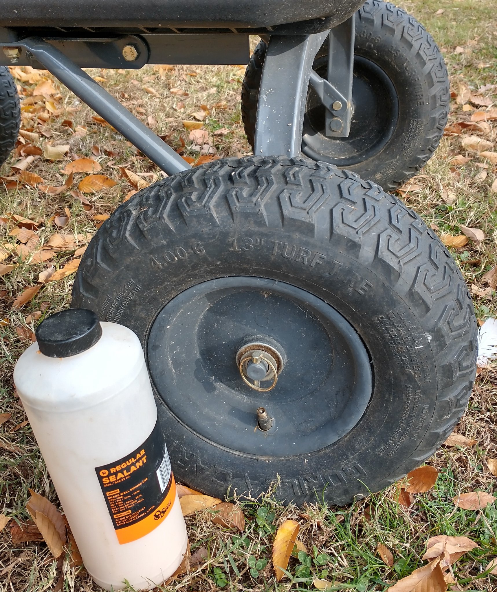

This photo has nothing to do with my problem, but is for the other biker who replied.

Not that I matters as you have already had your tire repaired, but I had a nail in the front tire of my B2650hsdc and put a plug in it. This was over a year ago, and has not leaked since. Just for others that might want to go the same route.

Follow on for reference - I ran over an old chicken run (dumb move) and put three nails into one of my fronts (R14) I tried plugging. It works for my DD tires and it was fine on 2/3 but fail overall.
Ended up getting a truck repair shop to patch and have been golden since. I was in a time crunch and the place was going to patch AND tube, but got in the wrong stem type. I have one on hand now JIC
