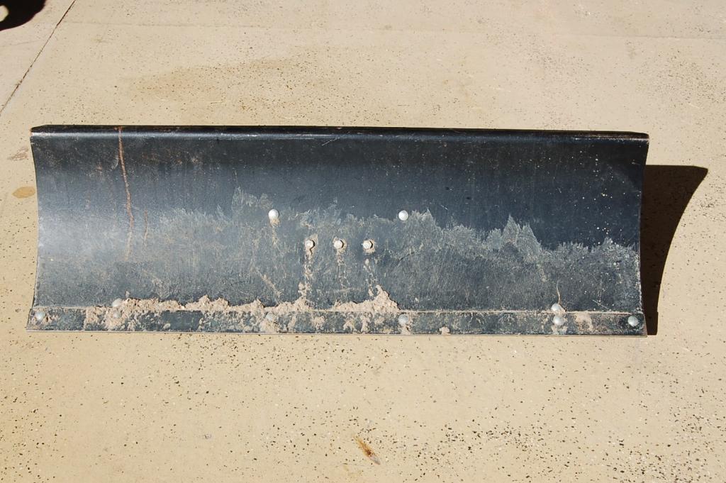

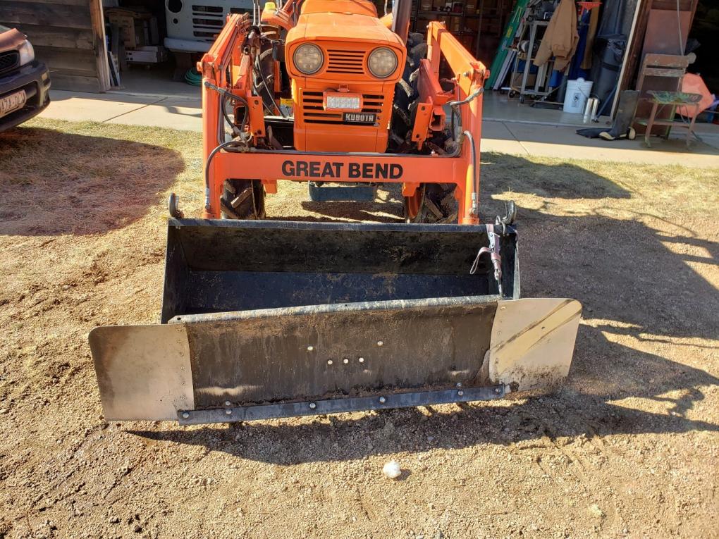

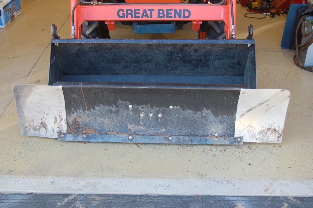

so I found a 42" blade in the Springs for $75, got if for $60
added some wings and now it is 60".
In a pinch it is working pretty good.
I keep the FEL in float mode and use the bucket dump to
control the UP and Down of the blade, has about 10° Left
and Right swing.
Will do until I get the plow mounted on my F250.

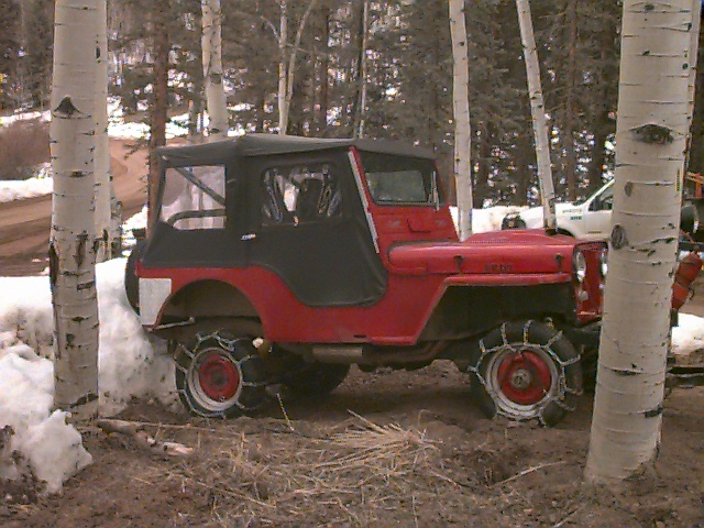

But here it is, pics from the last house, do not have current.
50 CJ3A - 95 4.3L Chevy Vortec V6 - Warn Overdrive Unit

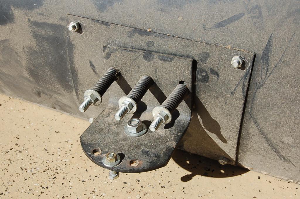

My question is, what or how do those three springs help that blade? They look like compression springs that are clamped tight. To allow movement of the blade when it strikes something solid doesn't it need extension springs that allow it to tilt?

That is exactly what they are/do, allows about 5" of movement.
The left and right spring holes are oblong so they allow up/down tilting.
Works surprisingly well , for something thrown together in an hour or two!
