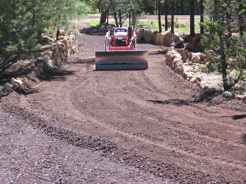

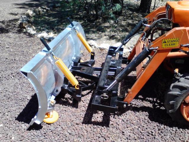

I'm new to tractors and plowing. I bought a 72" manual adjust plow for the front of the L2501 tractor.
Looking for suggestions as to how high to set the blade height when plowing gravel. I'd like to get close to cleaning the dirt/gravel driveway when it snows, but I don't want to scrape all the gravel off.
Can any with more experience than me offer their thoughts?

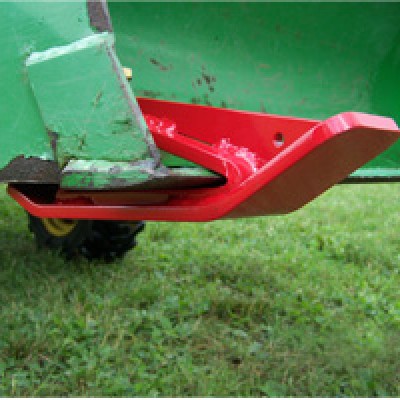

http://r2manufacturing.com/edge-tamer-2/
Those look interesting. My first thought was they would still dig into a gravel drive until the drive froze. Then you would be OK.
So I watched their video and noticed something when they were doing the unfrozen ground/no snow demonstration. It appears that they weren't using the "shoes" to keep the cutting edge out of the ground. It looks like they rolled the bucket back just a hair so they could set it on the ground, lift the front of the tractor and go.
I think they lifted the front of the tractor to show that even with all the weight of the front of the tractor on the bucket, the edge tamers won't let the bucket dig in. Seems to work great on grass, but wish they'd do a demo on gravel.

I have a 60" Curtis front blade with "mushroom feet" and it works great on hard surfaces, but on the cinders it just keeps sinking until it hits the hard pack underneath the gravel. Maybe some kind of roller setup instead...
Loosen the spring tension on your blade so it is not as agressive. That is what I did when I had a plow on my truck. On my tractor I use the loader with a blade on it and I tilt the blade forward slightly until the ground freezes. Once it is frozen tighten the springs back up. My driveway use to be almost an 1/8 mile long and gravel
Maybe something like edge tamers, but with a much bigger "shoe" to float on loose gravel better.
If the bucket is indeed rolled back a little, it will ride on the floor of the bucket and never dig in. No skid shoes needed. That was my point. They clearly weren't lifting the front of the tractor with just the edge tamers touching the ground.

I have a 60" rear blade and put edge tamers on the bucket. Only one snowfall last year, over a foot, more than the rear blade could handle. I had to move it by the bucket full. The tamers worked great, nearly no gravel on the lawn (15 minutes with a rake once the snow melted and it was gone).

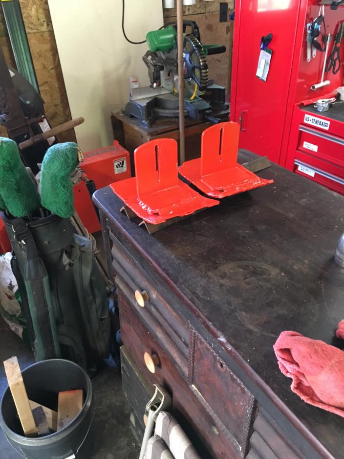

I think I posted a picture a year or two ago, but Tractor Supply did carry a shoe with a shape very similar to the edge tamer shape, but with the post like your mushroom shoe. Might work better on your blade in the cinders??
I'm not sure how my snowblower shoes will work on my newly-stoned driveway, so I did a modification of the stock shoes.
