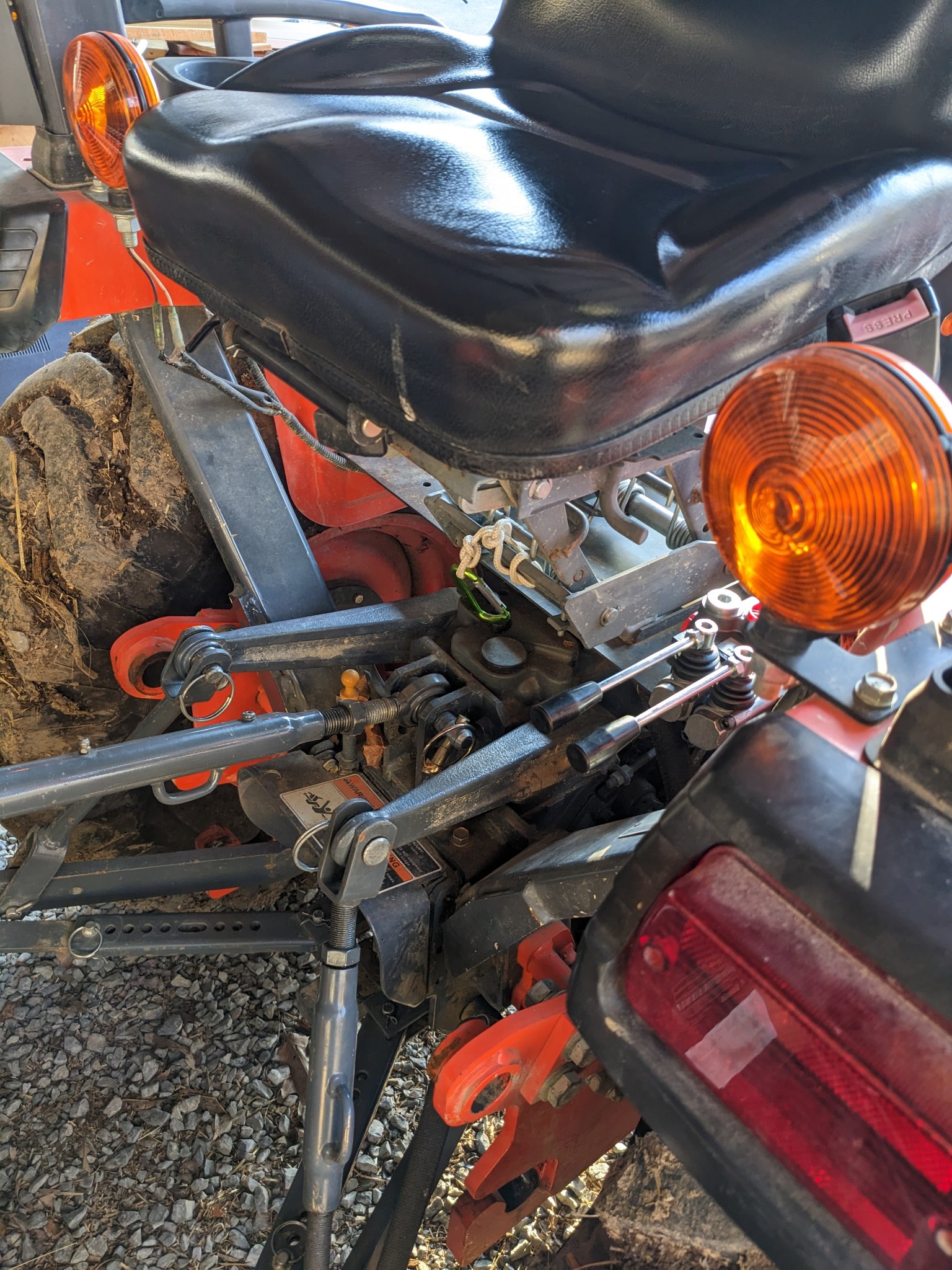

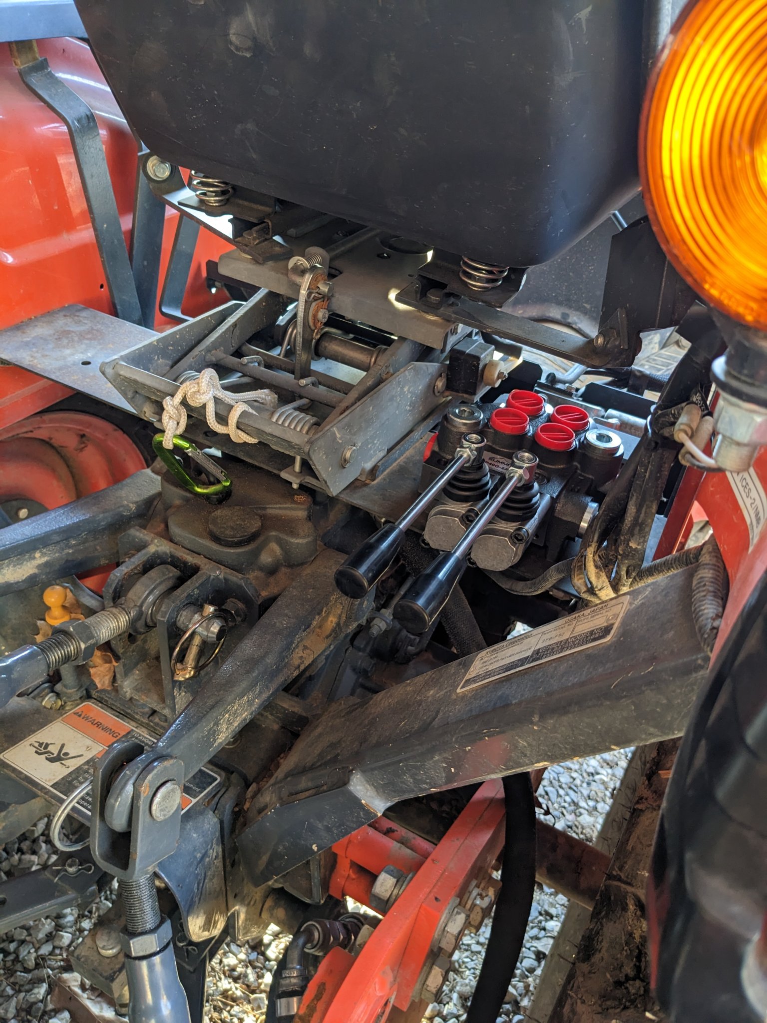

1) Under the seat, mounted on the metal the seat is mounted on
Pictured here, the handles are facing backwards as is the seat. I rotated the seat forward and backwards and even with fittings attached I do not think it will be in the way, although routing hoses and such may be a challenge in the relatively tight space. There's little chance of hitting the handles accidentally when getting into and out of the seat.
An alternative there is same location, but with the valve handles facing forwards. I can slip my hand between the seat and the right fender to actuate the valves, and it would make routing the hydraulic lines a little easier, probably.
With this setup, the 4 connections for the rear remotes will have to be brought out either to a bracket holding the quick disconnect fittings, or to 4 relatively short hoses holding the disconnects.

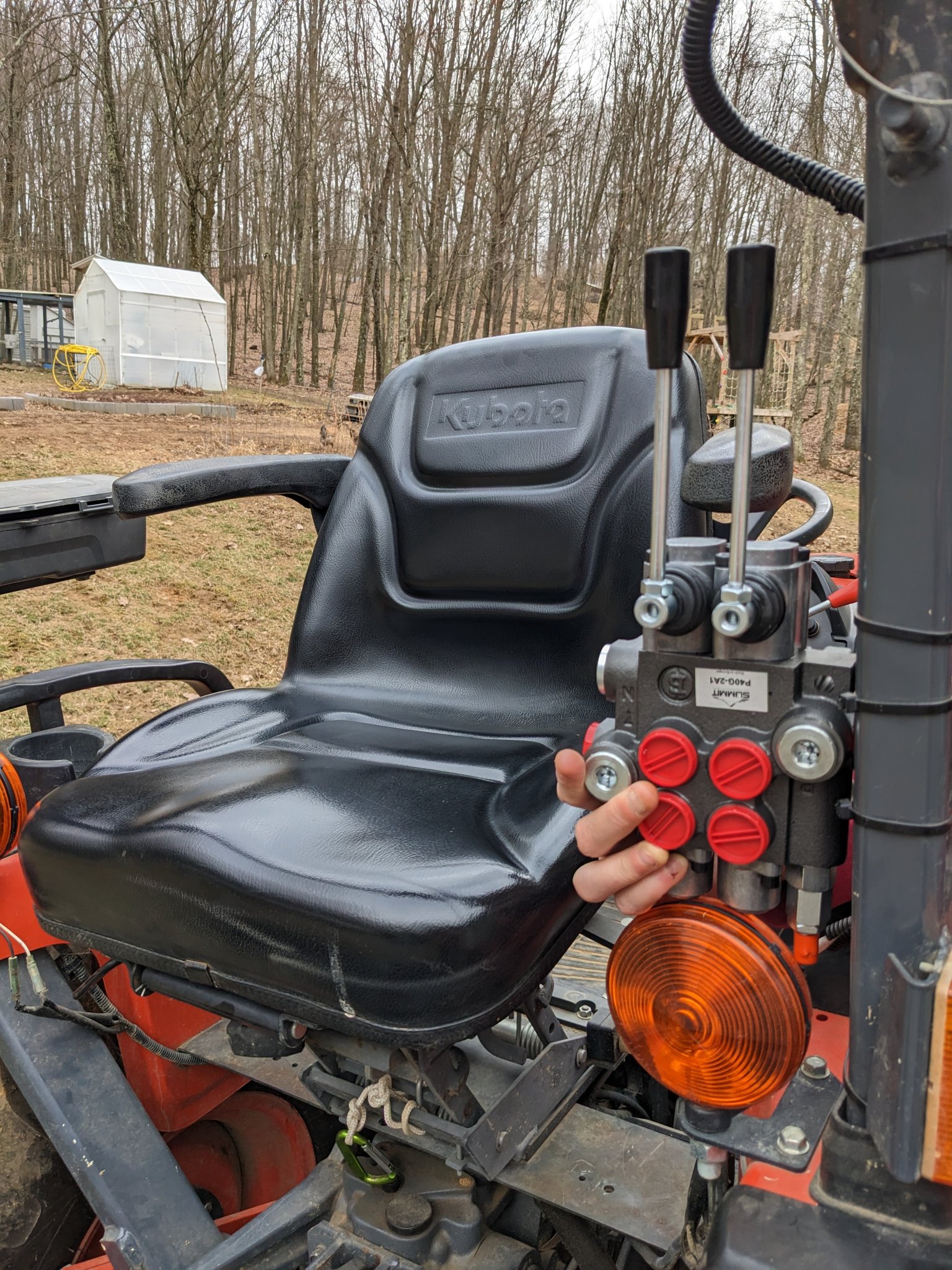

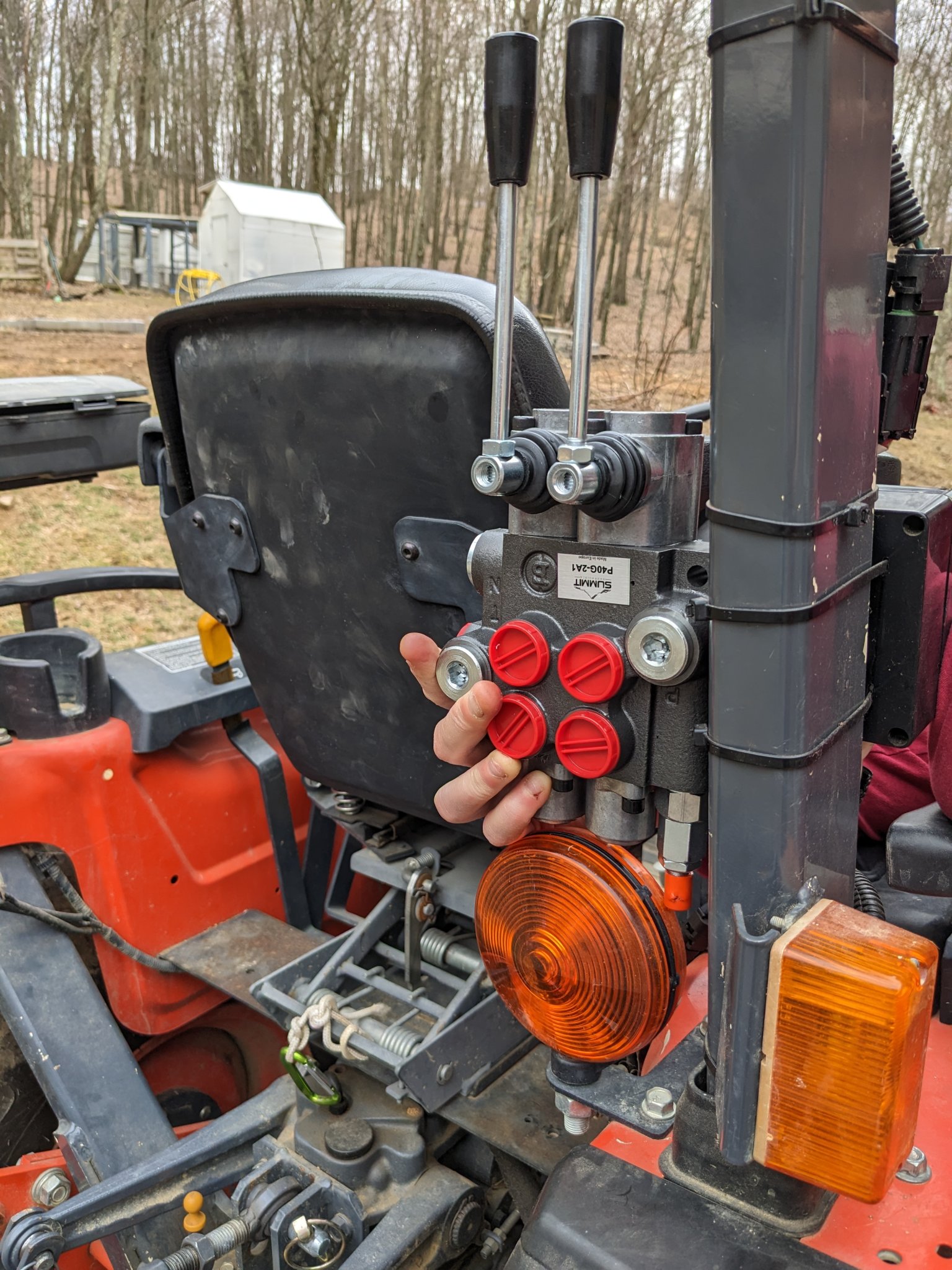

2. Mounted on the right ROP.
The valve handles are a lot easier to reach here as I'm usually turning my head around to the right anyway to see what the box blade is doing. Routing lines would probably be easier, as it's not in a confined space. It is still well clear of the seat, whether forwards or backwards or rotating.
This position would have a definite advantage if I could mount the 4 female quick disconnects directly on the valve body, and would save quite a bit of money doing so. But what I don't know is if there is enough room when they're bunched together like that to be able to get my fingers around the fitting to cause the disconnect. That seems like it would be pretty tight.
View attachment 99441 View attachment 99440
View attachment 99442 View attachment 99443
