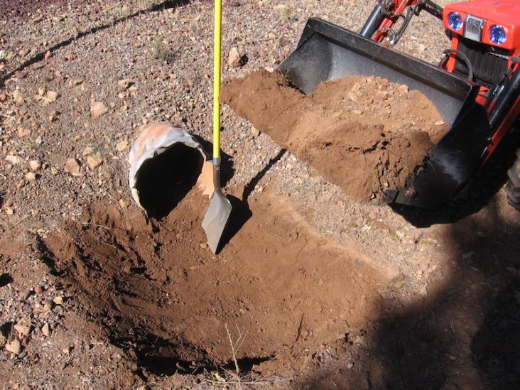

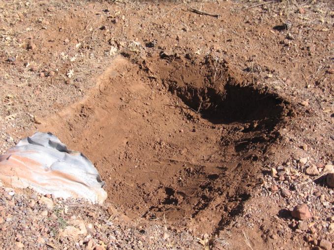

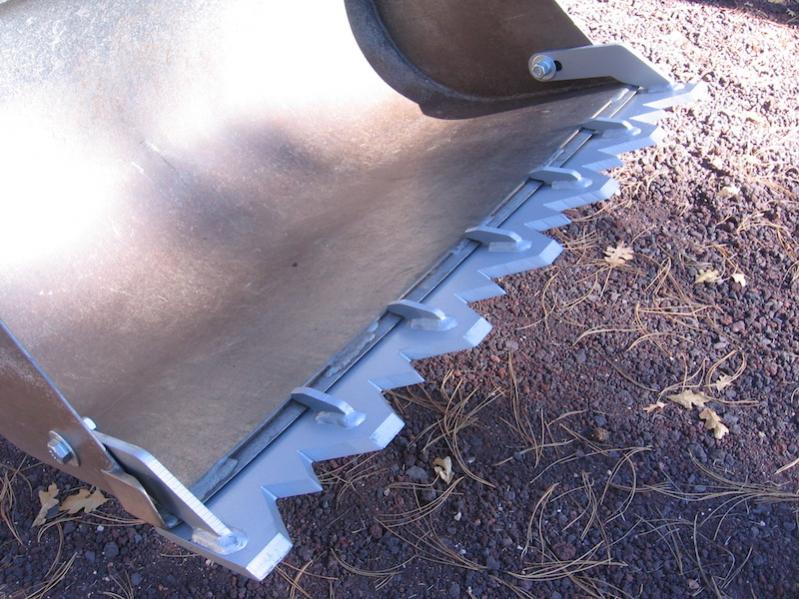

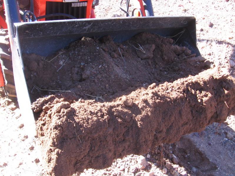

Got mine mounted a few days ago. Needed to clear some dirt at the end of the county culvert, normally a job for the backhoe. I set the bucket on the ground at a 45, lifted the front of the tractor for down pressure, drove forward while curling the bucket. It sliced into the ground like it was butter. I dumped the scooped material and repeated the process from the opposite direction. Just two scoops and I had a nice well at the end of the culvert. Simply amazing.

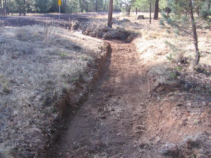

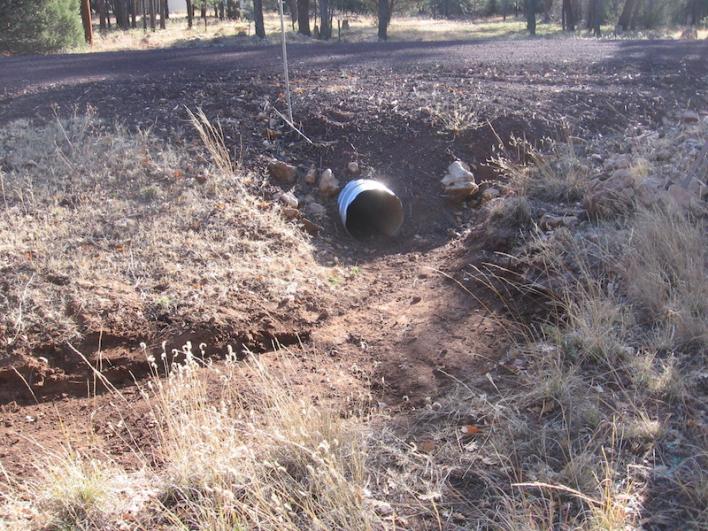

Next, I scraped some material (about 7 full buckets) out of the water course at the opposite end of the same culvert. Hardest part was not letting it go too deep, because it cuts so easily.

In conclusion, this thing is awesome. If I had to find something to snivel about, it would be that this thing is heavy. Mounted way forward on the bucket, it acts even heavier. Not a big deal for most modern, larger tractors, but on my little, antique B7100, it noticeably cuts down on what I can easily lift. Full bucket of slightly damp, sandy, dirt/clay mix material would seldom trigger the pressure bypass previously, but with this on, I was hitting the pressure relief occasionally.
Not a big deal, just a re-adjustment in technique.
Perhaps one day when I get time, I will "swiss cheese" it.
(drill a bunch of holes in it to lighten it)
It is certainly built stout enough to remove some material without compromising strength, just have to calculate how much I could lighten it vs how much work it would be.
