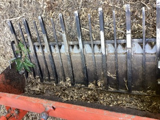

Hum, two holes through the soft steel on the side of the bucket, or many holes through the hardened, factory cutting edge. i prefer the original mount. A side benefit is the bolts hold my mulch forks as well.
Yeah the 2 is simpler. I thought the holes were already present in the bucket edge? You have a bad ass setup.
Maybe there are holes in some factory buckets, mine had none. :unsure:
