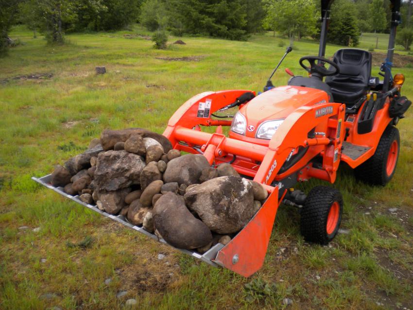

Steve, Here is a picture of some rocks that I dug up using my BX1860 with the PTB. If these are the same size as the rocks you are concerned about, the PTB will definitely do the job. If I had a bigger tractor I am sure that I could get even bigger rocks out of the ground with it.
