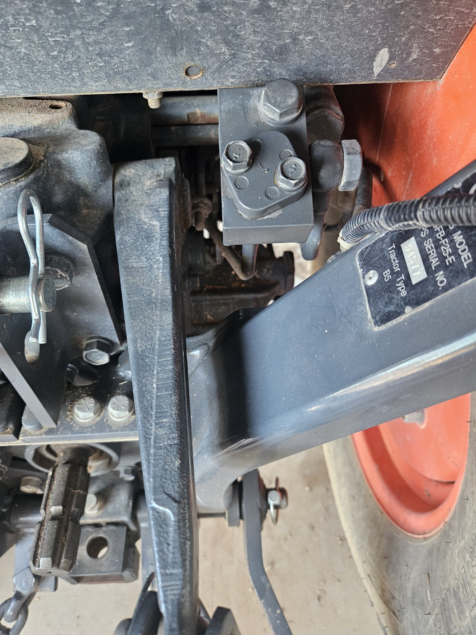

I'm installing a top and tilt on my B2530, very similar to a B2630. I've been through all the threads and I think I have a plan, but the "little things" are tripping me up. It has a factory rear remote valve and block at the rear. (See pics) I purchased a diverter from Spare Parts Holland and a Kubota hydraulic block. Went down to the local hydraulic hose shop and told them I needed some fittings but wasn't sure of the thread. The lead guy went to the back and came back and emphatically said the threads were NPT, so I bought several NPT fittings.
When I got home I tried to thread them in by hand tightening only, and it didn't feel quite right.

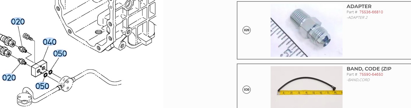

I looked up the the drawing for the diverter and the threads are called out as G 3/8. So I've researched that rabbit hole and narrowed down that it's a British standard thread, but there is a BSP and a BSPP. So my question is how to determine which one?
Same on the hydraulic block. I installed the same one I am going to use at the mid port for the FEL, but purchased the two adapter fittings (20) then, so the problem didn't arise. IF nobody knows offhand is there a way to get the specs from the part number?

I am installing a top and tilt for occasional use , so I am taking the flow from the rear outlet, (see pix)), to the Kubota block, (40) to a diverter to select the cylinder, instead of the extra expense of a multiplier. I guess I should have asked if there was a better solution.

I would expect the adapters for the Kubota outlet block to be 3/8 male NPTF x male JIC-08.

The hydraulic block in the question, P/N 40, bolts onto the rear outlet when the diamond shaped cover is removed. It has 2 tapped holes for the hose fittings and two drilled holes to secure it to the outlet.

I need to attach P/N 40, ( IPC diagram), to the valve outlet to attach hoses from the valve to the diverter.

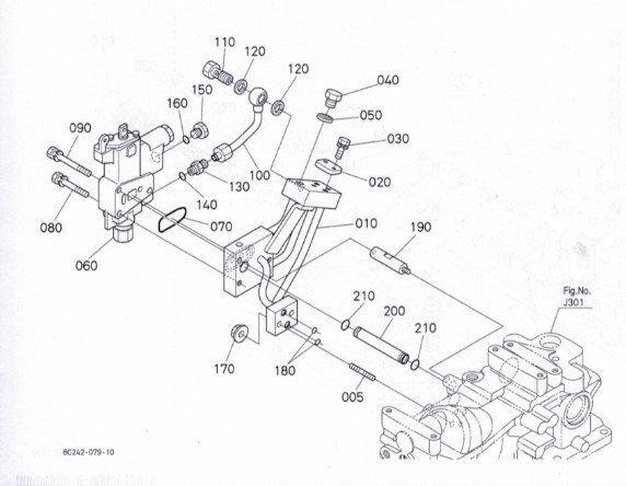

There are no installed QC couplers. Here is what is on the tractor: Screenshot 2024-10-11 114150.jpg
See pix on first post.

My bad and I spologize.
I assumed your tractor had the standard Kubota remote valve with outlets like the B2630 you referenced. I have never seen anything like that picture from the WSM.
So indeed you connect the two ports on the outlet block to the IN ports on the diverter.
So back to that plumbing.
Connect the outlet block to the IN ports on the diverter with hoses.
Put 1/4" female quick connects on the other four ports on the diverter. Replace the 1/2" male tips that came with your cylinders with 1/4" male tips.
You now have two sets of 1/4" rear remotes controlled my the OEM valve.
Plug in the TnT hoses and you are good to go.
