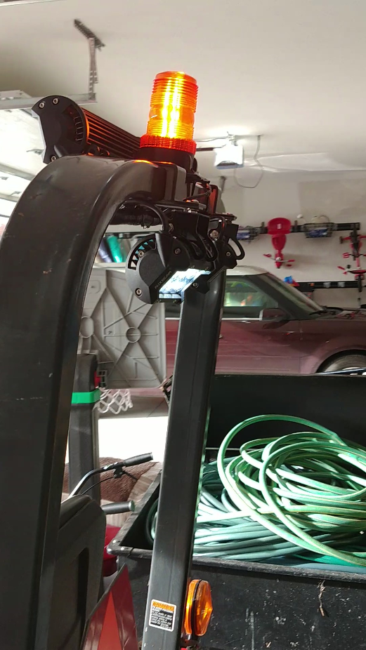

So it's been awhile since i've had the LED lights on my rops but I figured I'd post up some pictures since others on this site were very helpful in getting this done. I'm by no means a fabricator so I sourced the parts to go around the rops from menards in the hardware section. I also bought a wire harness from amazon and used it with some additional splices. All the lights have bullet connectors and are sealed inside the wire loom which is secured via zip tie and those 3m stick zip tie holders. I did paint most of the items the Kubota Rops color as well so it blends a bit better. The box with the switch is also bolted through the back of the conduit box to the triangle sign on the tractor.
