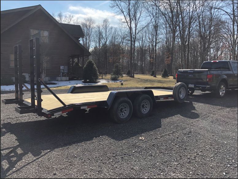

Here's a few pics of the new trailer that I picked up today. I'll get some with equipment loaded next time.

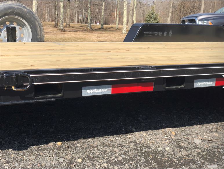

Fork Holder Pockets (look closely under the rub rail).

Those pallet fork pockets are neat.
Luckily I just asked about the fork carriers when I was placing my order. They don't list them as an option, but will do them for new builds for $300. When I asked them why not, he told me that they are trying to stay away from any "customizations" since that puts them at approx 10 weeks for completion. My trailer was 5 weeks from order to pick up.

I must admit, I'd like that feature on my MidSota trailer. I bought it used but would have chosen that option if I were ordering a new one. I guess I could add that feature fairly easily.

Sure could, they welded in some square stock about the length of my forks. But, as you can see in the pic, they cut the holes through the main C channel. If you tacked on something below the frame, I would think it would be just fine as well.

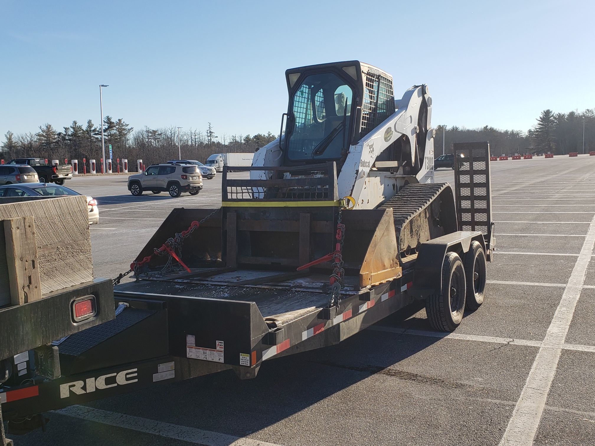

Not a tractor but its got a Kubota engine

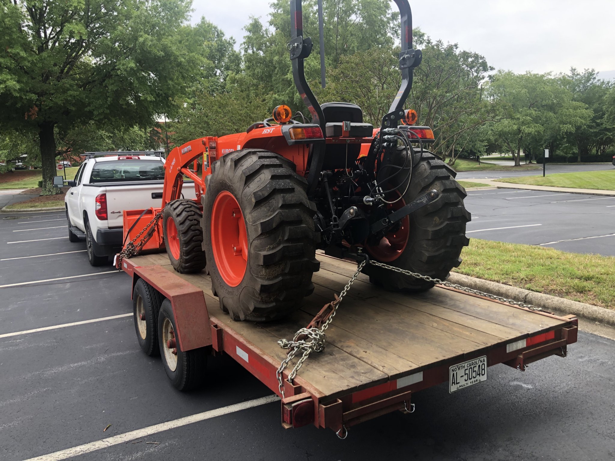

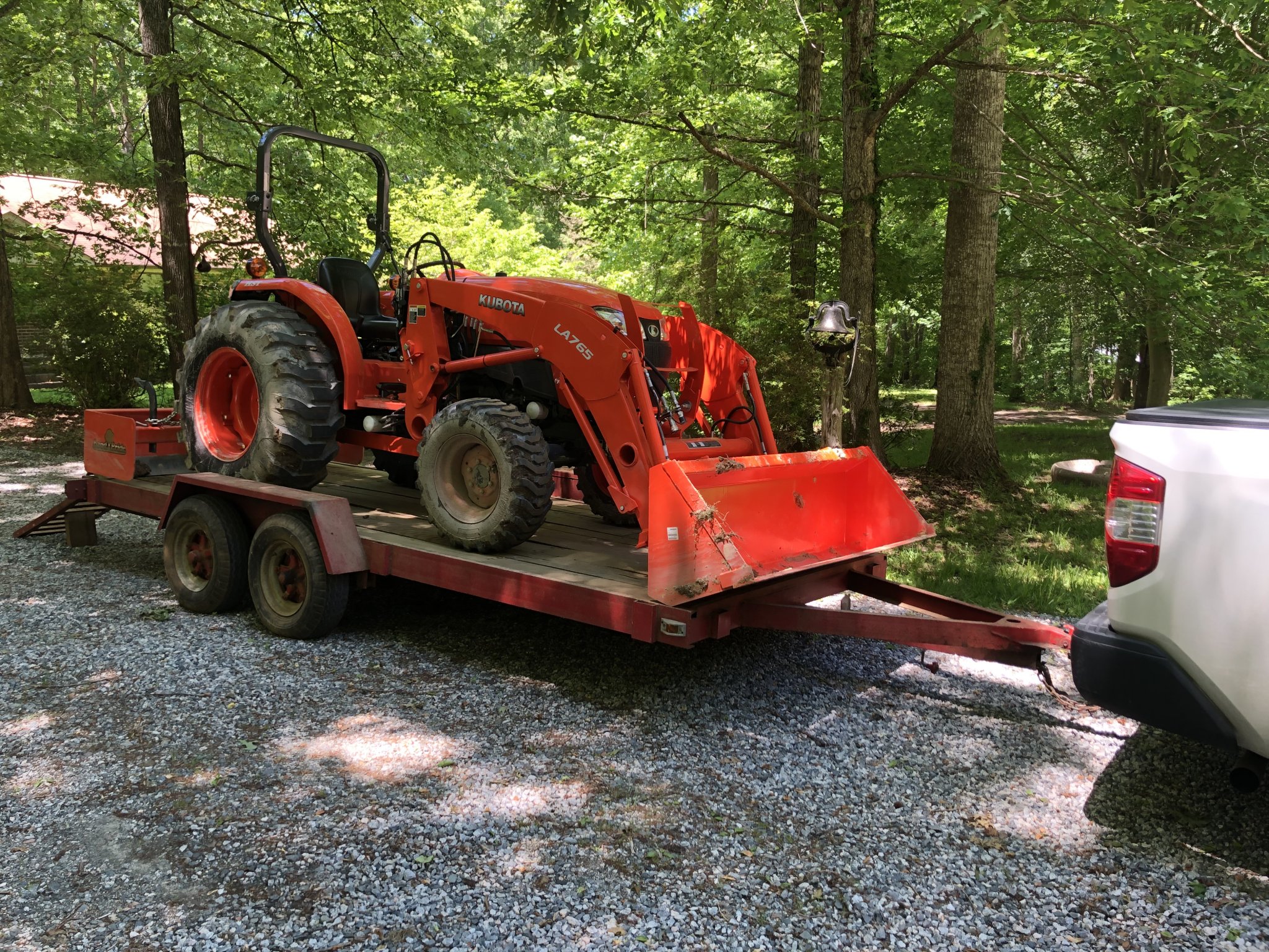

Since you mentioned not actually having the tractor yet, thought a few pics of a L4701 on a 16’ trailer might be helpful. By the time you load the rear tires or add wheel weights, loader, implement, etc. you’re on point with tractor weight. I’ve never trailered it without the loader, but I think it’s pretty obvious it would fit with loader and rear implement removed. It’s REALLY tight with loader and just a box scrape. Chipper and grapple, it’s really too short. I don’t trailer much, it pulls great, and have $750 in getting mine roadworthy so no complaints. It has two 7K each axles so weight isn’t an issue.
I have heard some indicate a “16’ trailer” doesn’t have a 16’ deck as it’s measured from some odd point to some other odd point that sounded like it was determined by marketing rather than engineering. My trailer’s deck is 16’ long.
