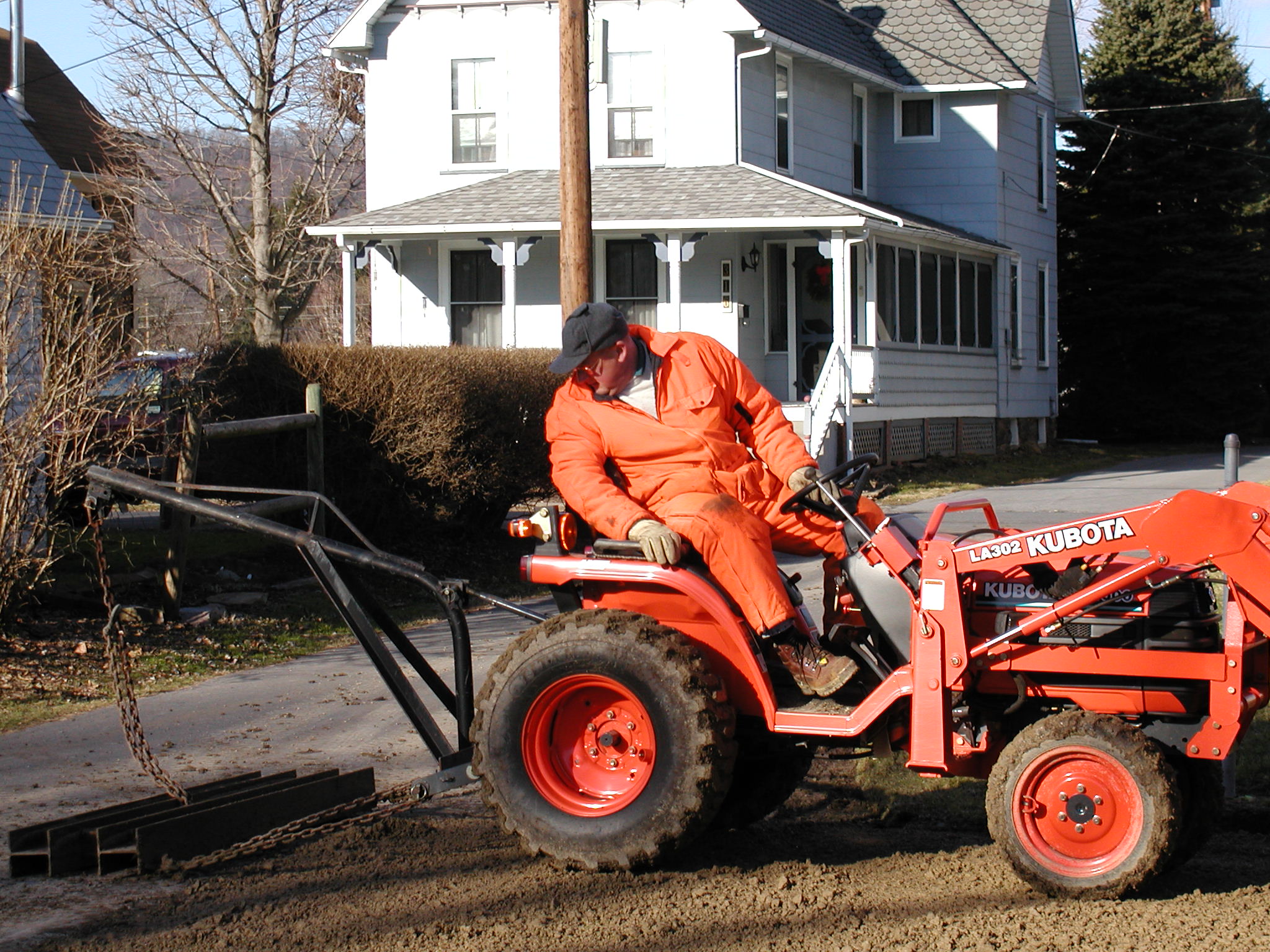

First pic is the boom pole I built for the old Ford. Material is 2" Sch40 steel pipe with some reinforcement. The Ford never had a loader, so the BP allowed handling heavy things. Well, as long as the front of the tractor didn't come off the ground. In this pic I was using it to lift and drag a homebrew landplane with the B7500.

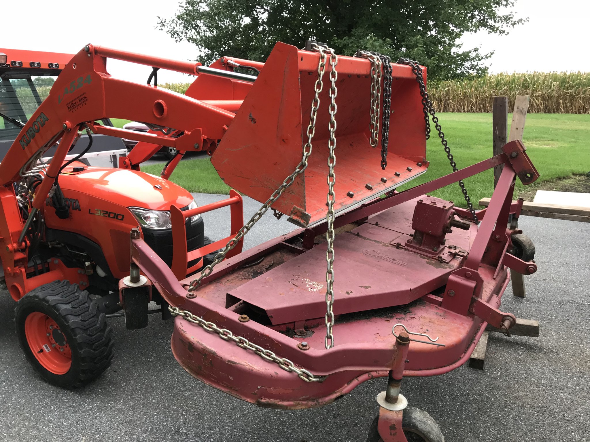

Next pic is how I put the 91" Caroni deck on sawhorses for rehab. Wasn't concerned about the paint because it was getting refurbed.

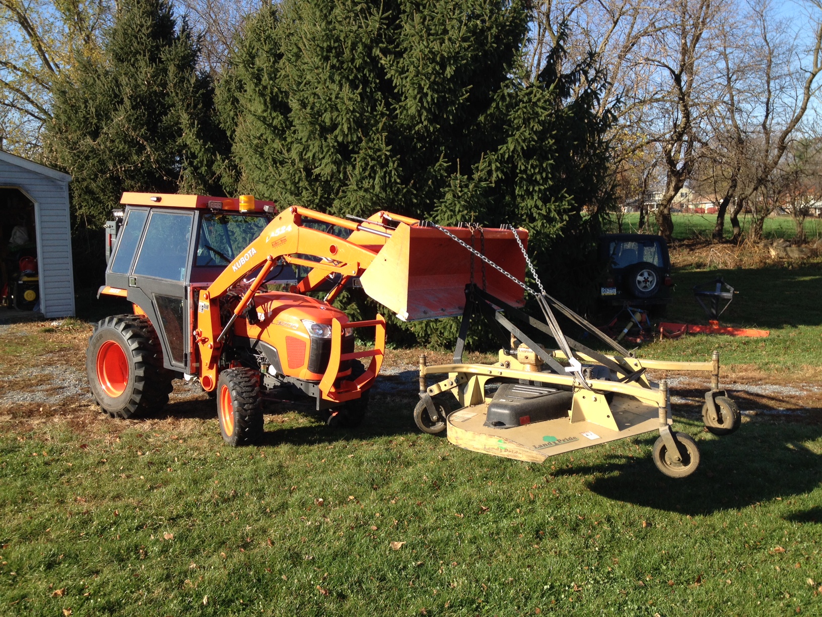

Bottom pic is how I grab mower decks it to put them on the shelf in the shed for Winter. It's a testament to the strength of the slotted angle on the top of the bucket.
