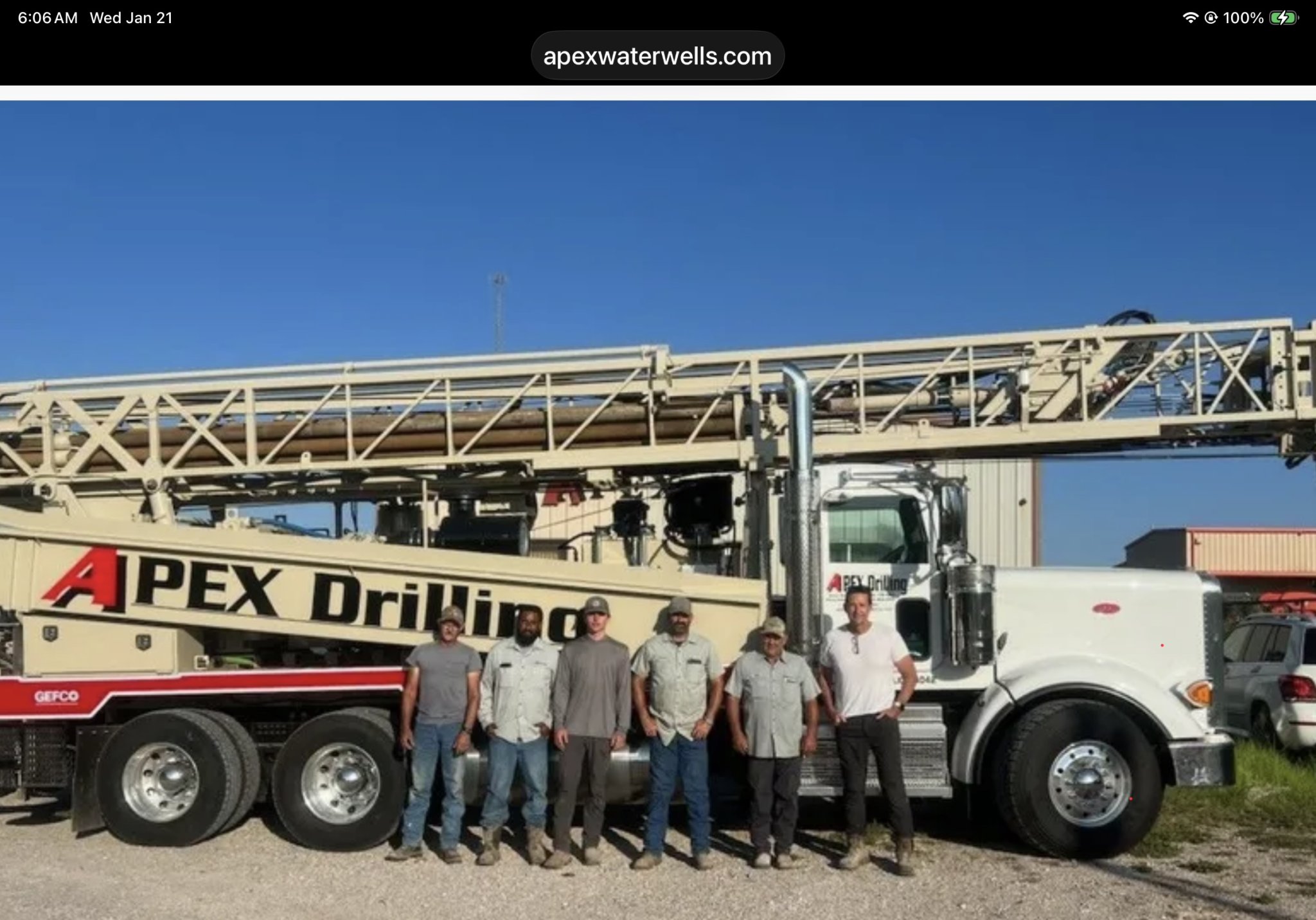

This is the local driller and the equpt used by a local family operation.
:I’ve recently watched a commercial driller on the development nearby…and their equip't wasn’t nearly as good-looking…. it was easily 40 yrs old…. when the turn-table engine blew…the truck stayed on-site for a week before a crate-engine arrived…which they replaced in the field.
The crate-engine…arrived in a 1940’s era Air Force container that looked newer than the old surplus engine.

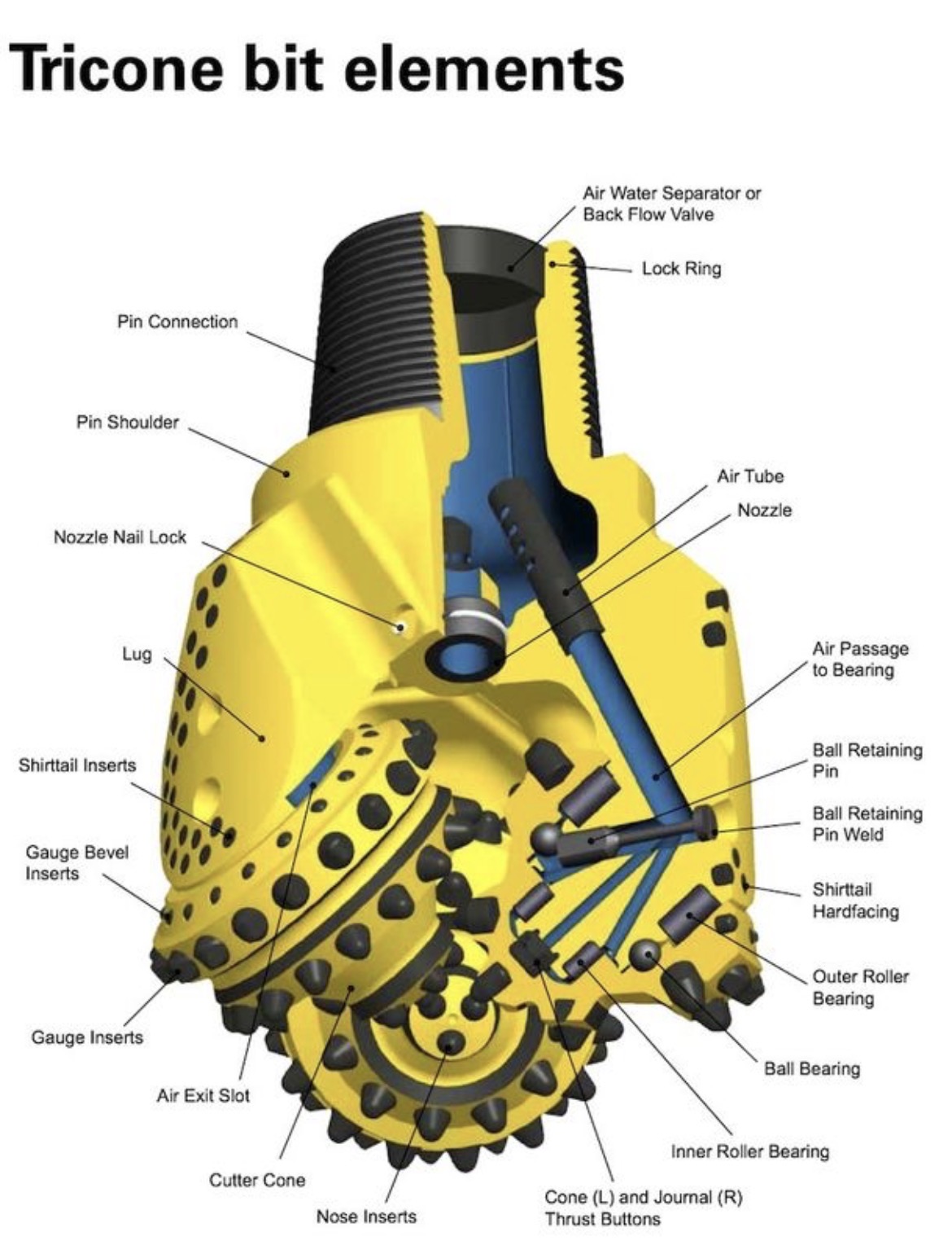

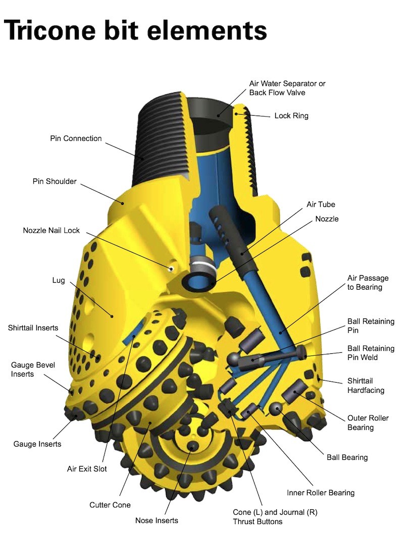

My well is about 550’. 300’ of that is through a solid granite shelf. The rig used a tri-cone roller bit.
3,839
5,156
Looks like the one in the movie
Look pricey though…………….I wonder if Vevor makes one?;)
