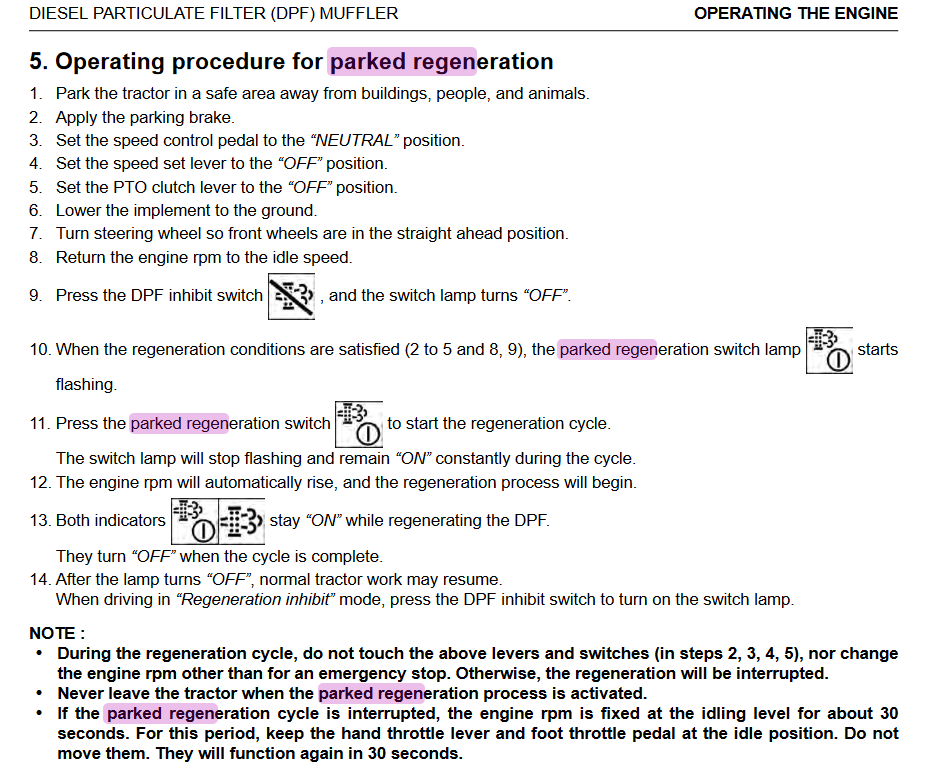

I have a 2023 Kubota LX3310. I usually have a regen around every 25 hrs and am at approximately 23. I have some work to to do on the tractor and would like to avoid the regen during this time. I tried doing regen in park and although the button lit up, it did not initiate. I know I can cancel it if it should automatically go into regen, but I prefer not to. Does anyone know if a regeneration can be initiated before it t does automatically? Really starting to miss my 2003 B7800 - no emissions!
could this be what you were looking for and did you happen to try these steps exactly?
6,590
8,767
Of course, the issue is what if you have 15 seconds left of work to do when the light comes on ...
Press the regeneration inhibit button then shut off the tractor if you don't want to do the regen at that time. The next time you start the tractor it will be in auto regeneration mode but at PM warning level 2-1, so you follow the same procedure for PM warning level 1 or parked regeneration.
