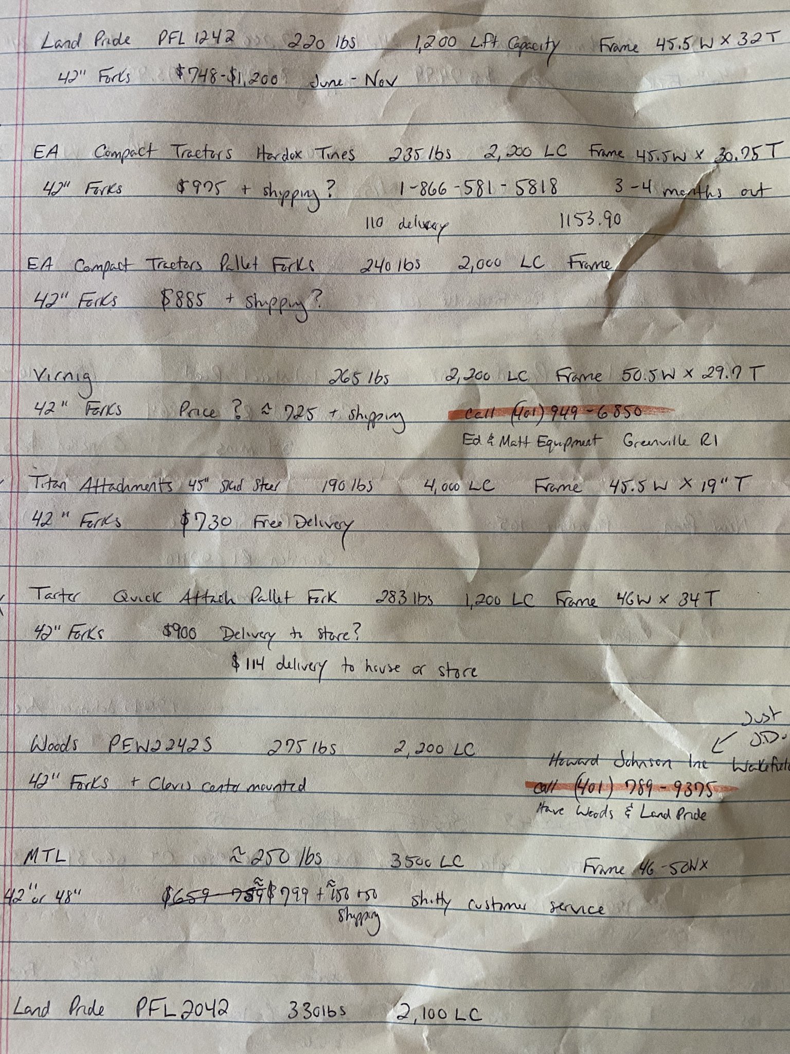

According to EA, the smaller forged forks (2000lb range) which are what subcompact and compact tractors need are unavailable most of the time. Which is why they started making welded hardox fork blades that have the light weight and 2000lb capacity.
That's probably why the prices are insane from the dealer for the smaller forged forks now also. Make sure you ask what the lead time is for any of them, including the dealer's forged forks, before ordering if you need them any time soon.
You might find 4000lb+ forks, but the frame and forks can weigh 100-200lbs more which just kills your lift capacity on a small tractor. If you are going to have to pay inflated prices one way or another might as well get the best choice for weight.

I went a lil crazy in my search when i couldnt find my original choice around here, the LP PFL1242. I wanted the frame in the back while being light weight and having adjustable forks. I ended up going with the EA compact forks with the hardox tines. The pic demonstrates my craziness and the zero availability around me.
