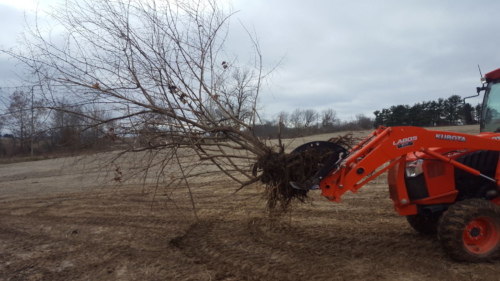

for picking up logs I added a 3rd fork tine. It’s spaced slightly off center so I can still pick up pallets with either 2. Helps to keep logs from falling in between the tines as I’m grabbing from a pile. It will move brush ok, likely not as slick as a dedicated grapple like others have. This one will come off with a couple bolts and a bit of grunting if you have something tall to pick up, as the arm does not raise straight vertical.

I wold not substitute my grapple for what I do. I also think you are underestimating what your tractor can do. I have cautiously refrained from pushing my tractor, but the more I use it, the more capable I find it. The last time I used my grapple, I pushed two trees over. I found if you can push it over, you can get it out of the ground....at least with those two. You might have to work it back and forth to get it up though. In the future, if I can push it over with my grapple and it is an actual tree and not shallow brush like privet, I will then cut it about 3 or 4 feet from the ground, remove that and then push it side to side and pop it out with the grapple if I can.

Just to follow up on this, I ended up going with a EA Wicked 55 grapple. Haven't got to the land clearing yet, but it proved useful on multiple occasions for cleanup after storms.
