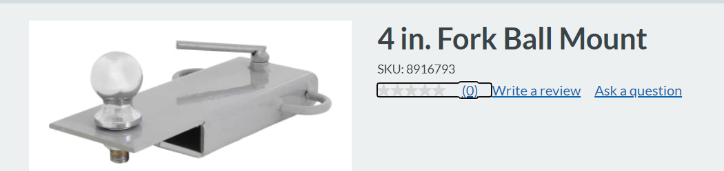

I use one of these and have used it for moving trailers around. I have moved my 8K travel trailer with it on flat gravel surface. I use a short section of 3/8" chain with hooks on both ends that also uses old fire hose to protect the paint on my fork frame. I would not trust the eye bolts alone to stop the hitch from sliding off of the forks.

Step away from the drill bits fellas...........I bought one of these y'day. Unfortunately it came with a 2" ball but my utility trailer takes a 1-7/8" ball, so I had to buy that part separate.
For all that I am doing it'll be fine. Last year, I used a 2' long angle iron "bed rail" and 2 C-clamps to move my trailer around. A little janky, but it worked.
This thing is 10-x better than that setup.

I have the same.
Works great!
