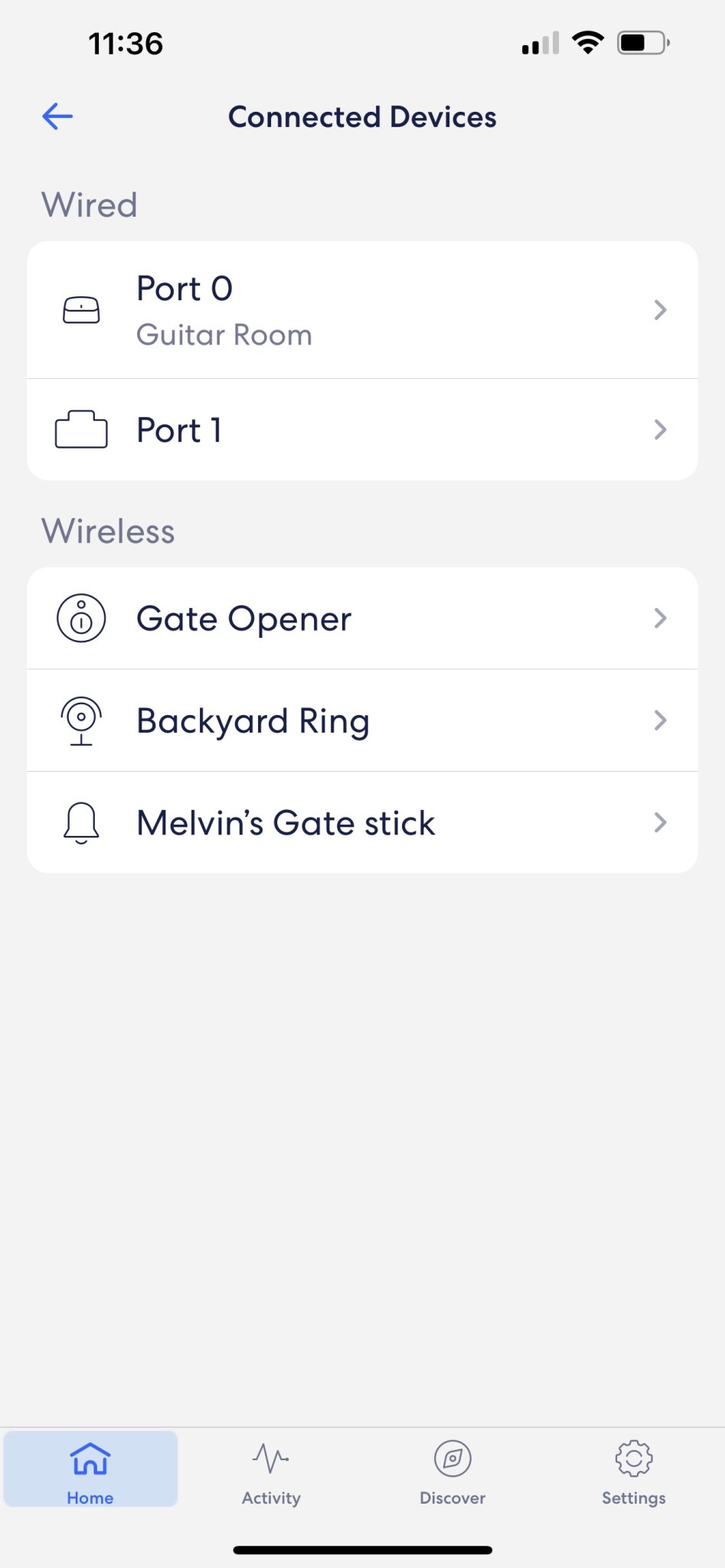

1. The EERO at the gate connected to the receiving P2P bounces from wired to wireless. In other words it will sometimes be connected to another EERO in the house and sometimes to the ethernet cable on the P2P. Why?
2. The Ring will not connect to the EERO 8 feet away. It is insisting on being connected to the EERO in the garage 700 feet away. Why? I have reset the Ring as new and it went back to the garage EERO.

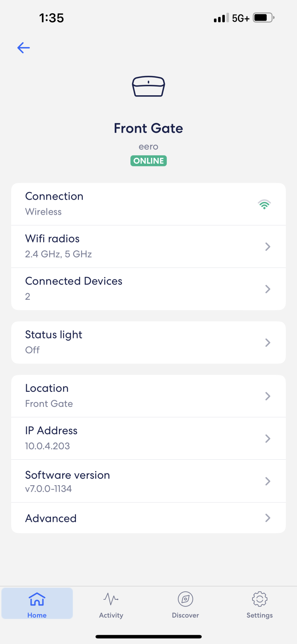

Here is what I have discovered and hope someone out there can help me. The EERO at the gate keeps going from wired to wireless. According to the manual the green LAN should be solid. Mine is randomly flashing. When I plug the eero with an ethernet cable directly to another eero, it stays wired all day long. But when I do it via the point to point, it keeps flopping from wired to wireless.
Does anyone have any idea? Could this be a bad unit? I think my return window and Amazon is about another four days, so I’m about to give up and take it down.
maybe I was wrong, but I thought the whole point of the point the point was to send a full signal strength down there and hook up another router via an ethernet cable. If it keeps switching from ethernet to wireless, I might as well just plug-in another eero down there without the P2P.

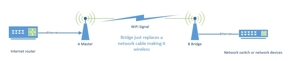

The unit at the house is set as A 'Master' ethernet port connected to internet?
Remote unit Set as B, what is connected to the ethernet cable? The random flashing should be network activity if a device is connected. If you have a switch connected to the bridge you should be able to connect a laptop by ethernet and test your connection.

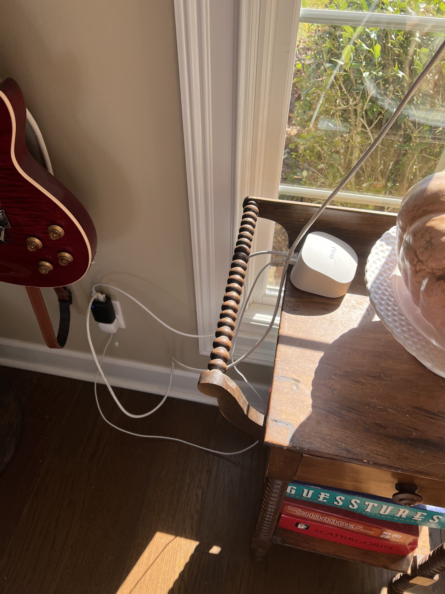

Looks like you might have 2 power supplies connected, it only needs one and a 2nd can cause problems.
1. Looks like a POE Injector, you use this if you want to power the device over the ethernet cable.
2. Looks like a power supply plugged directly into the device.
I would remove the POE injector and just run off the power supply.

The POE is only going to the P2P unit. Only one side of the switch is POE and that is running to the A/Master unit. The other power you see is for the white EERO router in the photo.
Its a head scratcher for sure...
