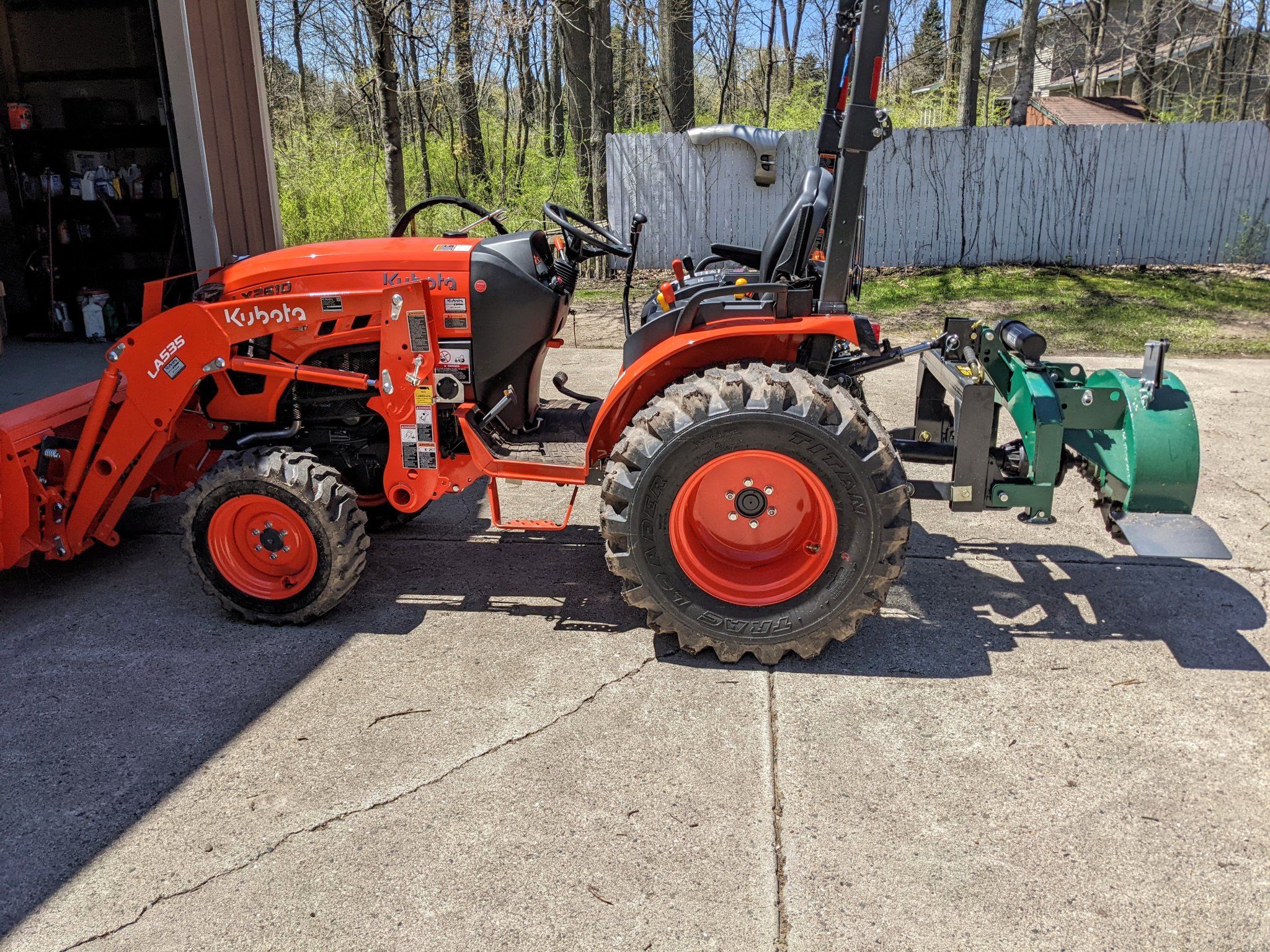

I have the larger 15-19.5 R4 tires on my LX 2610HSD. I am in Mid-Michigan and have the tires loaded with RimGuard (Beet juice). The bigger tires hold about 300 pounds more Beet juice than the standard ones.
It is right at 60" wide I do not have spacers as my land is mostly flat. The tractor with a 60" bucket on the loader a quick hitch and big box (Tarter 206) back blade weights 3,555 on my scales from the race car.
I seldom get more than 6-8" of snow anymore and plow my 300' paved drive in 2WD until we have more than about 4" of snow then I need to use 4WD.
I don't have a backhoe because the 2 times in the last 10 years I have either rented a trencher or just hired it done.
It really depends on how much you need to use it. I have a Woodland Mills stump grinder for the stumps. It takes much less room store and is about 1/3 the price. Just a thought to pass on. If your planning on a lot of digging then the backhoe might be the hot ticket for you. But if your using it for trees and stumps a grapple & stump grinder are better in my opinion.
The attached photo is mine with the stump grinder hooked up.
