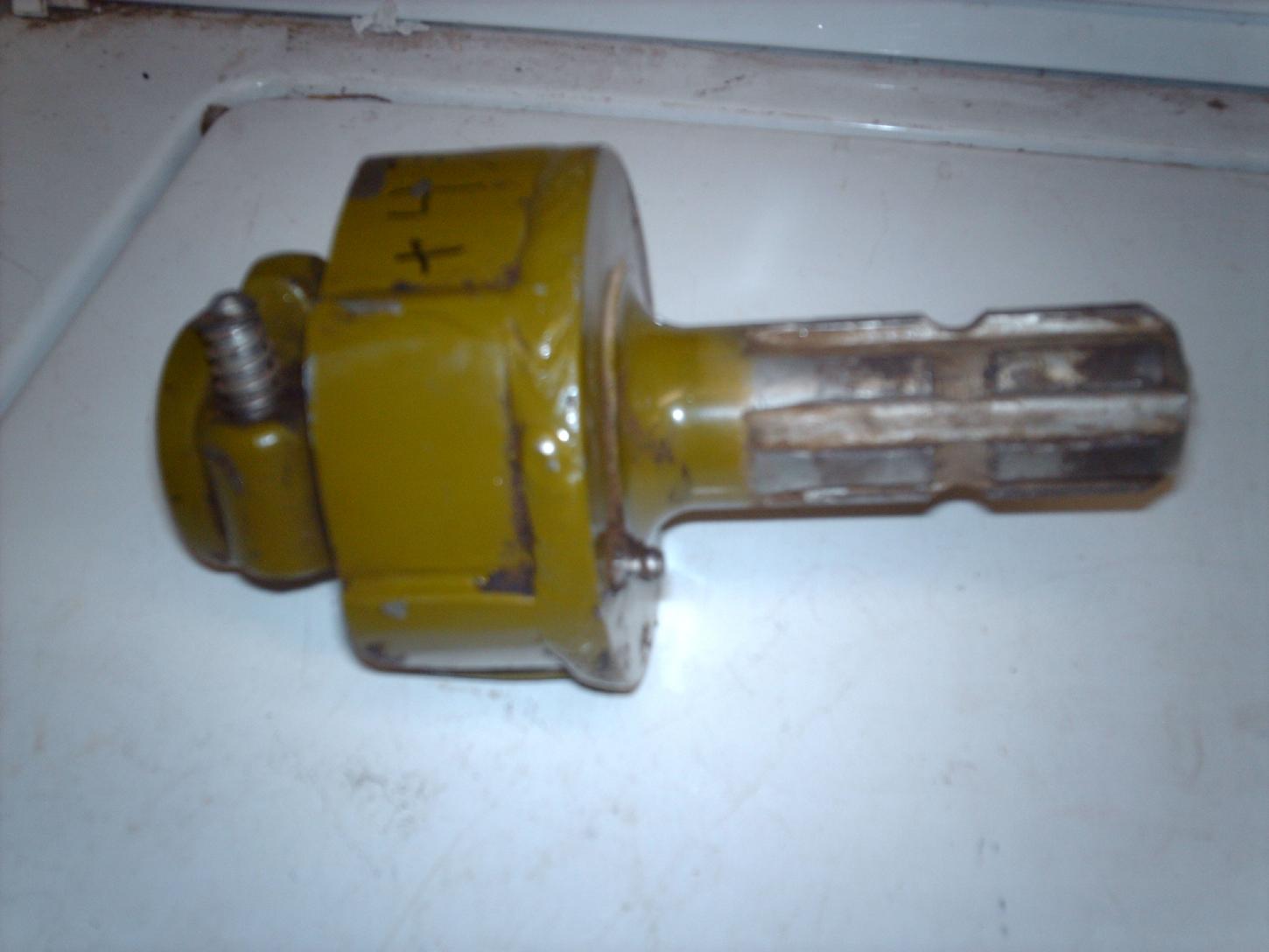

I have one of my B7100's that does not have an overrunning clutch built into the pto. I would have to check the serial number to be sure but if I remember correctly it is a 1977 or 1978. My other 2 had the overrunning clutch built in. The tractor without the overrunning clutch also has the short pto like you refer to. I bought my external overrunning clutch from Hoye Tractor (the yanmar dealer).

I always wondered if I would have trouble with the short pto stub sticking out of the tractor. Being shorter than others it obviously does not give as much support as the standard length ones. I used that tractor as my principal mowing tractor for a few years without any trouble running the rear finish mower through the external over running clutch. Nothing special about the design of the over running clutch I bought. I had read that the one Hoye sold was a quality one so that is what I purchased. I can take a picture of it if you want. For the past 4 or 5 years I keep my backhoe on that tractor with a hydraulic pump mounted to the pto. That does not require the over running clutch. I use another B7100 with a internal over running clutch for mowing. This year it will be my B2410 that takes over the mowing.
That would be great, or if there are any markings on it to help identify what the ORC is. I will most likely have to order one. I just don't want to purchase the wrong one online and have to return it.

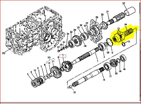

I would like to unearth this thread again to ask if i can buy a second hand slip clutch off another Bseries tractor like the B7100 and install it in a B7001?
Or it is easier to buy an external slip clutch to attach it to the PTO shaft ? (mine is the short version) but it would require me to shorten all PTO shafts i have for my implements.

None of the b7100's have a slip clutch, but some do have a overrunning clutch / one way clutch, there is a big difference in the two.
A slip clutch is a clutch pack, that will slip under too heavy of a load.
A overrunning / one way clutch allows the PTO shaft to free spin in one direction and connect in the other.
Adding one to another model Internally is going to be raather difficult is not imposible.
Stick with adding an over running or slip clutch on the outside.
