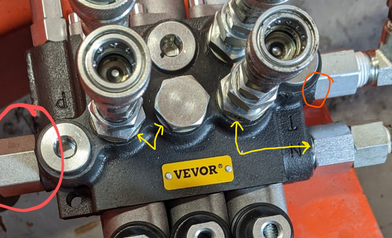

It's this guy. The leak happend beteen the orb fitting and the valve block (so not where the teflon is)
Are you guys suggesting I should try replacing the fitting and also the o-ring?
One strange thing: it happens only when pushing the valve one way, but not the other. I get no leaks when retracting the cylinder even when at then end. But when extending the cylinder, I get the leak, and the cylinder extends very slowly (obviously). Why would I get this problem only in one direction?
Are you sure you have the correct fitting for that port? What makes you think its ORB? If properly tightened i cant imagine the oring being able to escape.
In any event sounds like you need to check the work circuit. Slow extension sounds like something is blocked.

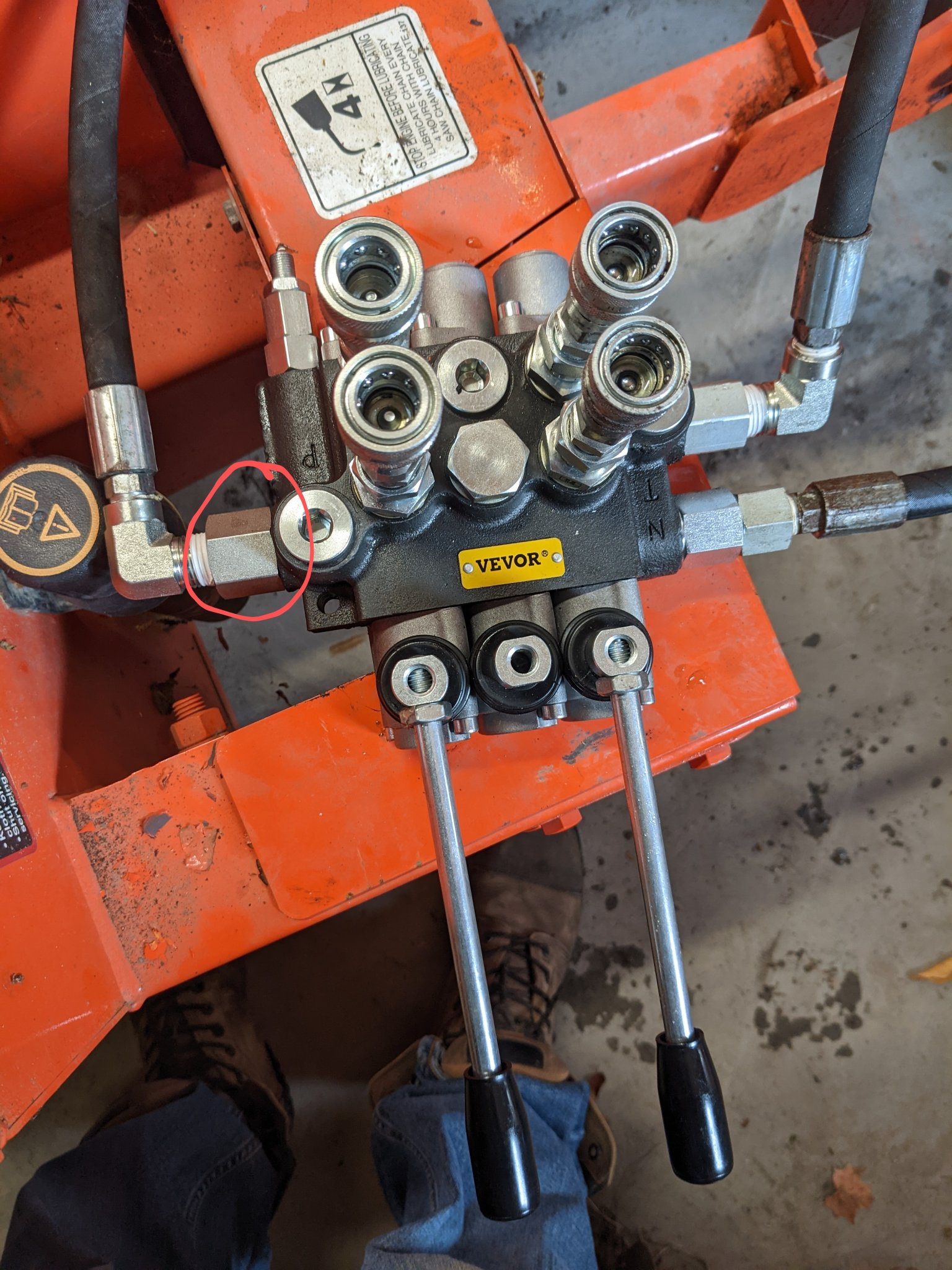

OK - please slow down. I only did a quick survey but every VEVOR valve I found for sale online has BSPP (G thread) ports. Before buying anything lets get the ports identified.
Also that valve and plumbing looks brand new. Has it ever actually been used? In other words is this the initial hookup?

I agree with Dan. This does not look like ORB fittings. If BSPP thread it usually takes a sealing washer or seal in the face of the fitting. Remove and take pics of the fitting and port.
The picture is old. It's from when I initially bought it. Everything is the same now, but with oil and diry all over it.

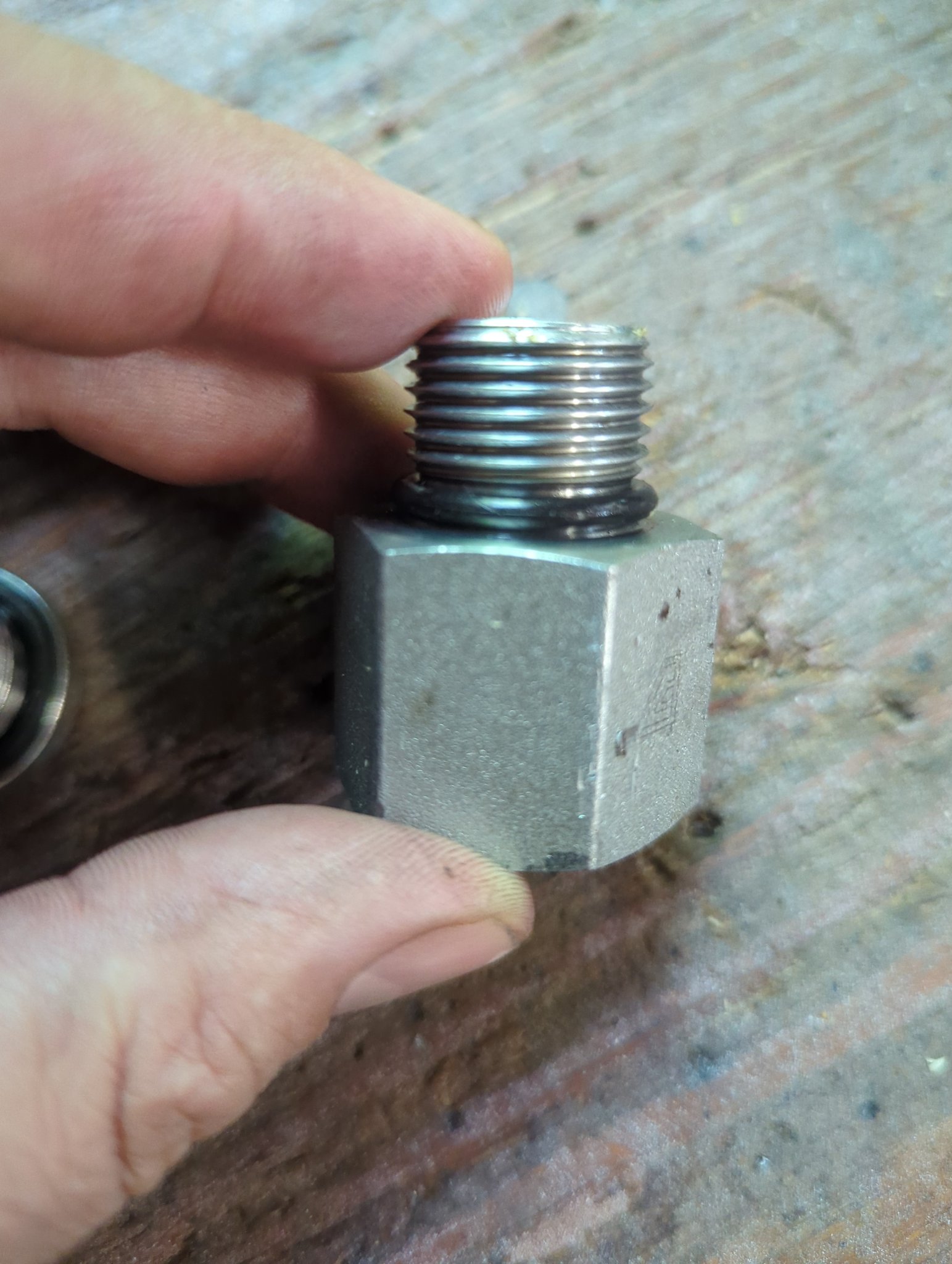

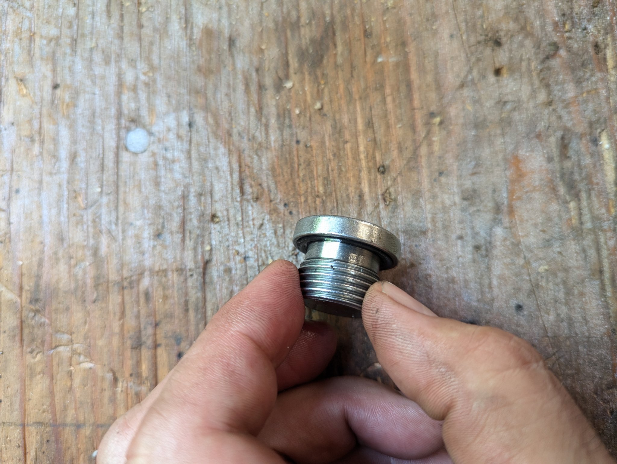

I took a picture of the plug that can with the valve and it looks like the rubber is inside the head. Never seem that before. So yeah, not ORB it seems.

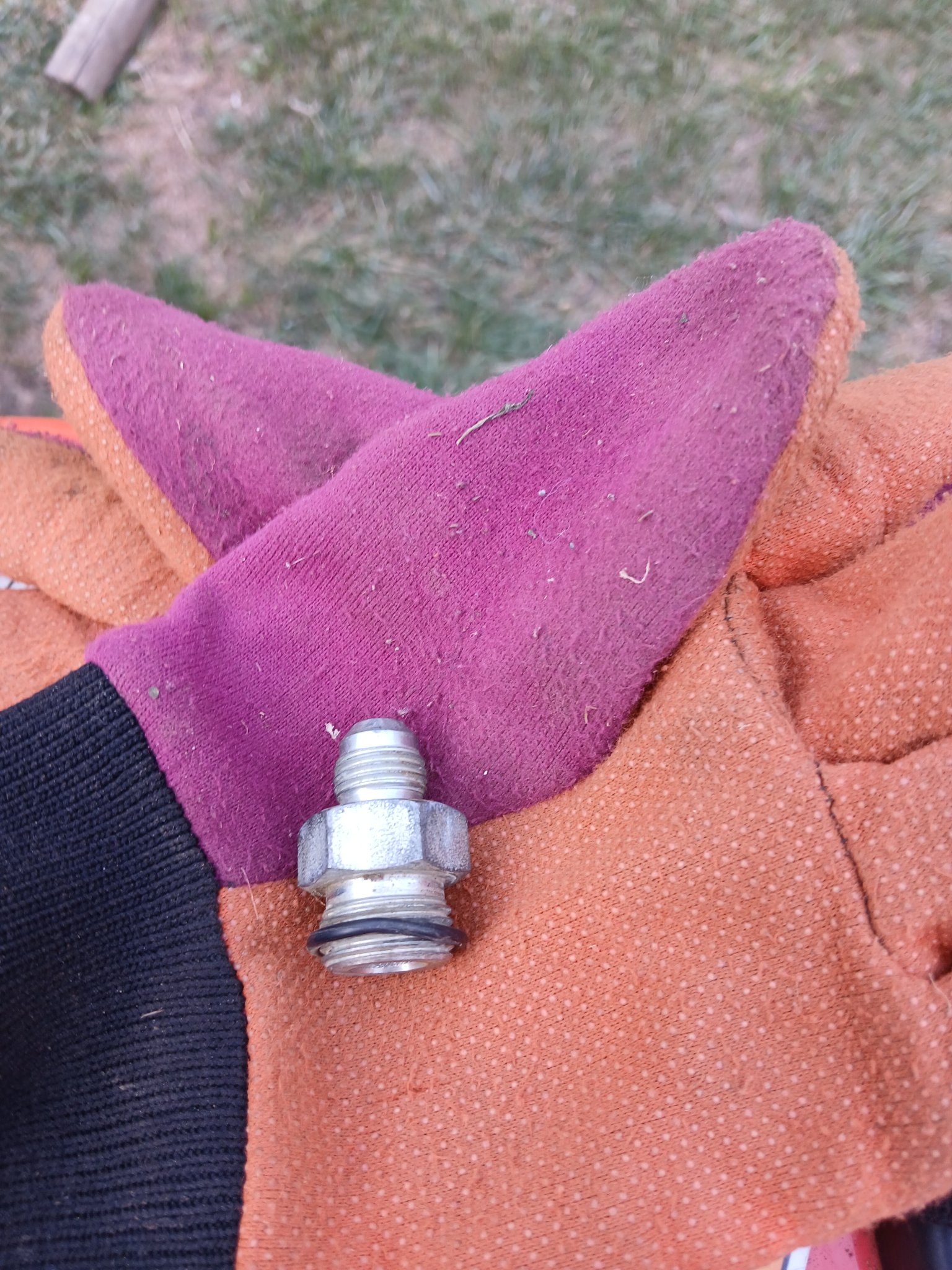

And this is what I am using on "P"
I took a picture of the plug that can with the valve and it looks like the rubber is inside the head. Never seem that before. So yeah, not ORB it seems. View attachment 135950
I think we have found your problem.
It appears the ports are BSPP not ORB. Not only the wrong o-ring but also the wrong thread pitch, diameter, and flank angle.
Not sure why your cylinder moves slow but you need to correct the fittings. While you are at it I suggest you eliminate as many of those rigid connections as possible and substitute female swivels for the hose connections.
Use BSPP to male JIC adaoters in P and T ports.
Use BSPP to male NPT in cylinder ports.
The female pirt on the Power Beyond adapter may well be ORB but you need to double check.
If you want help with the specifics let me know.

You can use the fittings you have you just need sealing washers at the 2 fittings circled like pointed out with the yellow arrows. These are generally coated steel or aluminum.
10,887
5,979
He cannot use rhe fittings he has - the threads do not match. He has SAE oring boss fittings and the ports are BSPP. Hopefully he has not damaged the threads in the ports.

I am suspecting they may not be MORB fittings. -6 MORB major thread diameter is .562 and 3/8 BSPP is .656
-8 MORB is 3/4x16 so no way an ORB fitting will work in a BSPP port
