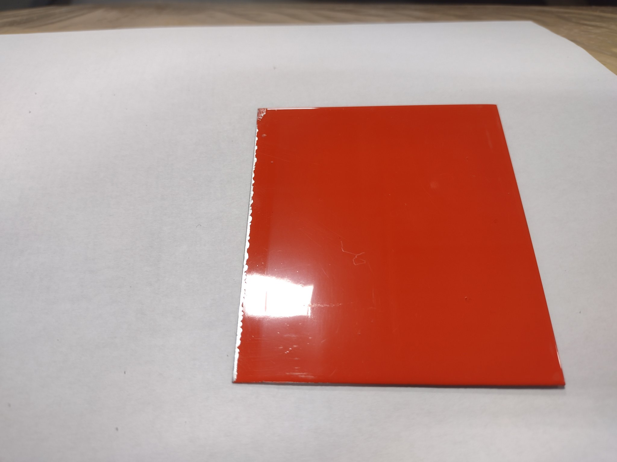

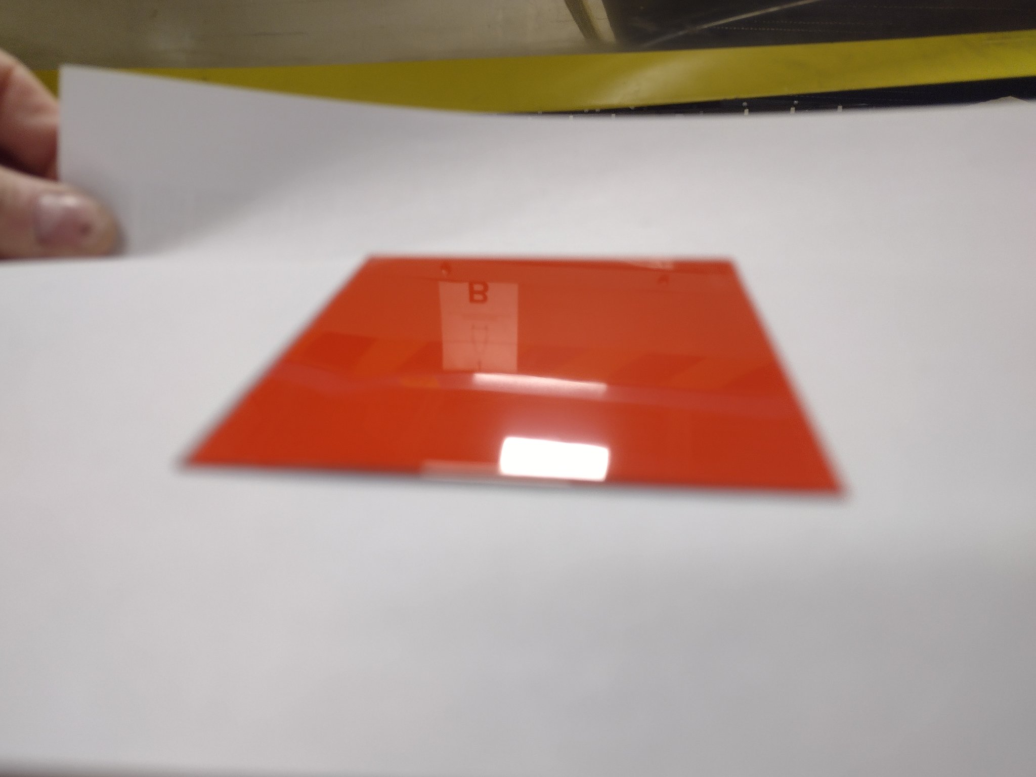

Like many of us here my tractor suffers from factory paint (orange 2) that was fading right off the dealer's lot. I run a buffer across everything yearly, just to freshen it up, but at some point I will run out of paint and it will need to be repainted. I wanted to test the fade resistance of Kubota bulk paint (quart/gallon) to see if it was any better than what was applied in the factory.
I sprayed 3 coats to a coupon, The only deviation I had was the addition of hardener and a smidge of reducer to get it to a viscosity I liked.
I have access to a lab with a weatherometer, otherwise known as an accelerated weathering test chamber. Unfortunately, my lab only uses the UV portion of the test and is not set up to test the humidity/water droplet part of the test. I may revisit this in the future with a complete test.
There is not an iron clad time frame of UV I exposed the coupon to due to location and latitude differences, but its roughly the equivalent of 2 years.
Overall I would give it a 9/10. There was a small amount of fade that I tried to capture on the outer edge that was covered during the test, but overall still had great reflectivity.

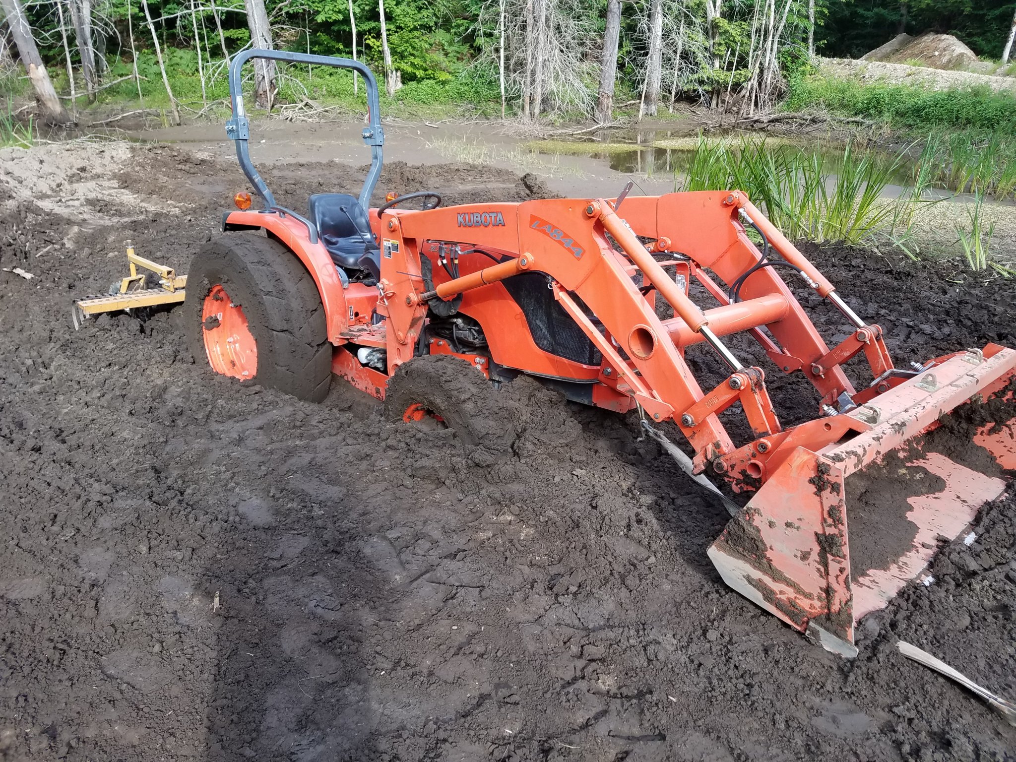

When I'm not waxing and detailing my tractor in a carpeted, climate controlled garage, I use it outside. Just last week I brought a bucket load of mulch to the edge of the paved driveway, but I didn't want to drive across the grass, way too risky. Someday I hope to brave enough to put it in 4wd and scratch the paint off the bucket.

When I'm not waxing and detailing my tractor in a carpeted, climate controlled garage, I use it outside. Just last week I brought a bucket load of mulch to the edge of the paved driveway, but I didn't want to drive across the grass, way too risky. Someday I hope to brave enough to put it in 4wd and scratch the paint off the bucket. View attachment 91231
I leveled 3 spots (32x32, 12x12 and 15x30 feet) using my LX. I had about a 1-2 foot slope on each, and the ground is hard, red Georgia clay with lots of rocks (fist to football+ size). I always tried to do the work when the ground was damp - not wet from rain.
What really surprised me was that no matter how much of the red clay was stuck to the tire treads and sidewalls, it would all nearly disappear within a couple of hours of mowing the field later in the week. My tires are clean and black, and I have never even hosed them off.
