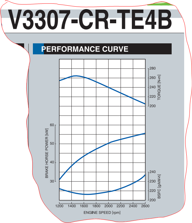

Let’s re-phrase my question. It will probably result in the same answers , but that’s ok. Is there any advantage to operating a tractor at peak torque as oppose to a specified rpm setting. And for this scenario. Let’s assume pulling loads only.
11,038
2,925
here are the torque and hp and fuel usage for your engine.
