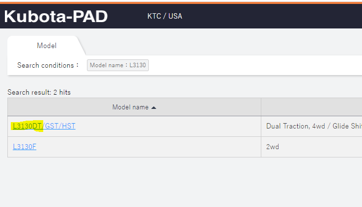

Must be a DT? 4wd 8speed manual transmission
Well I just went out and looked and the plate just says L3130D

L3130D not L3130DT is the correct model number.
