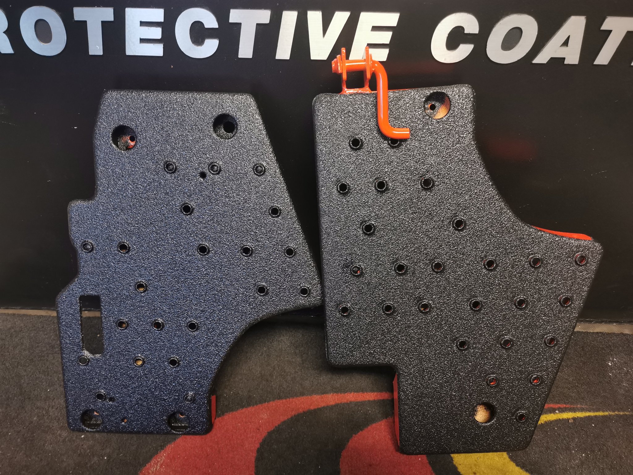

Get my new l2501 delivered next week. Had the dealer pull the plates ( just some simple linkage disassembly) and I took them to the local Line-X dealer and for $80 spray their Bedliner product on. It should provide protection for a couple years anyway.

Get my new l2501 delivered next week. Had the dealer pull the plates ( just some simple linkage disassembly) and I took them to the local Line-X dealer and for $80 spray their Bedliner product on. It should provide protection for a couple years anyway. View attachment 51603
Thank you! That looks exactly like what I want on mine. Looks great. If the floor plate isn’t a total PITA to pul on my L I hope to have it done during the off season this winter.

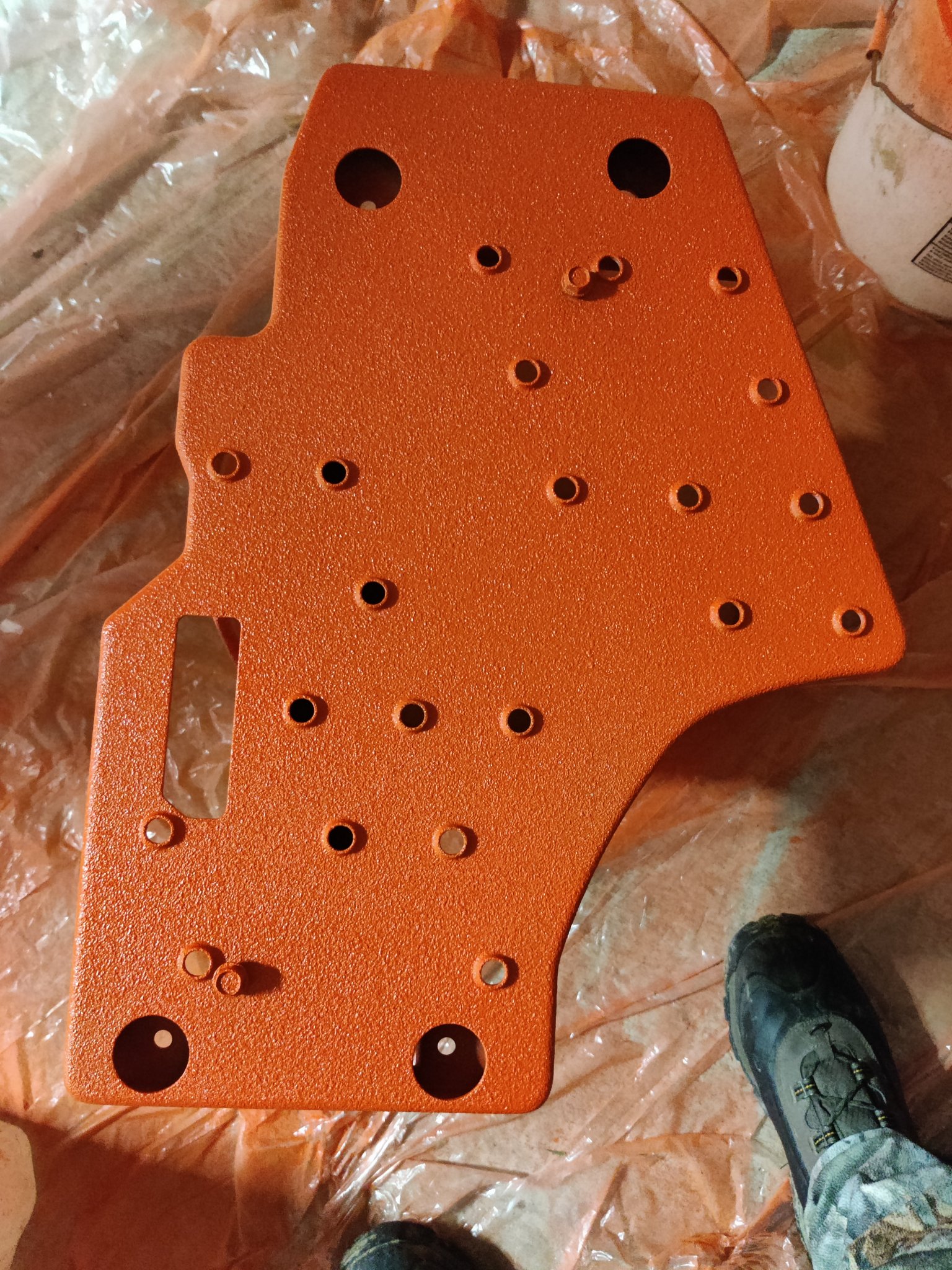

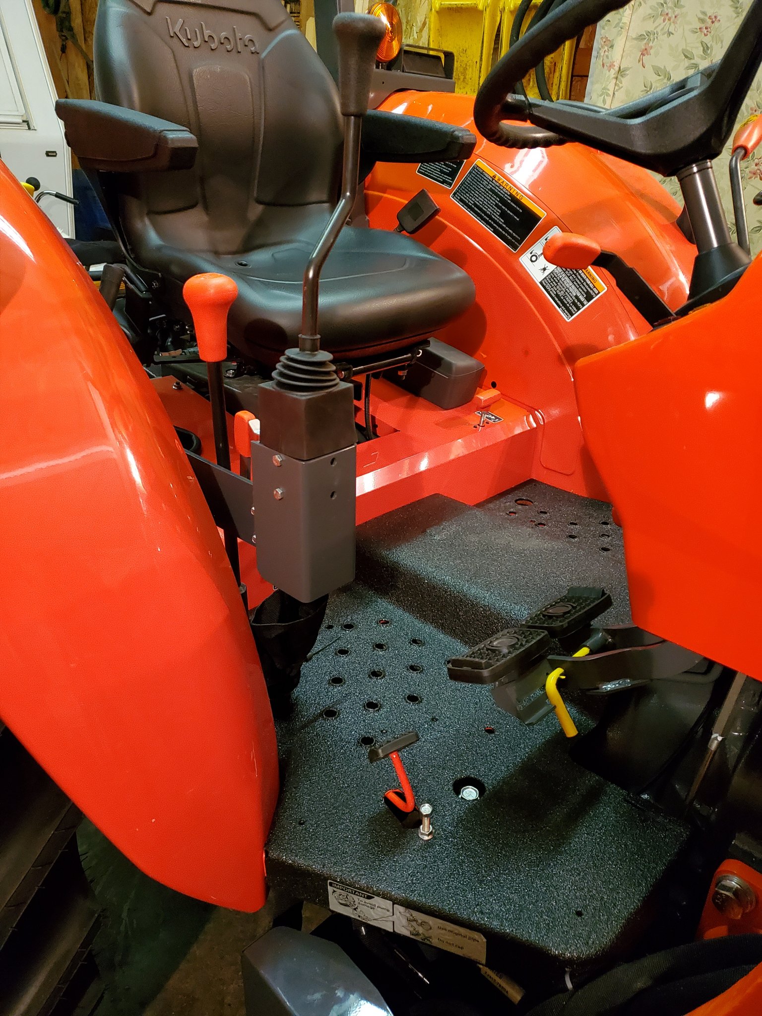

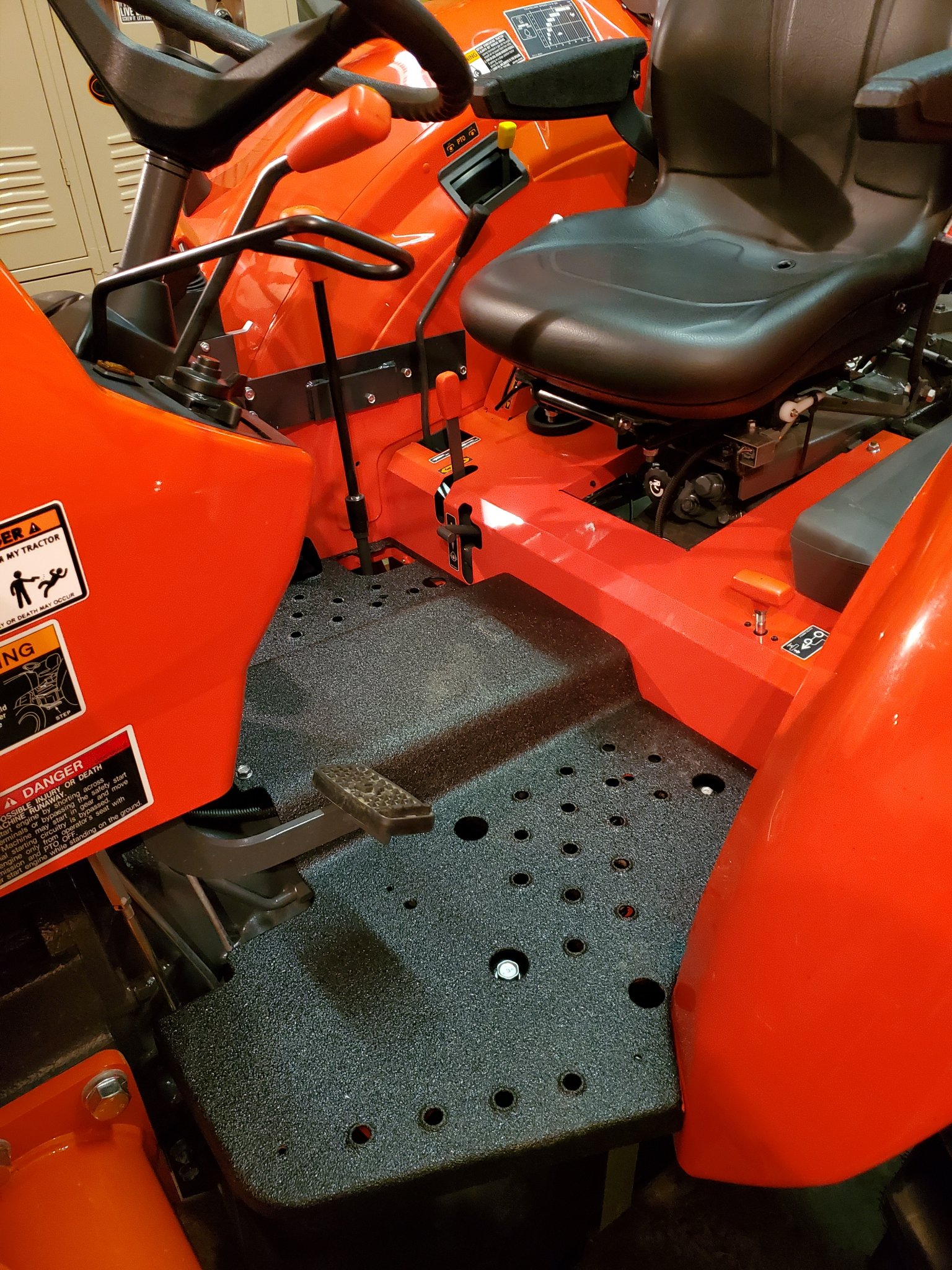

Some pics of my floor pan with the Rhino liner.
Thank you. I was hoping to see the contrast of the black on the floor before doing mine. Tinting it orange is a neat trick but I prefer the contrast of the black. Very nice upgrade.
I think Kubota should consider doing that from the factory and if not, their dealers should consider offering it as a dealer added option.

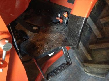

Try the Herculiner. A quart from Lowes will do it. I think it is about $25 a quart of $55 a gallon. Line-X wanted $350 if I brought my panels in to them. The photo was at 50 hours. I have 600 hours on it now and it looks the same. Our dirt here is mostly sand so it eats everything up fast and mud/sand has not hurt the liner at all.
I was considering a DIY product but I was concerned that it would look like crap when I was finished. Yours looks pretty decent! Good job! How did you get the crisp edges on the fender, etc.?

I've used a couple gallons of the Herculiner from Lowes on other projects and it's all in the prep work. Getting the metal as clean as possible after scuffing it seems to make the difference.
I used masking tape to get the clean edges. I pulled it off before it was completely dry. My boots were marking up the fenders of I put the herculiner on it also.
