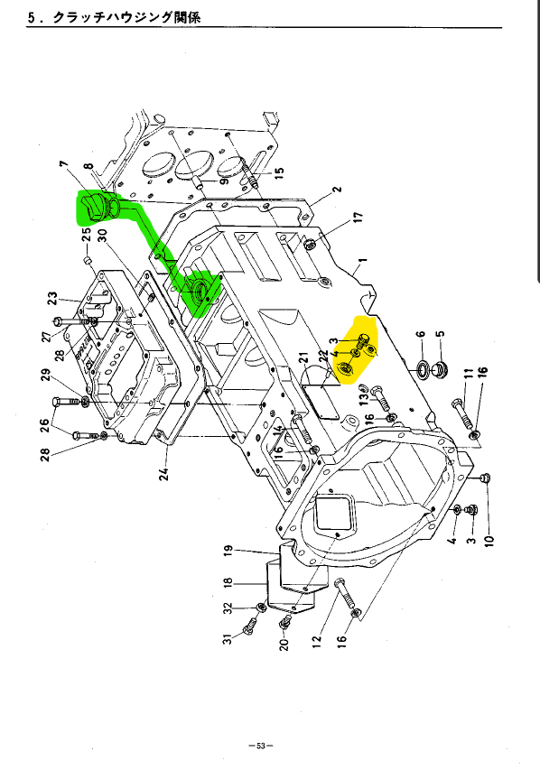

Hi does anyone have a free operation manual for a L1501DT? I've looked online but can't find one anywhere as it's listed as a grey market tractor here in Australia? I bought an old one and need to refill the hydraulic fluid as it's been leaking out from the ram arms but I have no idea of where to refill it and how much to put in as it doesn't seem to have a dipstick or sight glass anywhere?
Sorry for the ignorance but any suggestions or advice would be greatly appreciated. Cheers

Send an email to RussellKing at Austin dot rr dot com
I can send you the owners manual for a L185 that is similar to your tractor.
The hydraulic fluid is put into an opening on top of the transmission right in front of the seat (between seat and gear shift levers).
There should be a plug that looks like a bolt head with a washer under it on the clutch side of the transmission. It is about where your foot will be when starting to press the clutch down. Rem that plug and add oil until it starts to run out that hole (and dribble down the side of the transmission making a mess). Install the plug and it is filled correctly. Put cap on fill and you are done.
33,466
8,745
There isn't a ops manual for a L1501 that I know of.
Use a WSM for a L175 or L185 that will help.
You can get that off Kubotabooks.com
On the L1501 there is a bolt with a sealing washer on the side of the case by the clutch pedal for level (yellow).
The cap to fill it is center in front of seat (green)

Thank you so very much. I will do that.
Appreciate the help and advice 🙏 💯
Wow thank you so much! As I was having so much trouble finding stuff off the internet.
You guys are great. Cheers 👍
