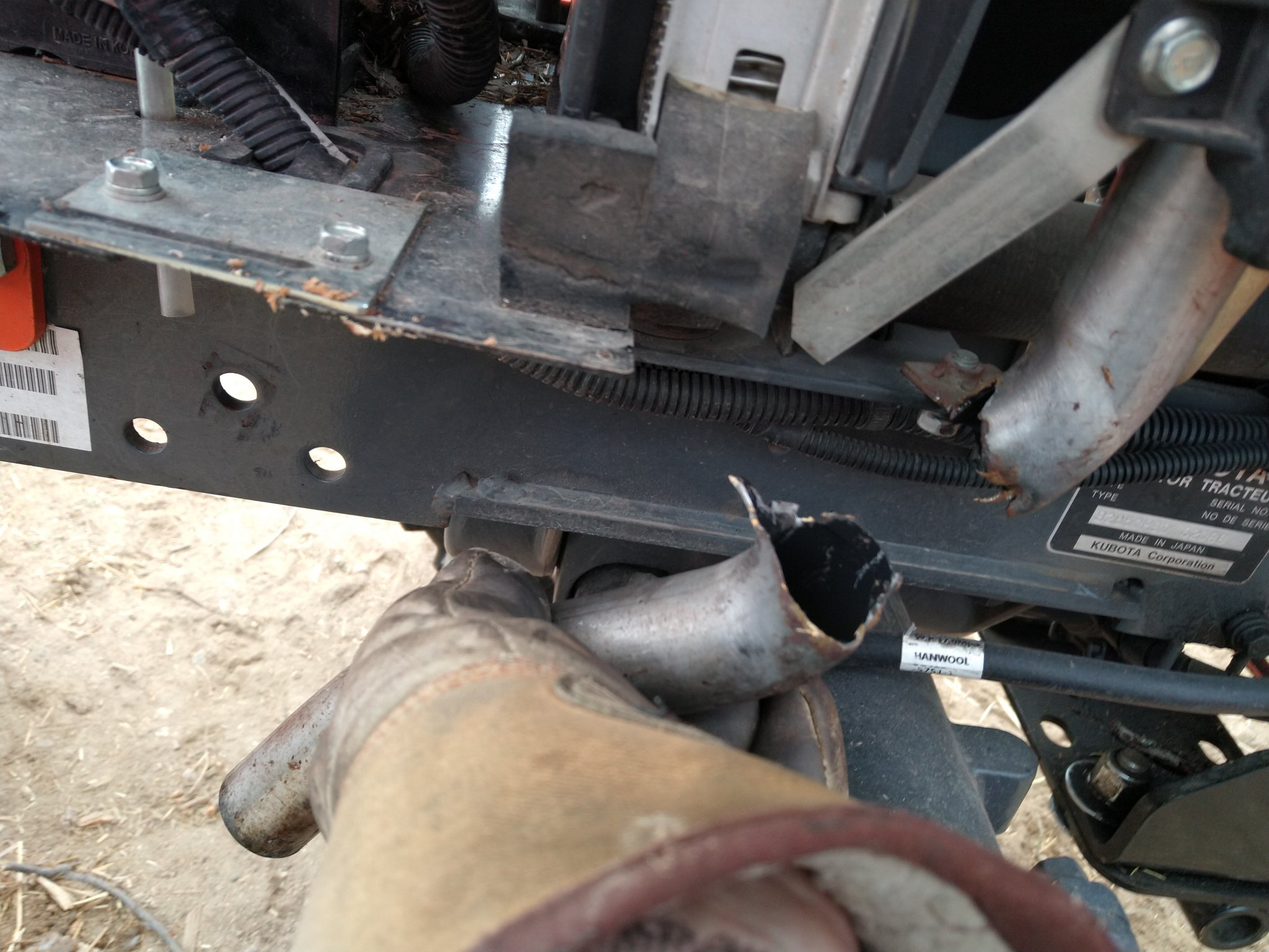

How about a thread for showing off our tractor mishaps? For pictures and/or words of the inevitable "incidents" we experience with our machines.
Mine have been minor and peripheral oops so far. The bush has laid bare a few weaknesses to attend to.
3,706
6,040
...while moving some brush a stick caught the grille guard. Since it was dead center, I left it. I think it gives the front end a bit of added "styling". :)

@nbryan I have to ask how you broke the exhaust pipe clean off.

The pipe was cracked and brazed back together almost 2 years ago. I suspect it was a sturdy branch or bush stem that cracked it then.
This time I had to replace it ($102 CAD from Kubota dealer) as a much bigger brush stub got behind it this time and finished the job. There's pretty thick bush where I'm clearing to get to a larch stand destined for firewood. LOTS of thick and tough shrubby alders, larch saplings, and willows, and they get between the front wheel and the tractor frame while I'm moving and push against the tailpipe. A small brush guard of some sort near the pipe there would help. It's hard to tell if there's something jamming in there when you're backing up and looking back, especially.

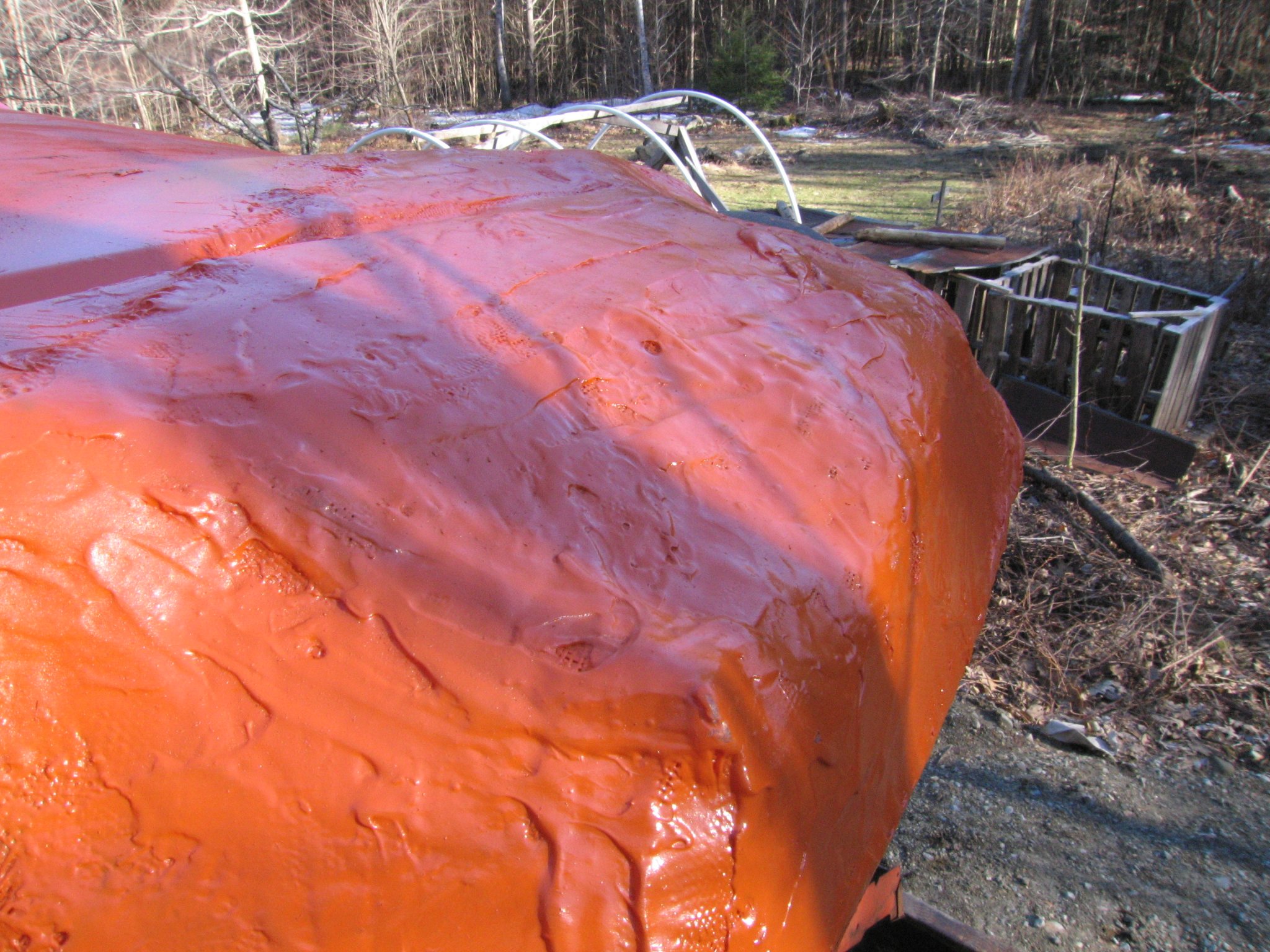

Got a new to me M6040 to replace the L4630 which I always kept in the shed behind the barn which was originally built to house my JD 450 dozer.
Well, silly me did not bother measuring the height difference between the the two tractors never mind the 450. First time backing the M into the shed I hear a crunch and see pieces of orange plastic falling to the ground...
Yep smashed a big old ragged hole in the roof, maybe 12inches by 6 inches. Yikes, winters a coming and I got a holey roof.
Used some bituthane membrane as a temp patch to get through the winter and then did a permanent fix with 2 part West epoxy and fibreglas matting. It is ugly as sin but it is still holding on after 3 winters.
I have since dug 4 inches out of the shed floor and trimmed down the rafters where the fit is close and have not had any problems since as long as I keep the snow plowed down to gravel at the front of the shed

Ouch! Well, as long as it still works!
